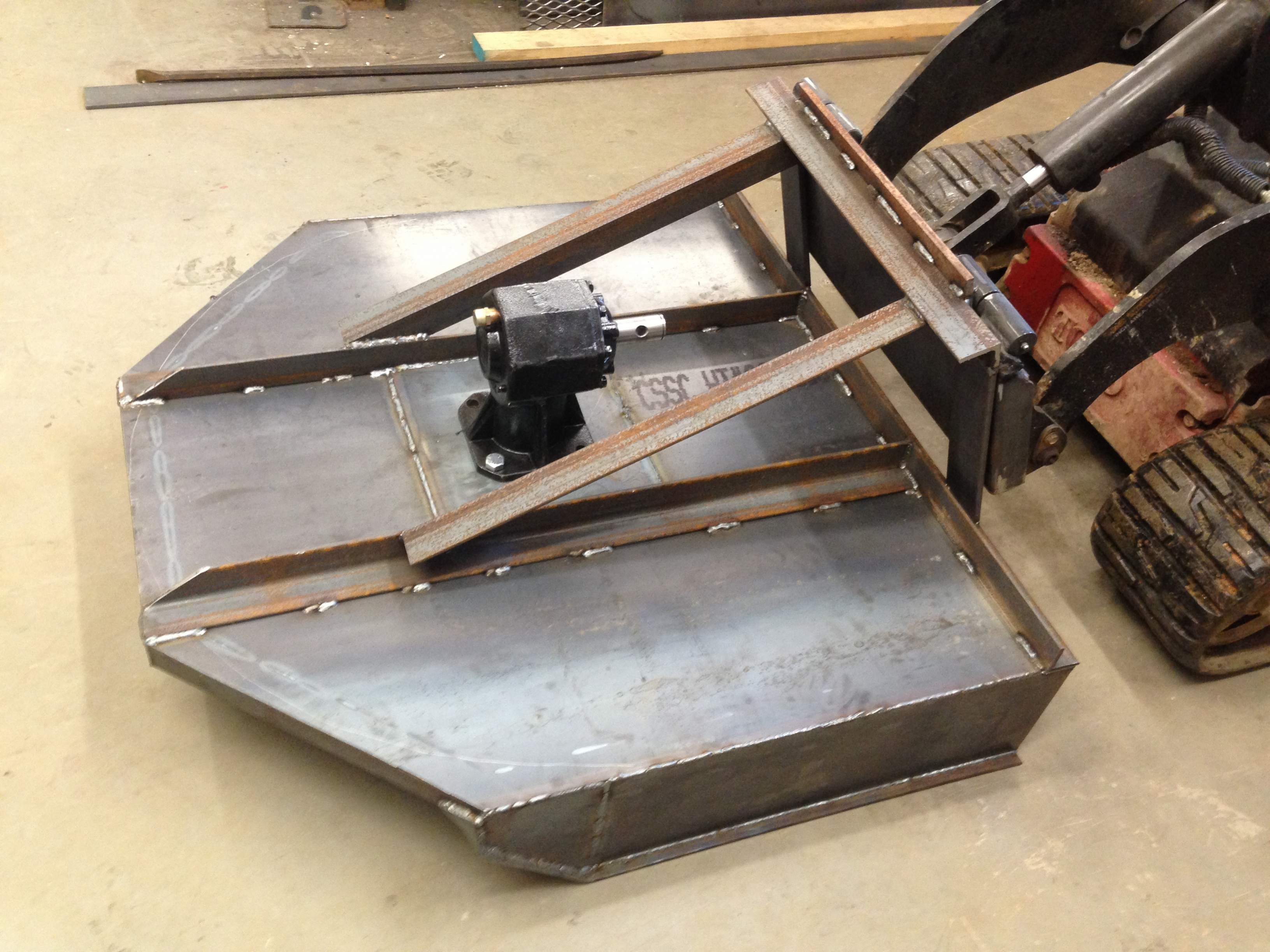

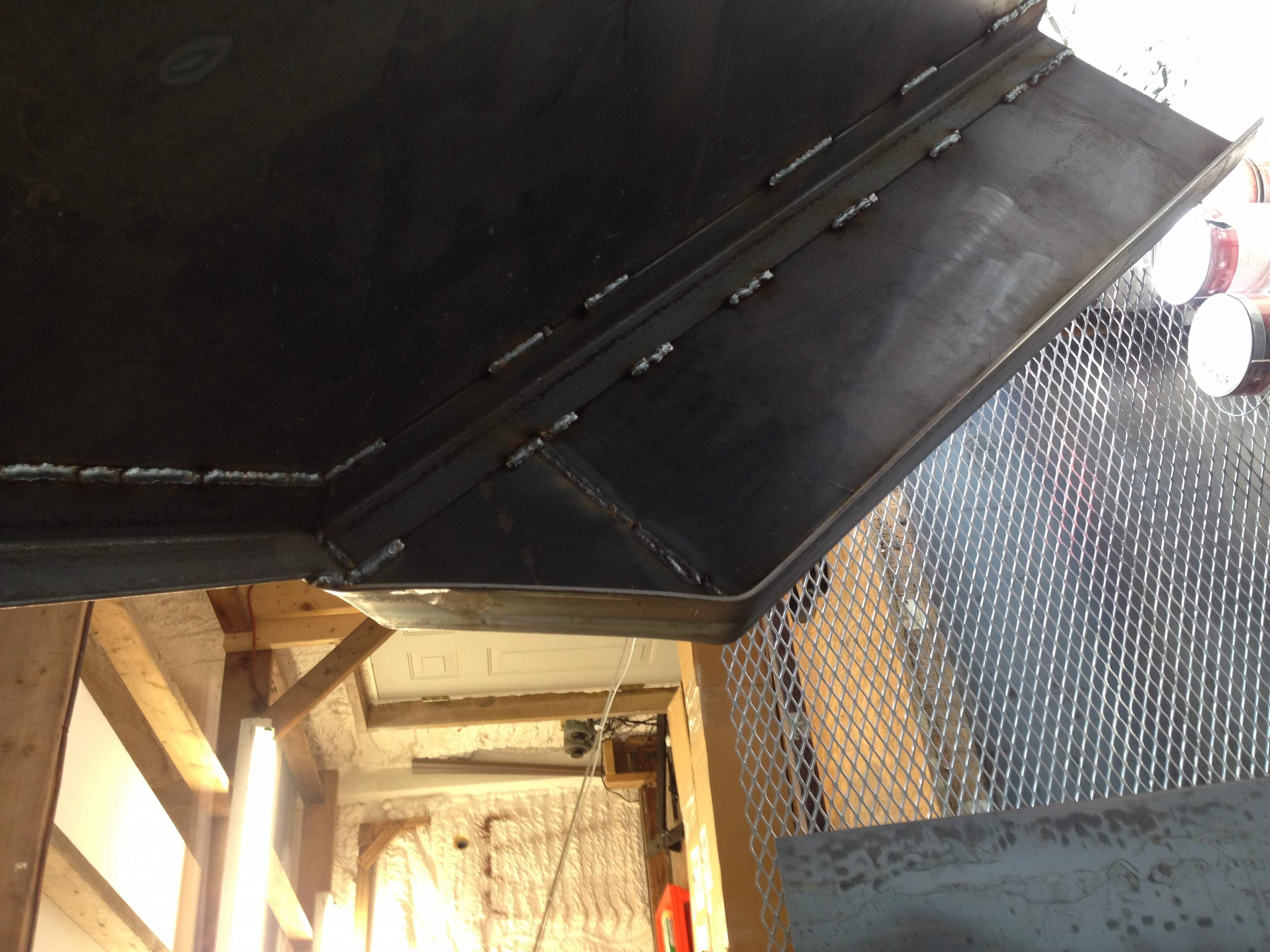

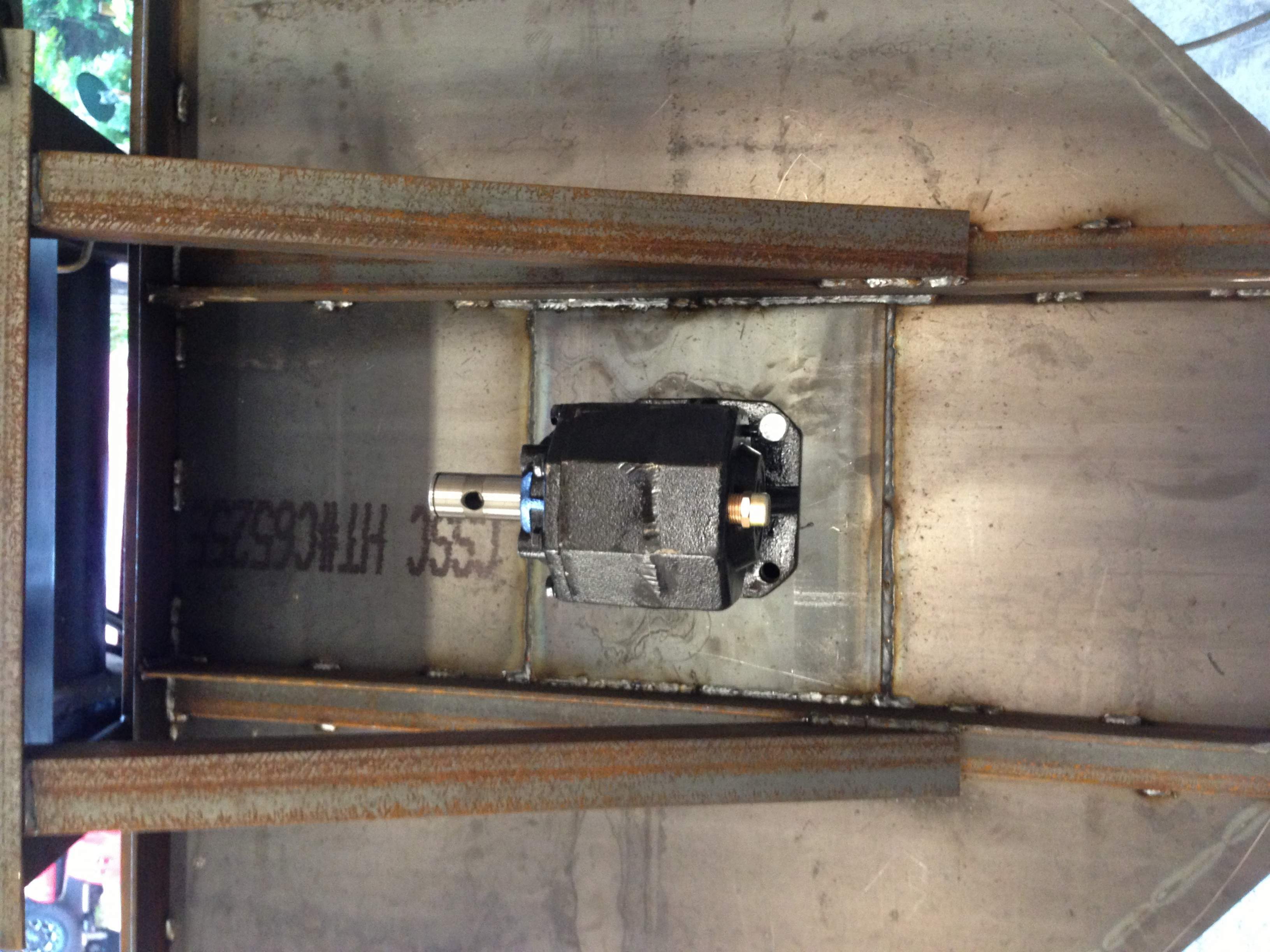

image.jpgimage.jpgimage.jpgHere are a few more pics. I got the skids welded on. I also put in the reinforced plate to mount gearbox
   / Homemade dingo brush cutter #18
Nice project! I have thought about doing that in the last, never got to actually doing it though.
Btw...
11 gpm x 231 cu in/gallon / 5.9 cu in motor= 431 rpm with no losses.
   / Homemade dingo brush cutter #19
You are only turning 446 rpm using 11.4 and 5.9 cu i motor, and 1 : 1 gear box..
Don't believe that is enough rpm as most bush hogs are 1:1 to 2.5 ratio.
Close to 1000 motor rpm would be better.
Try and get about 12,000 to 14,000 fpm
