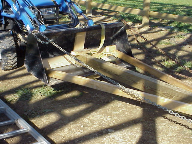

I am getting prepared to build a pole barn and have done searches on TBN for homemade FEL boom poles without much luck. I do not weld, so I am looking for pics of boom poles constructed with lumber. I plan on using it to set the trusses. I have an idea how to build it but pics of completed ones go a long way. Show me what ya got. Thanks.

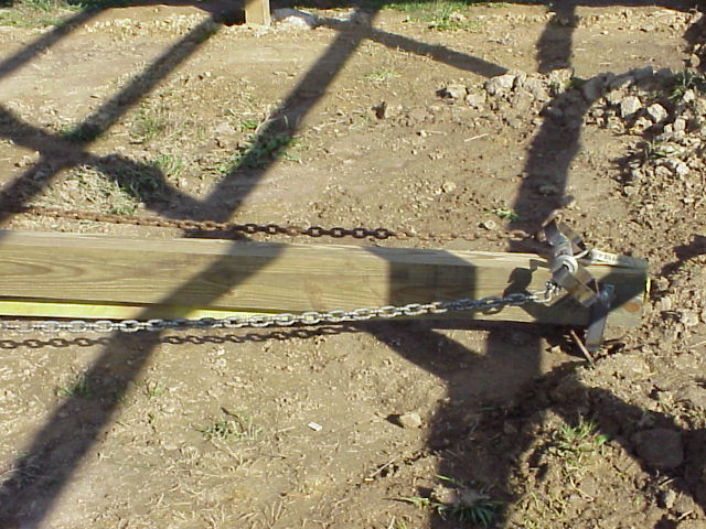

Take a look at posts #83 and #84 in this thread: http://www.tractorbynet.com/forums/projects/27976-jims-pole-barn-project-hopefully.html You can see what we rigged up to lift the trusses for my 30x48x10. It worked real well. I even changed the end of it out and made a platform to lift the shingles up to the roof - I wasn't able to be there when they delivered so they just set them in the driveway.

Jwstewar,
I can see your thread but I can't view the pics??
What happened when you clicked the links for the pictures?
On Windows computers, if you hold down the "Ctrl" key and click the picture or link, it will open in a new tab.
They opened for me.
