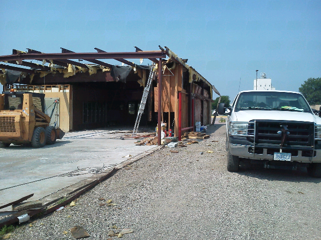

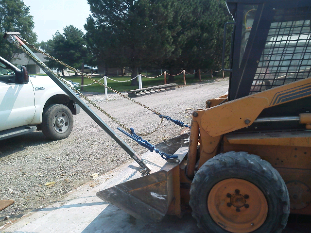

I am getting prepared to build a pole barn and have done searches on TBN for homemade FEL boom poles without much luck. I do not weld, so I am looking for pics of boom poles constructed with lumber. I plan on using it to set the trusses. I have an idea how to build it but pics of completed ones go a long way. Show me what ya got. Thanks.
I made this in a couple hours, 8' 2x2 in .120 wall tubing, a bolt on receiver hitch mount and pin. I used chain and binders, to stabilize.
Here is a pic, with a plate inserted into the end, used a s a batering ram, to pop the tin off this roof. This was torn down and moved to my home, it will be my new shop.
Dave

<img src="http://www.tractorbynet.com/forums/attachment.php?attachmentid=334514"/> <img src="http://www.tractorbynet.com/forums/attachment.php?attachmentid=334515"/>
I am on an iPad and when I open the thread the box the pics are in is blank. When I click on it nothing happens. But thanks for putting them in your post. I can see them now. Just what I was looking for. Thanks.
