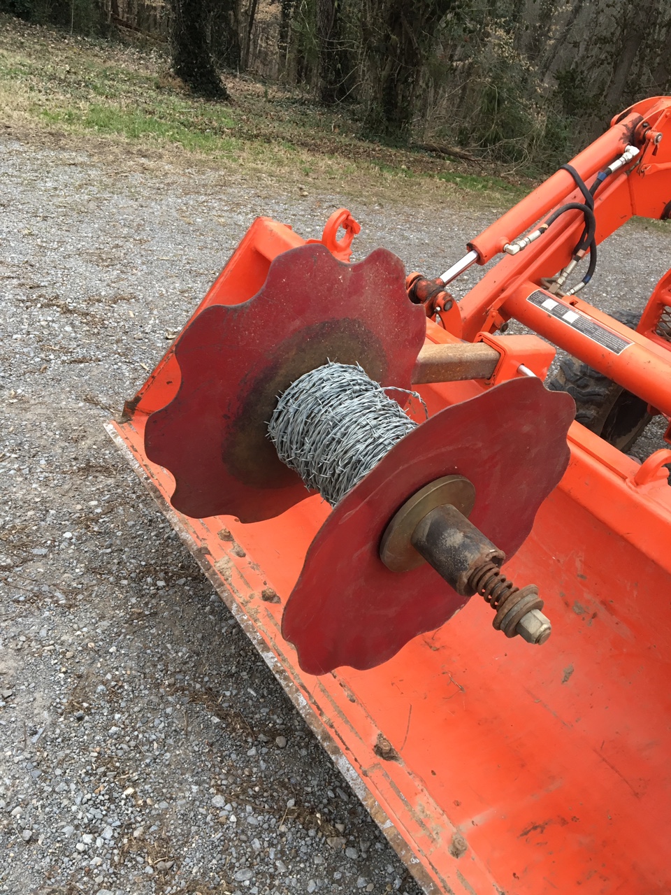

   / Homemade fence unroller #31
Do you have a pic of the other side? B.
Scrap pile slip clutch. Thick brass washer/plate and some plate and washers cut from 1/4” UHMW sheet stock. 45# Cummins valve spring. Provides drag tension much like a fishing reel to prevent bird nesting.
