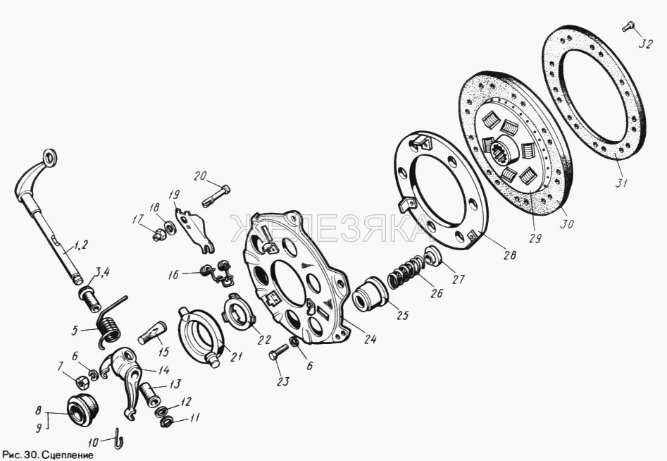

From what I can see, the drive train is slowed down by the vee belt pulleys off the motor. What I do not see is how the clutch system works on your tractor.

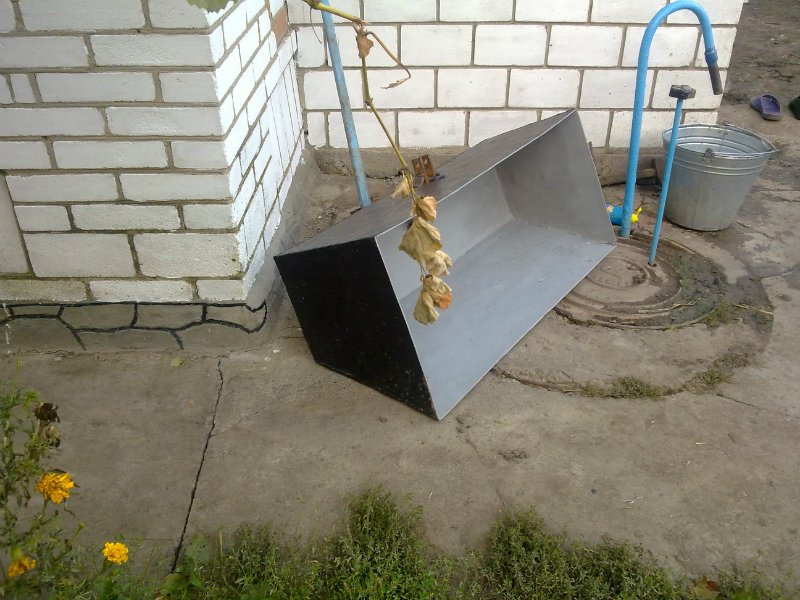

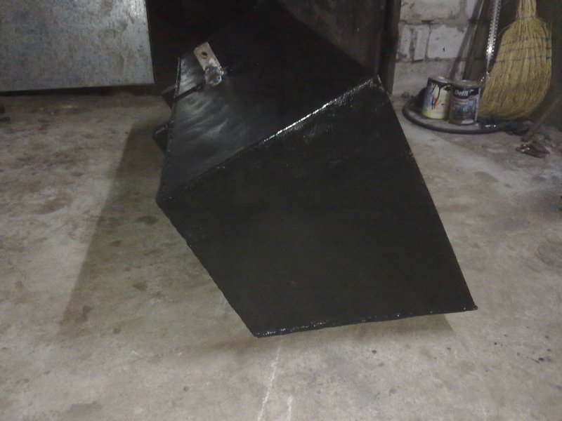

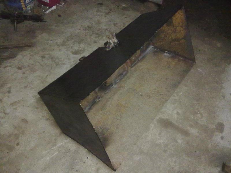

For snow clearing, you may want to consider a lift that includes a chain so the blade will float over the ground. The other thing I would suggest is you may want to add skid shoes to prevent the blade digging into the ground as you push the snow off. I don't use a front blade for snow clearing. I use a rear blade on a 3 pt hitch which has no down pressure and a float function built in. I don't use skid shoes because the ground where I am freezes solid most of the time I need snow removal. The few times I have cleared snow before the ground freezes, I've had issues rolling up long strips of wet sod...

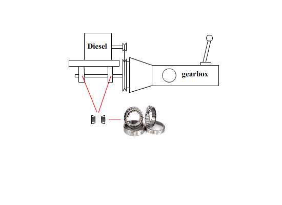

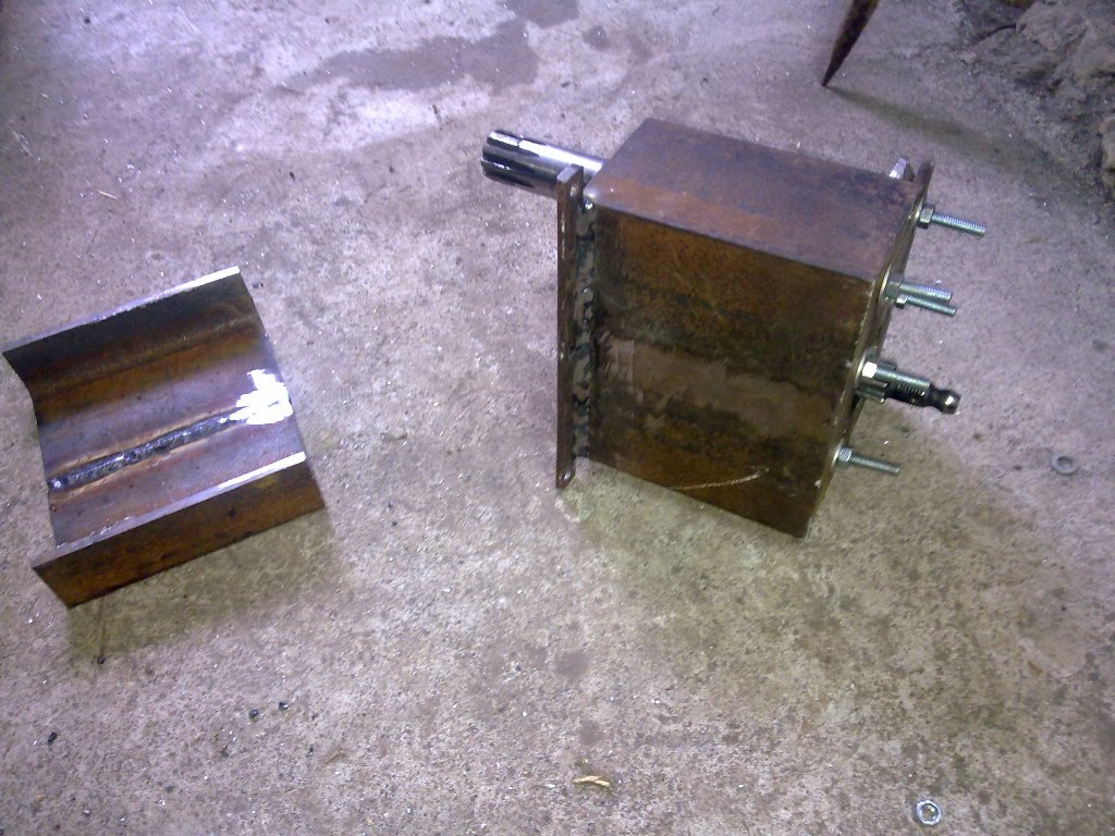

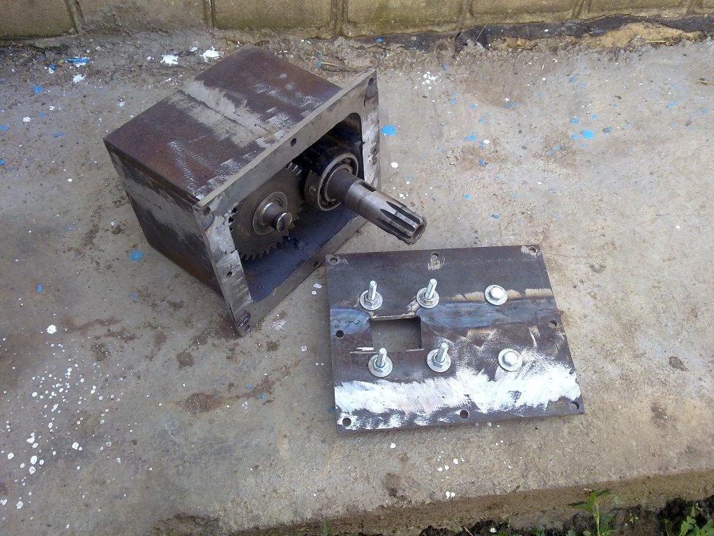

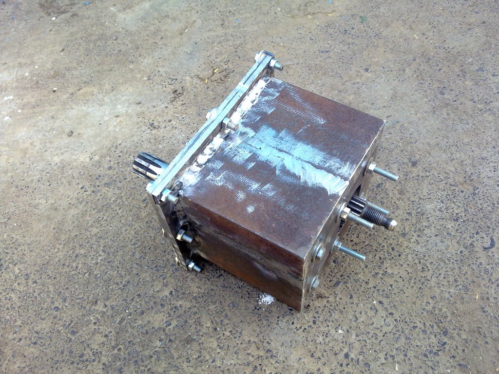

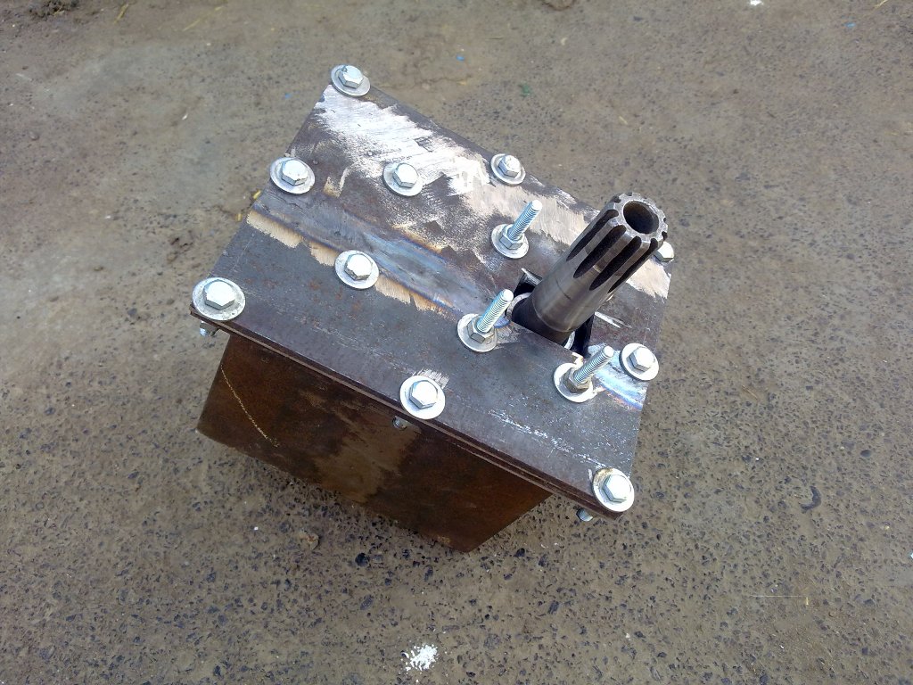

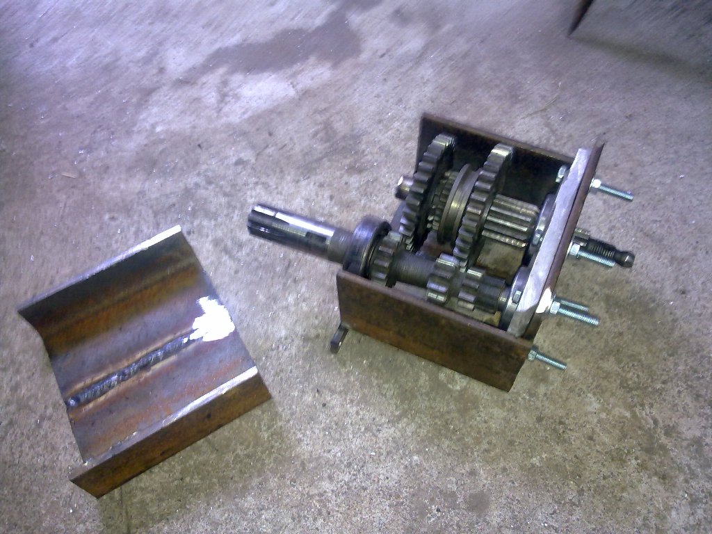

I have no picture of the clutch. Engine combined with transmission via V-pulleys, slowed down against 4:1. System-disk clutch, V-belt pulley screwed bolted to the flywheel.
   / Homemade garden mini tractor 4x4 #44
Thanks for the speedy reply. I am still a little confused as to how the original equipemnt clutch works without the bearings of the engine crankshft to hold the flywheel in place. I guess I need to ponder this a bit more.
   / Homemade garden mini tractor 4x4 #45
I know you wasn't loudo , I was just joking a little, enjoy that warm weather. There's 30 mph winds here , temp around 40, but no poisonous snakes or crocodiles, haha.by the way we i. The states really miss Steve Irwin. A nice guy.
#46

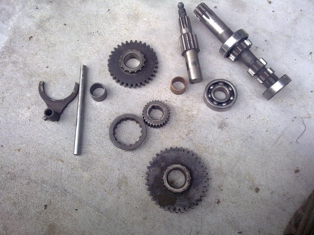

Camdigger, You must have 2 bearings. If you put less than 2 bearings, the transmission over time break down.
I decided this problem so as shown in the picture
   / Homemade garden mini tractor 4x4 #47
Thanks for the clarification.
