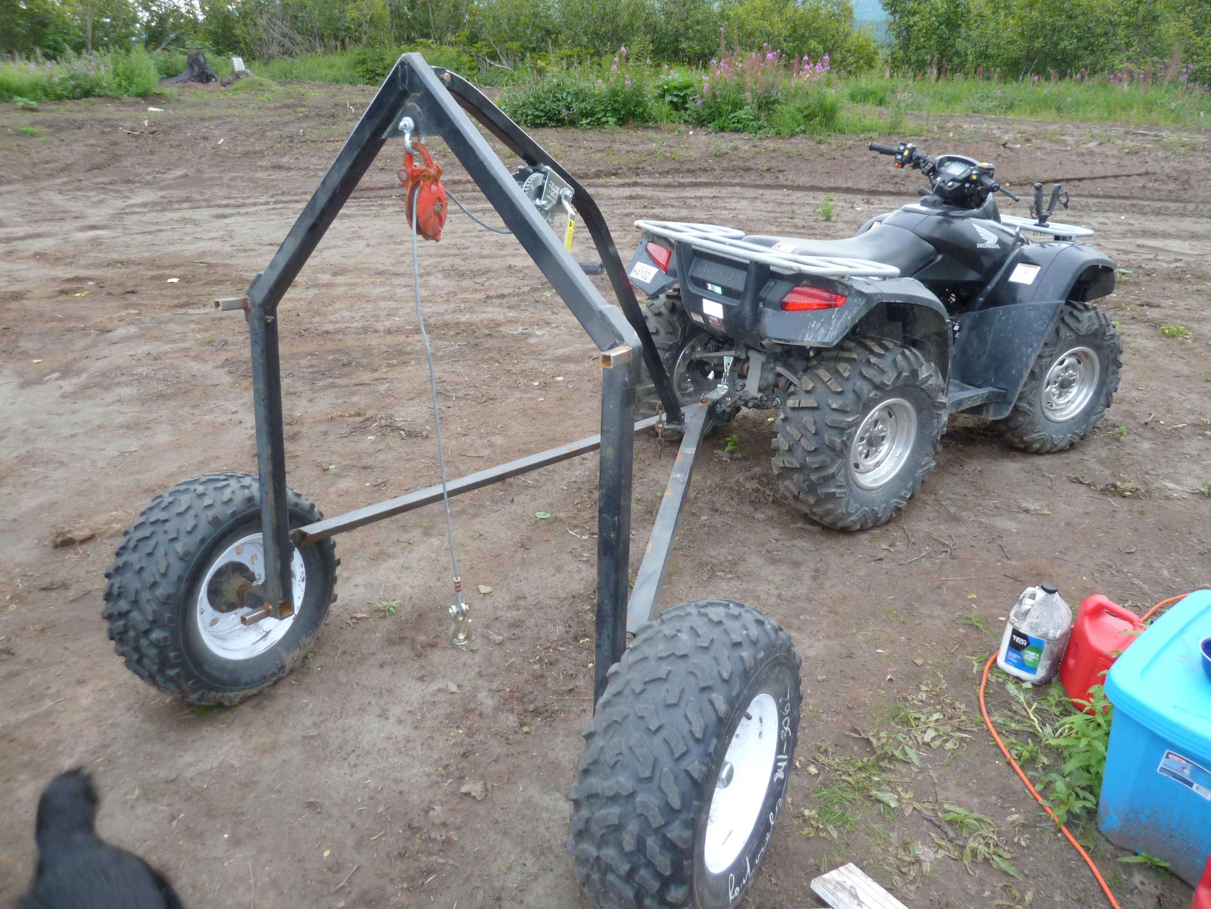

that is the thing about the worm gear winch. Do put your tractor against anything for stability. You must leave yourself an out by being able to back up for slack. The only other way is to stop it all and wind the shaft backward by hand. Using hyd is fairly slow unless you have a lot of volume. Here are a couple of mine, one is electric the other hyd. tossed in a small arch/dumptrailer I made for my quad. Did one several years ago for a tractor and it worked well, just larger.
