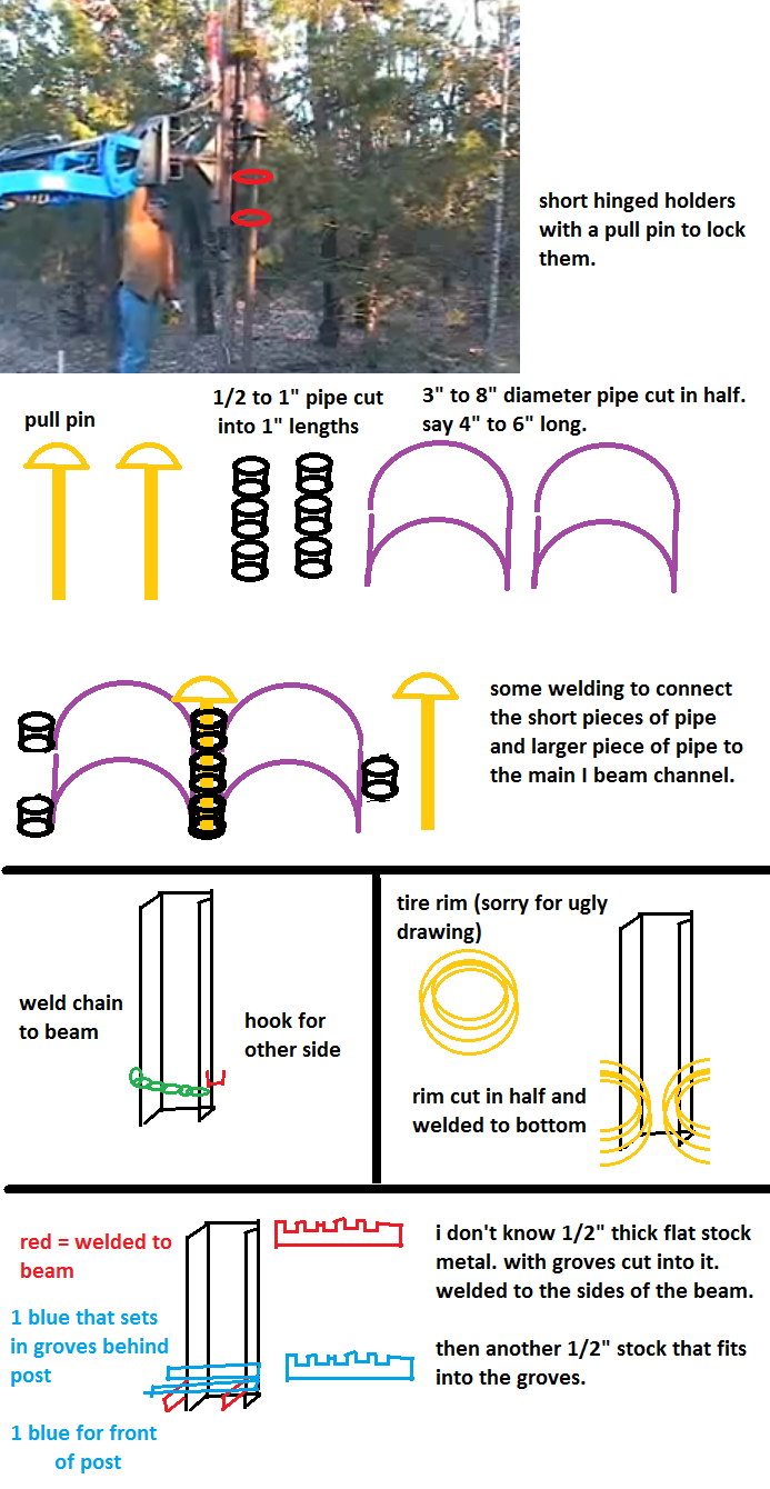

/ Homemade Post Driver/Pounder #7
looks like you need rear ballest. box blade for weight example extra weight on the box blade. and put box blade on ground. to help stabilize the tractor some. granted front end will bounce some. but perhaps not as much. and give you some better stabilty when on a hill. and working the driver.
i am with others moving controls back away.
from watching video. it looks like you could make generic hinges. out of say 6" or 8" pipe. that you can open close with a hand pull pin to lock them.
or perhaps welding a chain to one side and a hook on other. so you can just swing the chain around the post and hook it. with some slack in it.
car rim cut in half and each half welded to create a grove / hole pipe fits into.
flat bars with groves idea (see diagram/picture)
at moment i could see end of pipe jumping out and do some serious damage to ya. or pipe bending and knuckling ya as it jumps out and away. seen it happen a few times. i tend to use the backhoe myself. i will put a larger size end that slips over top of post. then push the ground rod, t post or like down into the ground, by using the backhoe bucket. and i know them posts can do some pretty good jumping and flying around.
but i have never seen a post driver up front and personal so the ideas for locking post in spot may be pretty far out there. or at least keeping the post were it should be and not some place else completely.

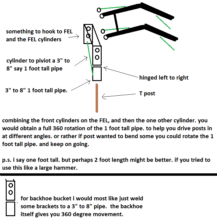

i wouldn't take my locations to serious. as i said. i never seen a post driver up front and personal. i just drew in the spots that seemed easiest for me to draw to help get idea across. found it easier to help get idea across with DIY'ers vs trying to get into the very specifics. due to for DIY'ers it is what ever they can find and get to work. that and most DIY'ers are tinkerers. once they get idea and half way plan (including myself). things tend to fall together fairly easily.
as far as beam length and a holder at bottom. it looks like you already done some welding already. if ya got some scrap iron. make your a couple L shape brackets and come off the bottom of the beam with them. instead of welding. perhaps use a couple real long bolts. to hold the L brackets on.
myself however wish i could weld. i would be turning 3" to 8" heavy duty metal pipe into a bucket for the backhoe. to just push pipe and T posts down.. though wooden posts might be a different story. haven't tried a 3" to 4" wooden post yet. granted for me. the same seat is used for backhoe and tractor. if ya had to switch seats. that would be a pain.
p.s. i understand about pill and taking off backhoe. if it weighs more than i can lift by myself. generally it can be a pain to hook up. if you are not perfectly aligned up. and no one to help ya align things up. makes it even worse.

i used the backhoe bucket. due to the bucket has a little bit of a lip were the teeth are welded to it. which allows a little bit of a catch for the top of a T post to grab ahold of. it takes some practice and good hydrualics that you can count on not being jerky at low RPMS. at least for me any how
if i tried to use the bucket off of the FEL (front end loader). i would end up having posts going in side ways and bent all out of place. more so sideways. and even with using the backhoe bucket i did bend a couple older T posts and put a couple in at an angle. say out of 30 posts 4 to 9 were either bent or at a slight angle. but for what i was doing i really could care less. due to the hot wire fence going on it. was / is only temporary. and if i bent a couple T posts it was no big deal. now if i was putting up mesh wire or a chain link fence. it might have been a completely different story. and may of pulled a couple T posts and re put them back in.
attach diagram. i would want the backhoe bucket version. then again. the ford 555c i am guessing weighs a lot more. and using a smaller size backhoe for say a small skid steer or sub compact / compact tractors may not work. due to just using pure weight to push posts down into the ground.
and trying to drive say 4" wood posts may not even be possible for me. then again haven't tried yet. though T posts, ground rods, pipe i would like to think most backhoes would be able to do so. if the ground is half way soft. and not totaly hard compacted and not a lot of rock in the dirt.
on a side note. driving posts tend to be much easier with 2 people. one at the controls and other grabing posts and making sure they are level. and with T posts and if you are putting up wire mesh. making sure the T posts are facing correct direction so the teeth on the T posts go towards the side the wire mesh is getting put on. the teeth help hold the wire mesh in place. vs relying on the 2 to 3 pieces of wire holding the mesh to the fence post. if you are putting up hot wire fence. you need to make sure the T posts are facing correct direction for the plastic insulators you want to use.
sorry for last bit. but been there done that. and thinking why did i do that in the first place. as i look at a post i put into the ground.
