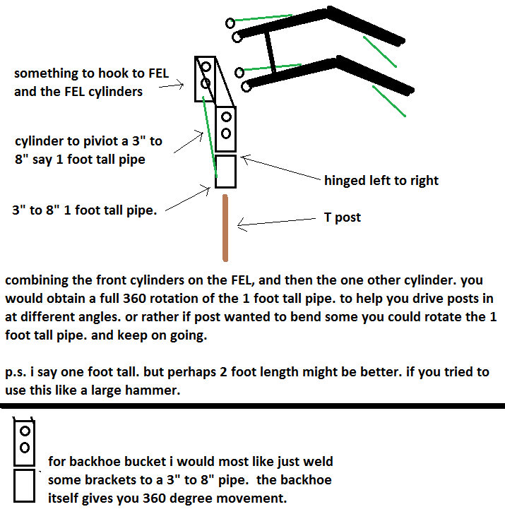

looks like you need rear ballest. box blade for weight example extra weight on the box blade. and put box blade on ground. to help stabilize the tractor some. granted front end will bounce some. but perhaps not as much. and give you some better stabilty when on a hill. and working the driver.
i am with others moving controls back away.
from watching video. it looks like you could make generic hinges. out of say 6" or 8" pipe. that you can open close with a hand pull pin to lock them.
or perhaps welding a chain to one side and a hook on other. so you can just swing the chain around the post and hook it. with some slack in it.
car rim cut in half and each half welded to create a grove / hole pipe fits into.
flat bars with groves idea (see diagram/picture)
at moment i could see end of pipe jumping out and do some serious damage to ya. or pipe bending and knuckling ya as it jumps out and away. seen it happen a few times. i tend to use the backhoe myself. i will put a larger size end that slips over top of post. then push the ground rod, t post or like down into the ground, by using the backhoe bucket. and i know them posts can do some pretty good jumping and flying around.
but i have never seen a post driver up front and personal so the ideas for locking post in spot may be pretty far out there. or at least keeping the post were it should be and not some place else completely.

ya got top portion figured out. sounds like.
though i would still want something at the very bottom.perhaps 2 little pallet forks. that keep the post from jumping sideways on you / hold the pipe for you as you initially drive post into ground
sorry, but when i saw you grab hold of the post with one hand in the video as you operated controls with the other hand. and had no easy view of what was going on. i just *cringed*
other words ya got a nice setup. it is, just that loosing a hand part that has me. from the video, it looks like good manufacturing and should hold up good for a long time. but a little bit more fine tuning for the safety factor.
an idea possibly. DIY a large pliers. and weld to the bottom. with a chain that you can hook on something. will see about diagram later on for ya.
