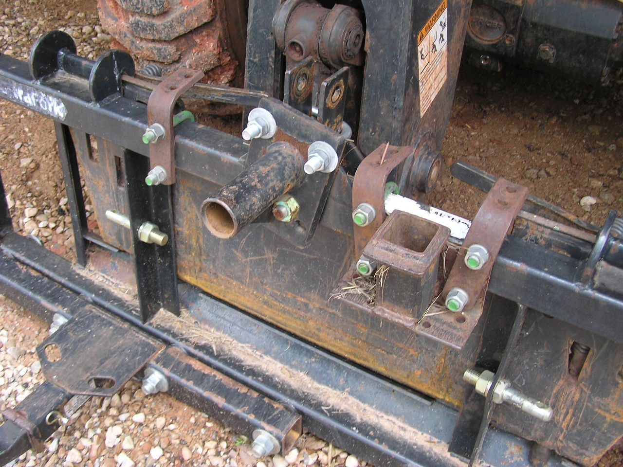

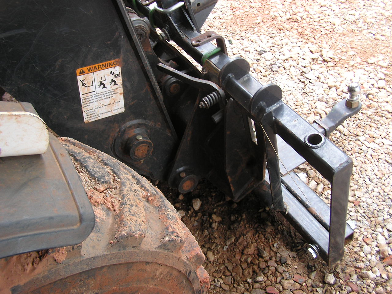

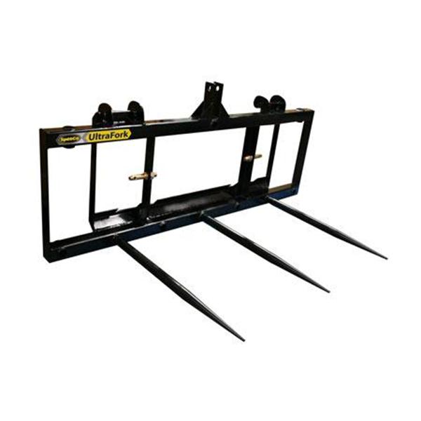

Two options, build a 3 point adapter, or put the adapter plate on the spear in such a way that you can still use the spear on the 3 point.
This is what I have, it fits either end! :thumbsup:
Right click picture to open in new tab
On the front SSQA.
On the 3 point hitch.
