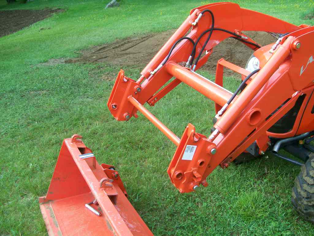

Yup, ordered it that way. I knew I wanted QA but the dealer wanted to add $800 for the SS style and only an extra $150 for one like we've been discussing. All things considered, $650 was far too much for the loader plate as the bucket should be the same price or cheaper. Now if I could come up with a way to make this pin on style into hydraulic activated, I'd be all set as that's the main reason for me to switch to the SS style.
This is exactly what mine looks like, someone else's pic from another thread: 209360d1303507970-b2320-w-la504-quick-attach-forks-001.jpg
This is exactly what mine looks like, someone else's pic from another thread: View attachment 302656
You mean like this? Video may take awhile to load.
Gotcha. Thats why I brought up the titan SSQA adaptor. I think i priced the adaptor, and three plates to like 600$ some dollars. For me, thats feasible and not a bad price at all for the amount of time I spent on building the pin on quick attach, and the time it took me to modify a set of forks to utilize this setup. Other setups I looked at before hand were 600$ plus just for the SSQA adaptor.. I'm not putting out a plug for titan, just throwing it out there for people to know because I jsut went through this same thing, it was a lot of work keeping the pins in alignment and just doing the "basic" fabrication of it.
