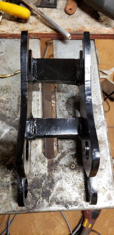

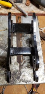

Since nobody currently offers a ripper for my RK24, I decided to whip up my own.
:dance1::2cents:
Fabbed the ripper tooth Monday night. Fabbed the mount and welded everything up last night.
Have less than $150 in it.
Video: Homemade Root Ripper - YouTube

Gave it a quick test last night on a Ø2" root out back. Snapped it like a wee toothpick. I'm out of stumps to rip out on my own property, but I have friends lined up that want some removed, so I'll have to wait to really test the ripper until I can get to their places.

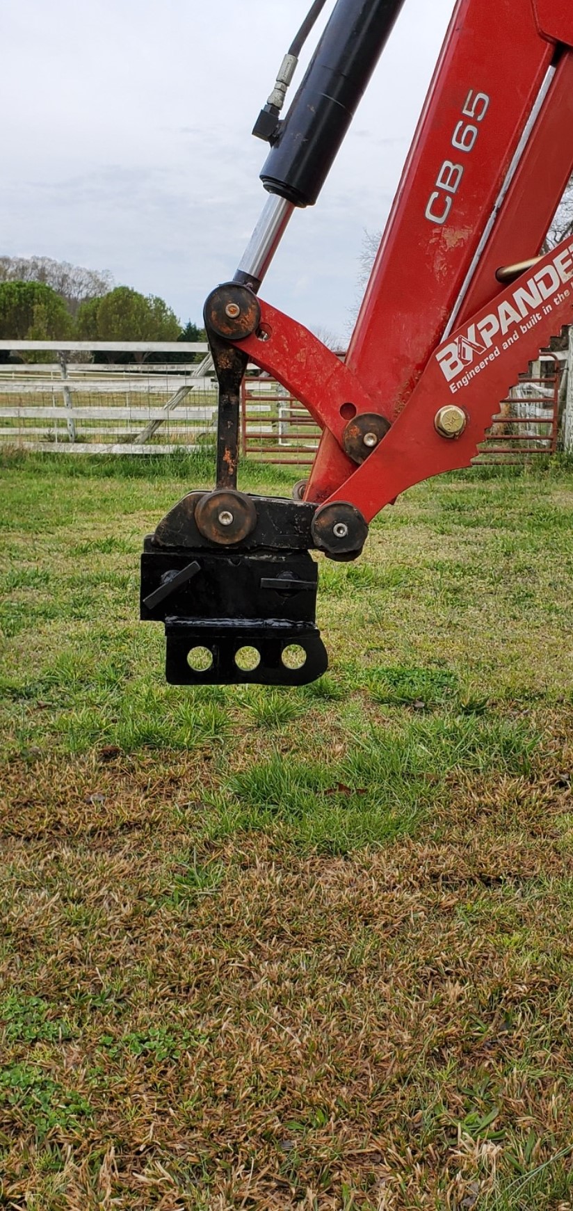

Mine is similar to Bxpanded.
Backhoe Bucket Connector
I am sure it does reduce force but I don't notice it at all.
It allows me to switch between my buckets. I have made a 6" and a 16" bucket. I also have the OEM 10" bucket. very quick to switch between them.

Nice. Yeah, I have a 12" bucket, 9" bucket, and now the ripper. We'll see how long I put up without a quick attach (especially with the thumb sharing a pin). LOL
