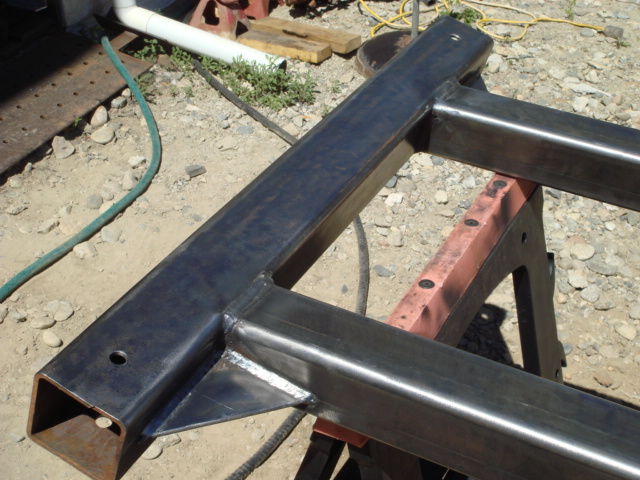

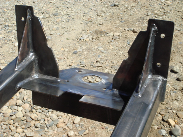

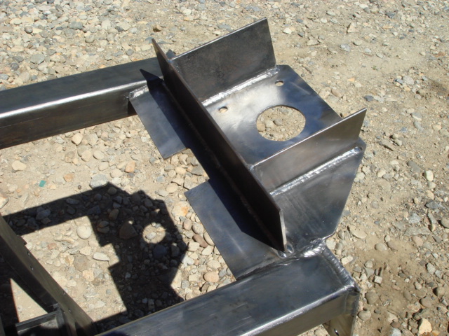

While understanding that it is never recommended to make your own ROPS, I recently purchased a nice YM240D without any protection. Using 3/16 tube and flat plate, I welded up a quick and dirty solution to prevent a roll. Attachment uses the four bolts at the rear of the tractor (PTO guard) and top of axle attachment. This gives a bi-directional attachment at 90 degrees with large fasteners and distributes the stress over a large part of the tractor. I also fabricated a new PTO guard out of 1/8 plate, using it to reinforce the rear attaching plate. Attached are a couple of pictures before painting. I will add some more once painted and installed.

Well, I don't know how well it will protect you, but it is about the prettiest welding I have ever seen. Correction-- it IS the prettiest welding I have EVER seen.
/ Homemade ROPS #4
Somebody will probably hop in here to moan about the ROPS not being certified, but to those i say i'd volunteer to just buckle me up in the seat and roll the tractor.
Nice work, looks like you know your welder ;)

Thanks everyone. I appreciate the feedback. I think there is good reason for people not to build their own ROPS, as they may not understand the limitations of design, their welds or the steel. Once you venture out on your own, you definately are on your own. I have built ROPS for cats and other equipment and they have been tested in the field and held up fine, including a multiple roll over on a track unit. I am confident this will do what it's designed to do, which is to prevent a flop from turning into a roll. It isn't as nice looking as a commercial bar, but then I'm not a stylish type of guy. Thought it may be of interest, but I do appreciate that there are many people who would not feel comfortable using a homemade ROPS.
svcguy,
Your welds look great.
How thick is the material you used for the Axle attachment points, I would think 3/8" material would be the best choice, if not 1/2". With all of the gusseting and reinforcements you have done on that thin plate , it looks like that may be the stress point / bolt pulling through the thin material in a roll over.
just my 2 cents, but then all of my friends call me captain overkill when it comes to building things.

I agree that 3/8 or 1/2 would be stronger than 1/4, the question will be the actual bolts that come with the tractor that are used to secure rops on all YM240's. I think the fasteners will fail before anything else. I upgraded everything to grade 8 with large flat washers. The four rear bolts I replaced with full depth fasteners. The tubing has full length gussets at the base in front, as well as the sides and the axle plates are welded directly to the rear mounting plate. It's surprisingly stiff. As the YM240D only weights 1700 lbs, I think it will easily stop a roll. I agree though that more is probably better, as long as the weight of the ROPS doesn't roll it.
