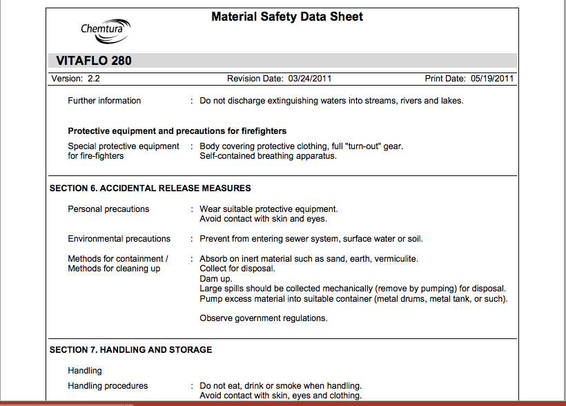

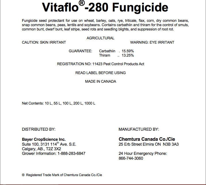

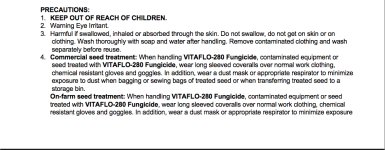

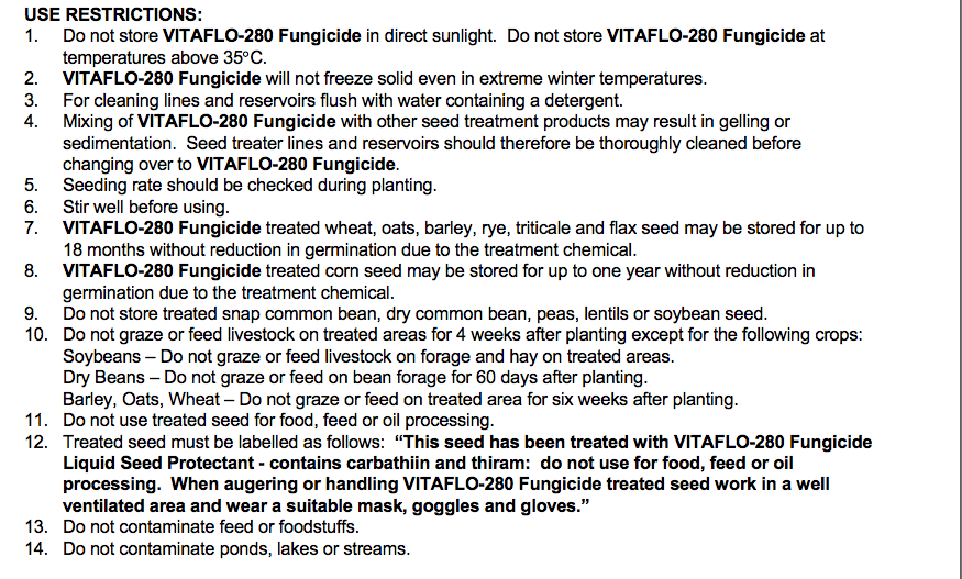

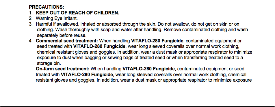

It had an emergency number sewn into the label. I contacted them, and found that it was treated with Vita-Flo 280, and I spoke directly with their chemical control hotline. They were the ones who gave me the information regarding the product, and they stated that the chemical burns would have been from direct contact with the product. The bleach mixture was only a splash of bleach to 5 gallons of water. Below are screenshots from the information that Bayer sent me from the seed that we had received, and Item Number 10 on the precautions refers to the Treated Barley that we received. The contact irritation only lasted a day, and was like a mild sunburn, but the seed was mis-sent, and not properly labeled, and not what we ordered, or what the USDA had ordered through the seed program. It incorrectly shipped, and labeled. There is a big difference between Barley that is treated to be planted, and what can be grown to feed as fodder, or mixed dry in feed. The MSDS advises using a respirator, and the precautions and if you read the full MSDS, it has a full page of nasty chemicals in it. Luckily we caught the error in time. http://www.uap.ca/products/documents/Vitaflo280MSDSE.pdf
View attachment 316475View attachment 316476View attachment 316477View attachment 316478
Now I get it!!!!
   / Homestead Grain Storage Shed #38
It was kind of nasty stuff, but it the funny part was one of the binding ingredients use to used with alcoholics to make you sick if your drank. They told me not to drink for 24 hours. I know that the military use to use it on troops, and I am glad that they didn't when I was in!
Now I get it!!!!
