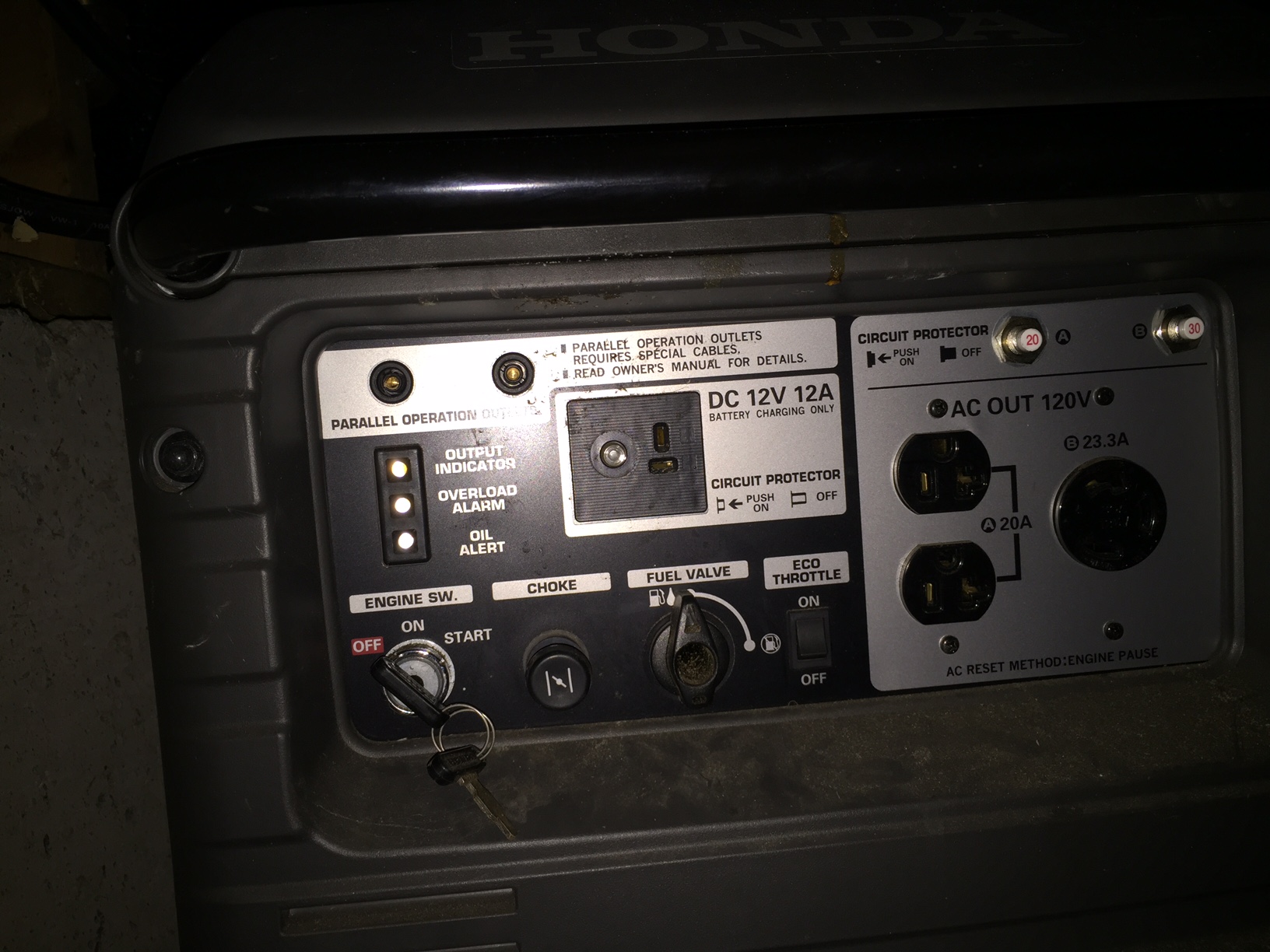

I have a Honda EU300is generator that is absolutely a dream machine. Extremely quiet, easy pull start and has an electric key start as well. I finally replaced the dead battery and am wondering what you all think is the frequency and duration of start/runs to keep the battery from going dead? I don't mind pulling it to start but my concern is if I am out of town and we lose power. I don't want my wife to have to pull start it anymore. I suppose I could rig up a battery tender on it just like I do on my tractor (during the winter months) but it doesn't look so easy to run the leads through the case.
Another question while I have you here... I always leave the fuel switch in the 'on' position. Is there any good reason to shut it off when sitting? I want it to be a simple pull the choke and turn the key for the wifey.

I like your idea but I don't see any remote option on the face of my unit though. Other problem would be the ventilation. I have it in my tool shed which is common to the house and would need to come up with a way to exhaust it to the outside.

Okay found and read the manual on line. Learned something. Shouldn't turn on the Eco-throttle (great feature) until warmed up. Also looked at the maintenance schedule. I guess I should give her some more attention. She sure does purr nice! I also recall a nice outdoor generator storage box that 4shorts built. Might have to resurrect that post/thread.
Do you mean this old thing :cool2:
