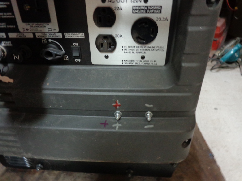

Easier said than done, I'm afraid. The battery is buried in the machine with no easy external access. So an off-the-shelf battery disconnect for a post-style battery wouldn't work. I think a custom switch mounted externally, and some rewiring would be required. But it's probably the only solution, and I might have to bite the bullet and figure a way.
Yes the battery is a bit buried but... The battery tender junior that I buy come with several different end leads such as spring clamps, eyebolts, etc. with a quick disconnect plug about a foot long. Been too long to remember exactly but I was able to permanently connect the leads to my battery and extend the wired plug out through the housing cover so I can easily unplug the tender in seconds. I will try to get a picture later today when home.
Here is a picture... not too revealing but I just ran the connector from the terminals under the housing on the right side so it is easy to plug/unplug the battery tender if I need to go portable.
   / Honda Generator battery operation question #34
In case anyone is interested this was my mod. to simplify keeping the battery charged. It is recommended that you don't allow the battery to get below 12.4 V . To maintain this as my gen sits often for long periods of time every 1 to 3 mons. I like to hook my battery Minder to it so this is what I did.
The bolts are 1.5" long Approx. 1/4" I happened to have metric bolts with 10 mill nuts so I used them to match the one on the front of the machine so 1 wrench would do the trick if I wished to remove them. I crimped eyes on 2- 16" pieces of 14 gauge wire 1 for each post. The reason for the length I can take off the front to get at the battery with no difficulty.

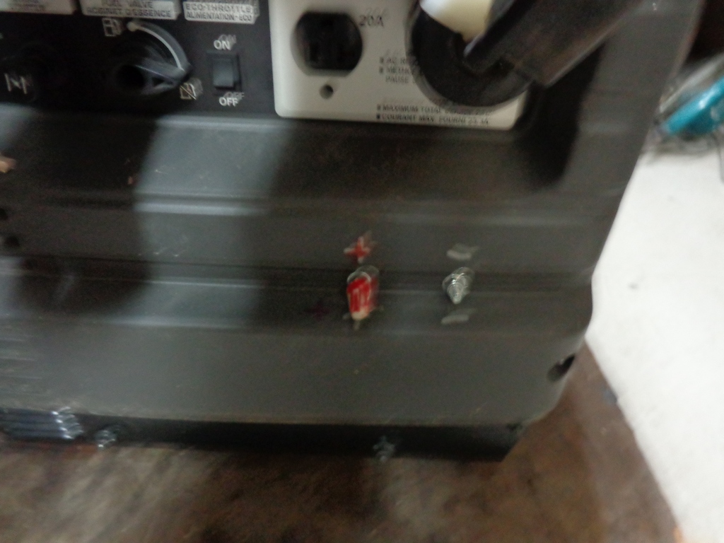

Here is a poor pic. of a marret screw on the hot stud to avoid an unnecessary short but I doubt it would be a problem since the front housing extends past the end of the bolt.
