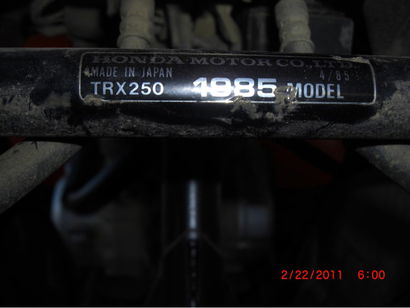

Not sure if this is the right place, but here goes.
My neighbor and I were chattin over the fence yesterday, discussing my brand new, that morning, Husqvarna Garden Tractor, which I LOVE, by the way. Any way, he asked me if I was interested in his old Honda quad. It has sat for a couple years and was giving carb issues before he moved on to a golf cart to do his chores with.
He gave it to me!!!!!
Soo, my question, is how do I tell what model this thing is. I don't know the year, but according to him, it's a 250cc, and it's a 2WD. It's green and looks just like the 4WD models, sans the front diff of course. It's manual shift, but no clutch.
I want to get a manual for it, but would like to know how to tell what year/model it is so I can get the right manual. Any suggestions on where to look? I don't see any name plates, it just says Honda, made in USA.
Any helpful hints appreciated. Also ideas of what to expect carb wise, or tuning?

Should be a vin number stamped into the frame. There is also a sticker which is usually on the front frame rails between the left and right suspension arms.

I found the sticker I needed to find, on the frame rail in front. It is a 1998 TRX 250, so I will go from there, to do the clean up and restore.
Here's a shot of it. Pretty decent for a 98 that's sat outside for years.

Green, 250 and a 2wd it is a Recon. TRX 250
The year of manufacture will be on that sticker as well.
