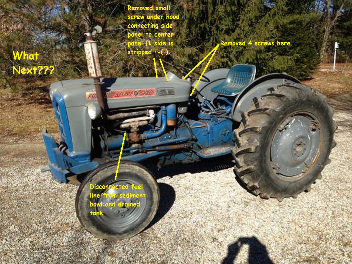

So I'm finally getting a chance to do some work on my tractor. Putting the front loader on hold for now - Well, more like I have to because right now I'm not getting anything done when it only runs a few minutes at a time before dying. Essentially, it fires up like a champ, warms up, I can drive it around 3-5 minutes and then kaput. Just dies and (usually) won't restart. Have run the battery down a couple times trying to restart it. After I walk away I can come back a couple hours later and it fires back up again only to repeat the same thing.
My guess is that due to the amount of rust in the sediment bowl each time it dies is that I have a rusty fuel tank, valve, and/or an air leak in my hose. There is no fuel filter between the tank and the carburetor.
So to start with I'm going to clean out the fuel tank & valve, line it, replace the hose, and install a fuel filter.
Step 1 - Drain the tank. Check.
Step 2 - Remove the hood. How in the world do I do that?
The shop manual and owners manual which I have have no clear instructions for doing so. Please speak in layman's terms because I am neither a mechanic nor all that familiar with tractors anyway. I removed the four large Philips screws on each side of the SOS control. From there, it appears I have to remove the PTO control knob, and at that point, I'm not sure where to go from there.

i am going to guess head lights will need to be removed. ((assuming nut on back side, is holding side panel and top hood panel together))
looking at the parts manual on line....
Document Moved -> agriculture -> select language -> parts -> online parts -> search by model number -> enter model number -> search -> click + beside stuff that comes back, to narrow things down to the hood (sheet metal & gaurds / grill)
from looking you may need to remove the 2 front side panels (each side of radiator) ( some screws around bottom side of panels, can't tell if side panels connect to radiator grill or not.
and hard to tell but possibly a couple bolts / screws at the top of the grill guard that might hold the top hood panel on as well.
looks to be some sort of "CATCH" up near or shortly behind the head lights as well.
   / Hood Removal, Fuel Tank Cleanout on Ford 881 #3
Remove the 4 around the dash and the ones that are on the bottom of the dog legs (the little front fenders), disconnect your lights, fuel line, air cleaner and anything else that might be attached.

yes at the front uoi need to take the dog legs loose, and from there you have some choices. you do not have to take the rear cowl off or the dash. but you will need to seperate the hood torpedo halves from the dash and cowling. all the bolts are eas to see and find. and expect that they will all fitght you and be rusty.
use penetrant oil. and chase all the holes when going back in.
leaving the dash means no instruments have to come off / out.
leaving tghe cowling means steering wheel stays/
no reason to remove the lamps.. just the wires. hood doglegs and side panels will likely be joined anyway.
you may want to take one side of the front nose apart.. or at least loose to get some play around the radiator..
no reason to take the fuel line off.. as the tank stays in place on the front and back bracket and is not attached to the hood.
to the OP. there is a filter atop the fuel tap, in the tank.
then there is a filtering sediment bowl with screen on the carb
