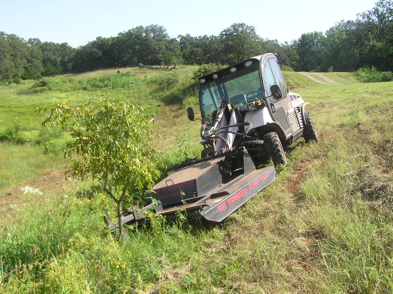

How good are those tool cats??.
Very good! :D 4 wheel drive, 4 wheel steer, 4 wheel independent suspension, 61 horse power turbocharged Kubota 3 cylinder diesel. SSQA with aux hydraulics on the lift arms. Check my threads in the Toolcat Forum for more pictures: http://www.tractorbynet.com/forums/toolcat/
Very good on sidehills with the 7' brush hog. :thumbsup:

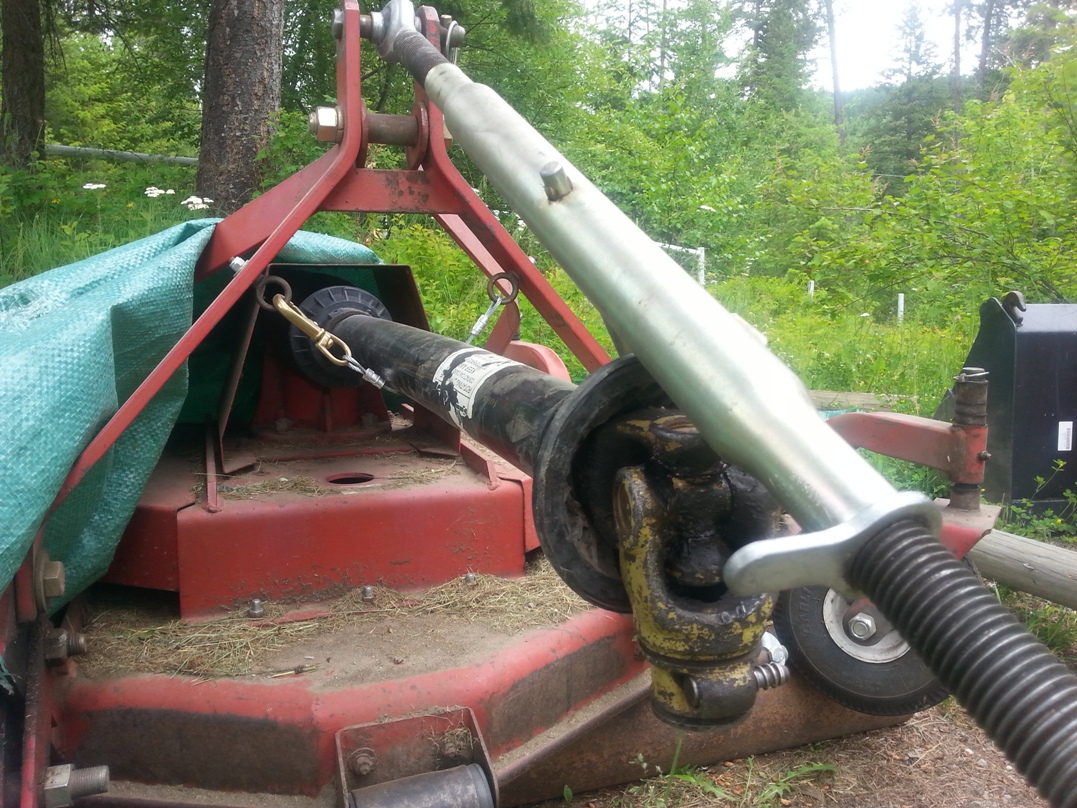

I keep a separate top link on each implement so I don't need to adjust them or have one protruding from the back of the tractor. My DK35 came with a hook but I don't use it.
Perhaps you could use some eye bolt and cable arrangement to support the top link. Here is a photo of one I use to support my finishing mower drive shaft:
