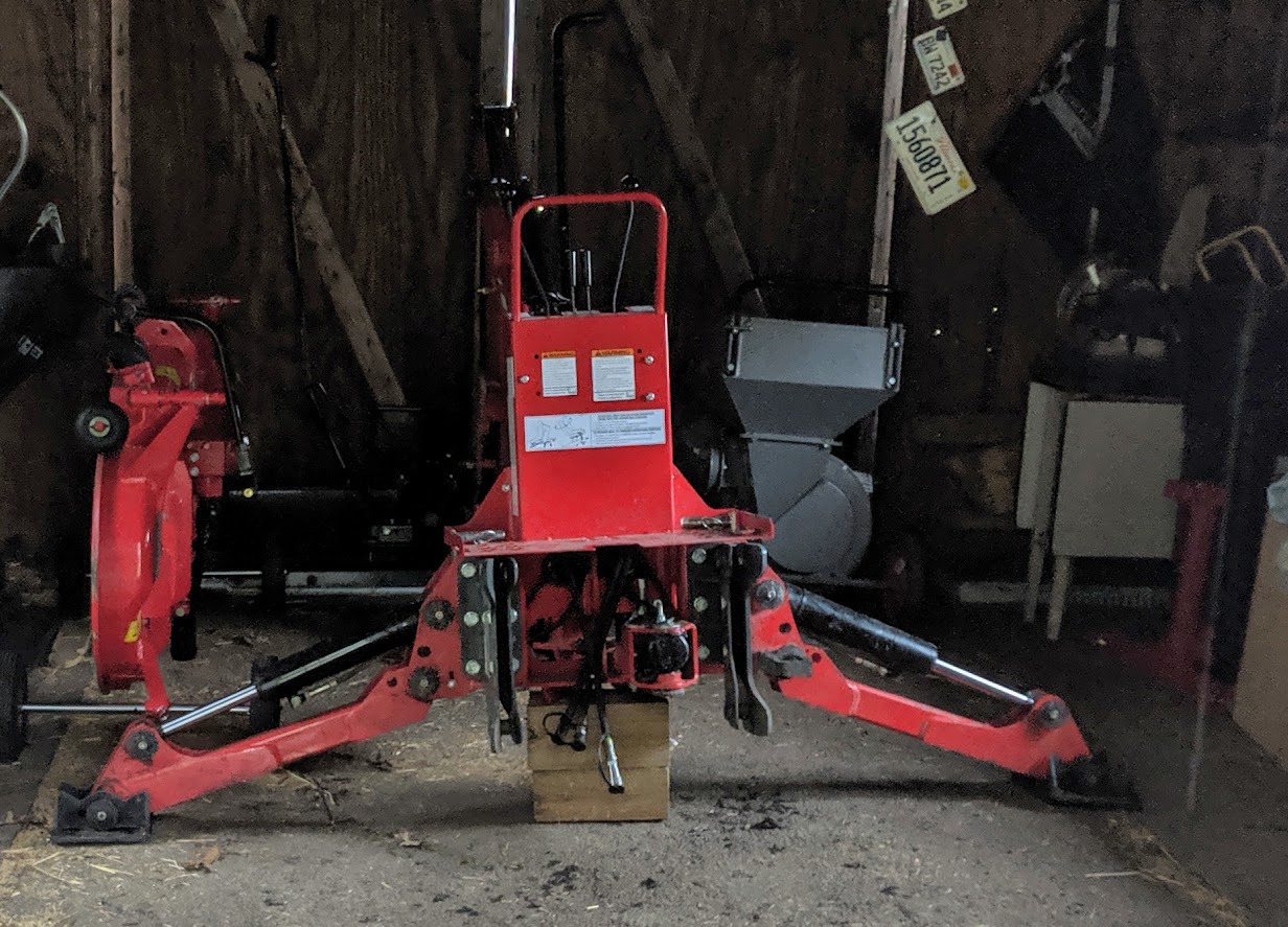

If you raise the outriggers all the way (because the BH is on blocks or a stand) you should tie them together otherwise they will drift downwards. They probably drift up too if you leave the BH's weight on them. According to my dealer the largest difference between the previous Ansung made BH and the current one is the new one has locks to keep the stabilizers up.

Basically. I raise mine high enough to disconnect the mounting pins out of the cradle, then to set the main body on blocks. Pull the ORs up just enough to settle the weight on the blocks, but leave them down to avoid tipping.
Looked at it yesterday though and because the ground is so soft from way too much rain, the blocks have settled into the ground and the whole thing is tilted. Going to be a lot of fun to connect next time. Guess I need a wider/longer 2x under the blocks to distribute the weight better.

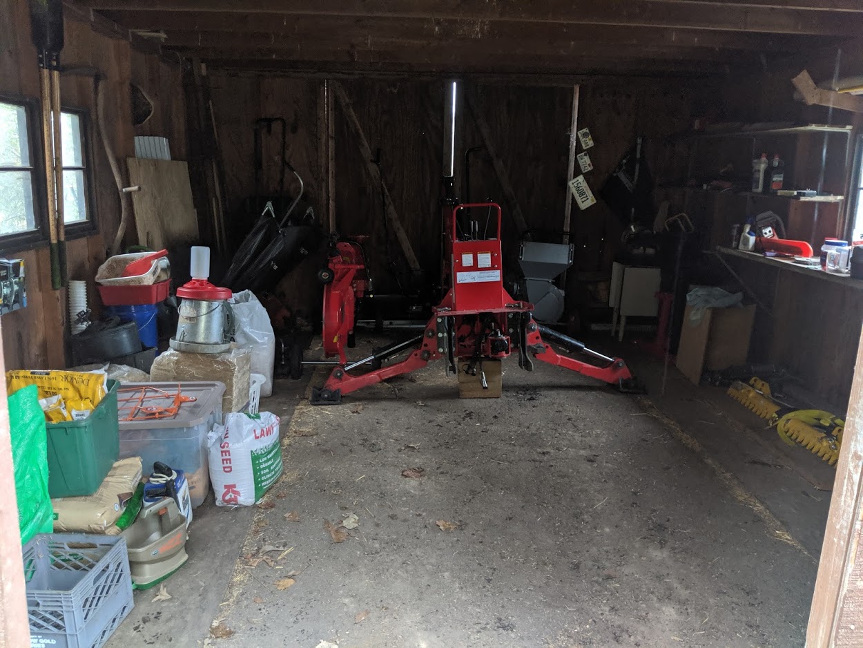

That's why I store mine on a wood block. I sit it down on it, the stabilizer legs just rest on the ground and add stability.
