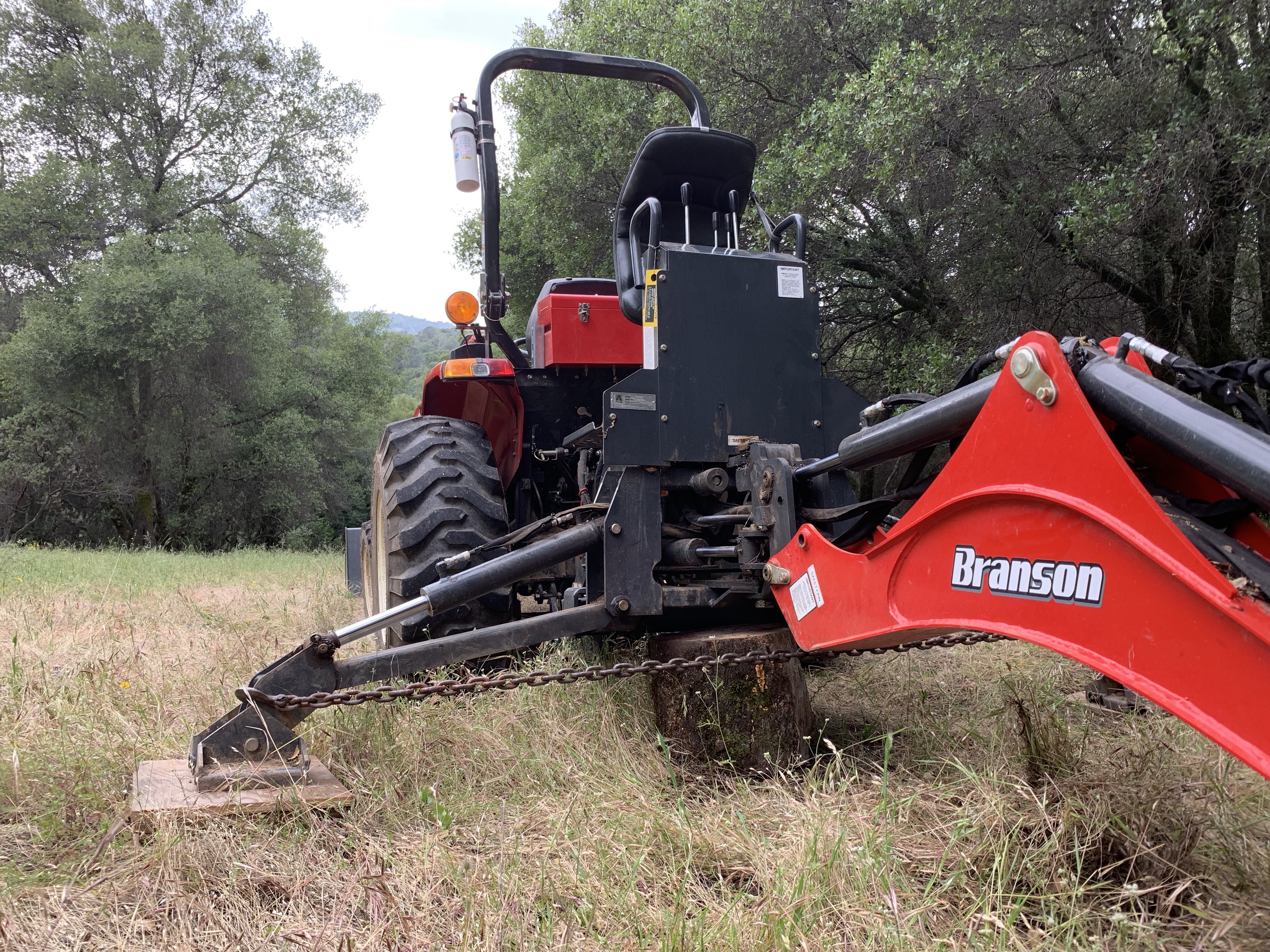

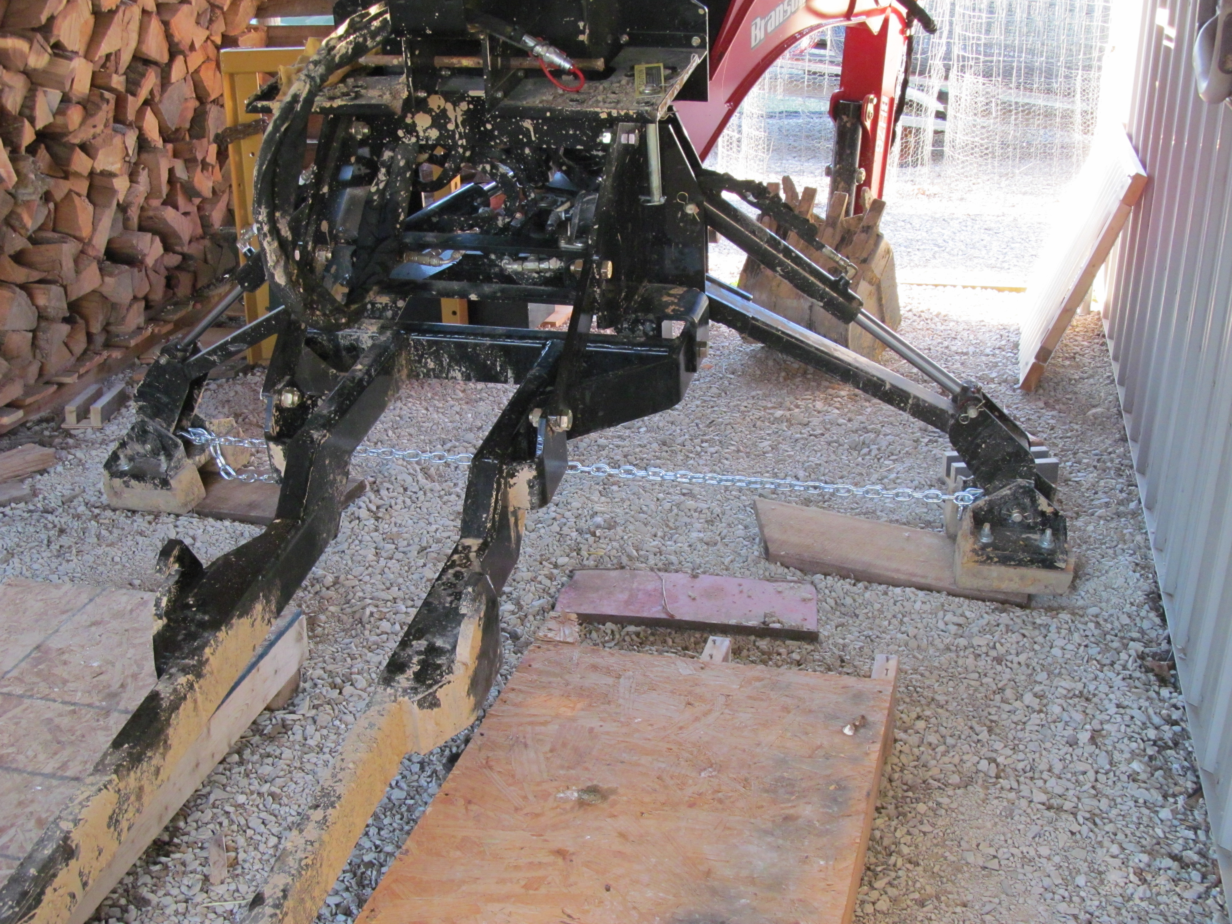

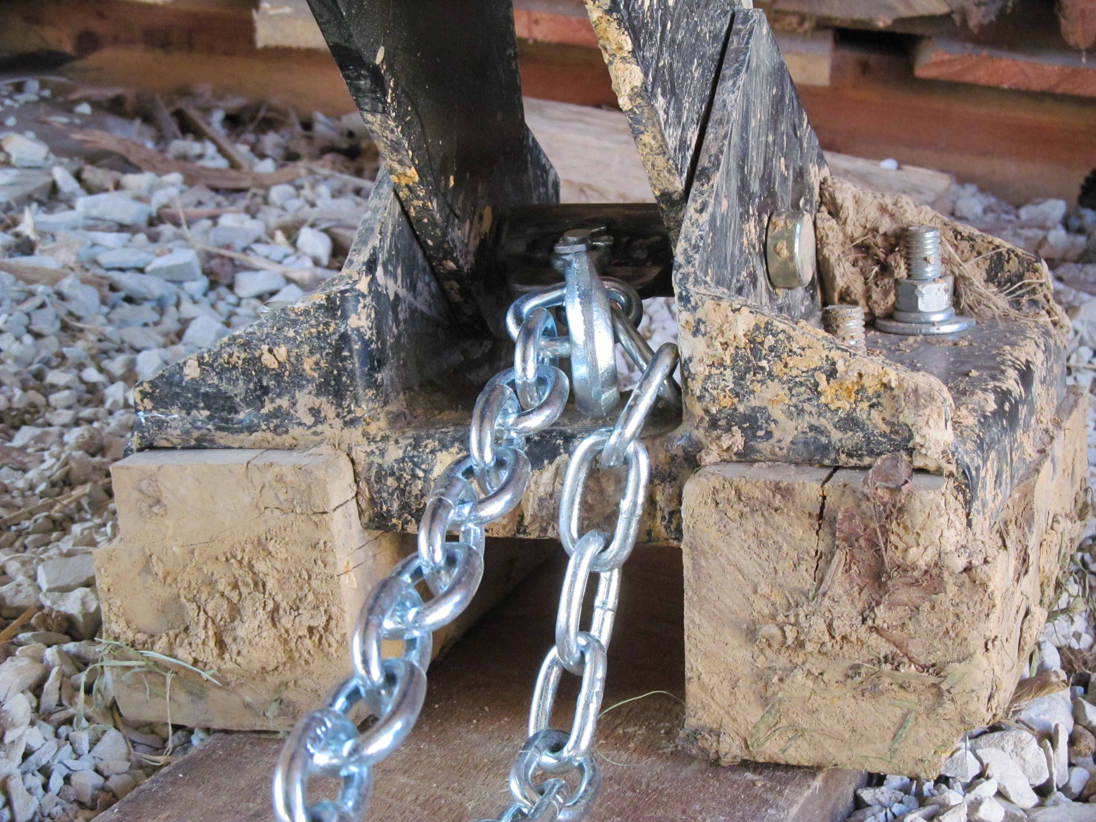

Here is how I store my back hoe when not in use. I have a chain between the outriggers and raise the outriggers until the chain is taught then I unhook the lines from the tractor.
The chain carries the load of the hoe and the line are easy to depressurize.
This is a really good solution. I'm going to be setting it on blocks in the pole barn when we take it off again. Like you and others stated, the pressure on the outriggers are the source of the problem.
So you basically have no weight on the outriggers? They are only there to stop an unintentional tip over?
   / Hooking Hydraulic lines up on Backhoe #48
The outrigger cylinders have no load on them. The chain is keeping the legs from spreading.
