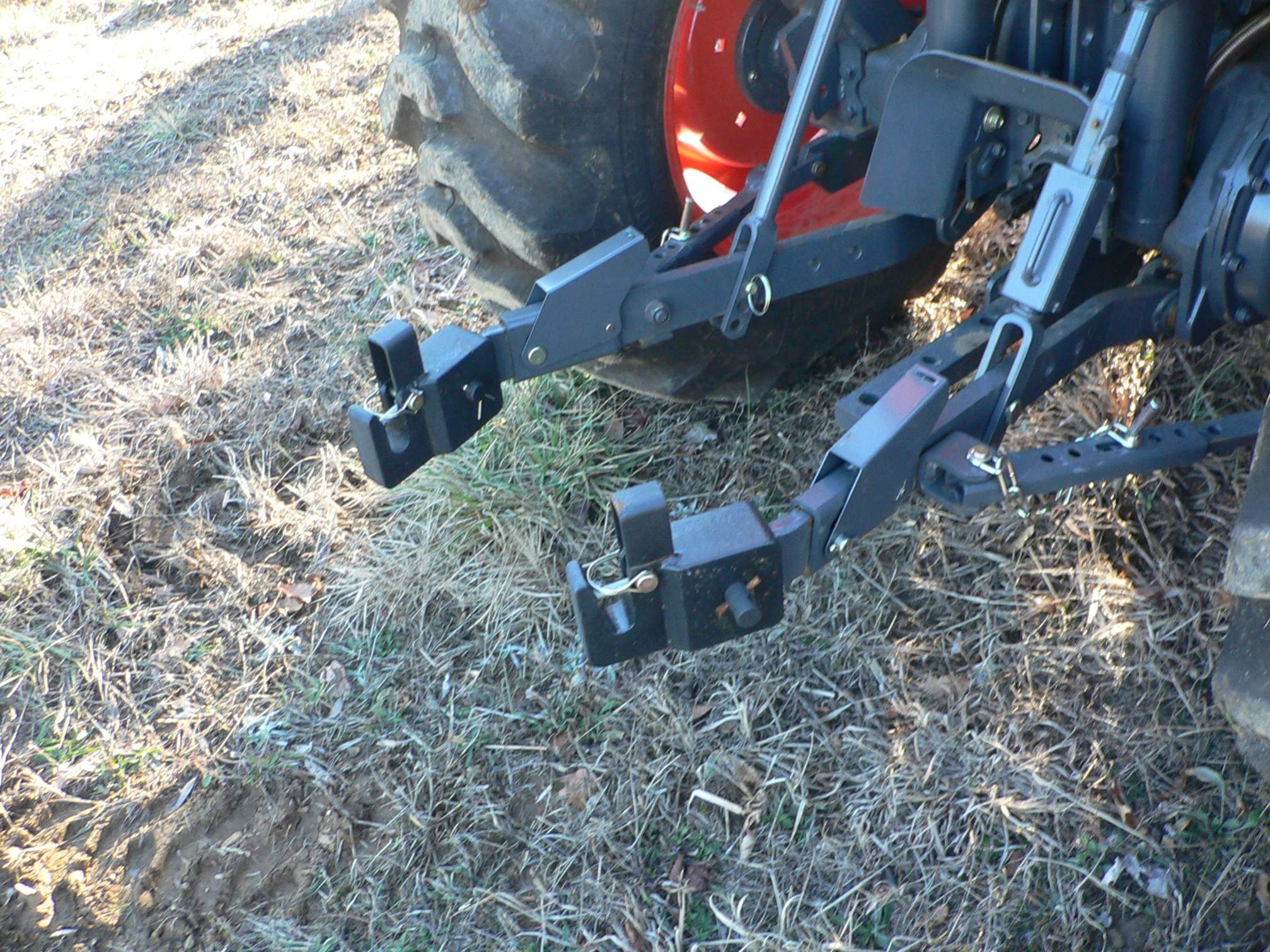

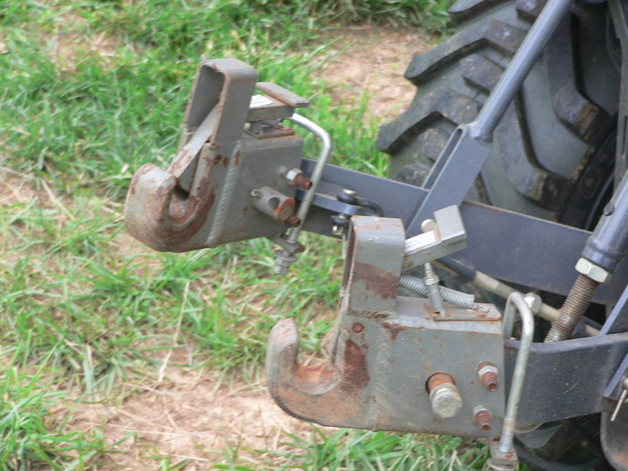

What you are seeing is normal. I wrestled with implements on my first tractor 6 years ago then bought a Pat's quick hitch system. Have since also bought a cheap set off ebay. Here are pictures of each set. The dollies sound/look like a great idea but I haven't done it yet but plan on it.

Thanks guys, I really wasn't sure if it was me or something was wrong.
That would be awesome if I could swap the pins - they are indeed pointing "out". But I bet they're welded in place or something? I'lll check that first though.
I like the idea of the quick hitch set up but will try the leveling and pins out first since I won't be using it that much.

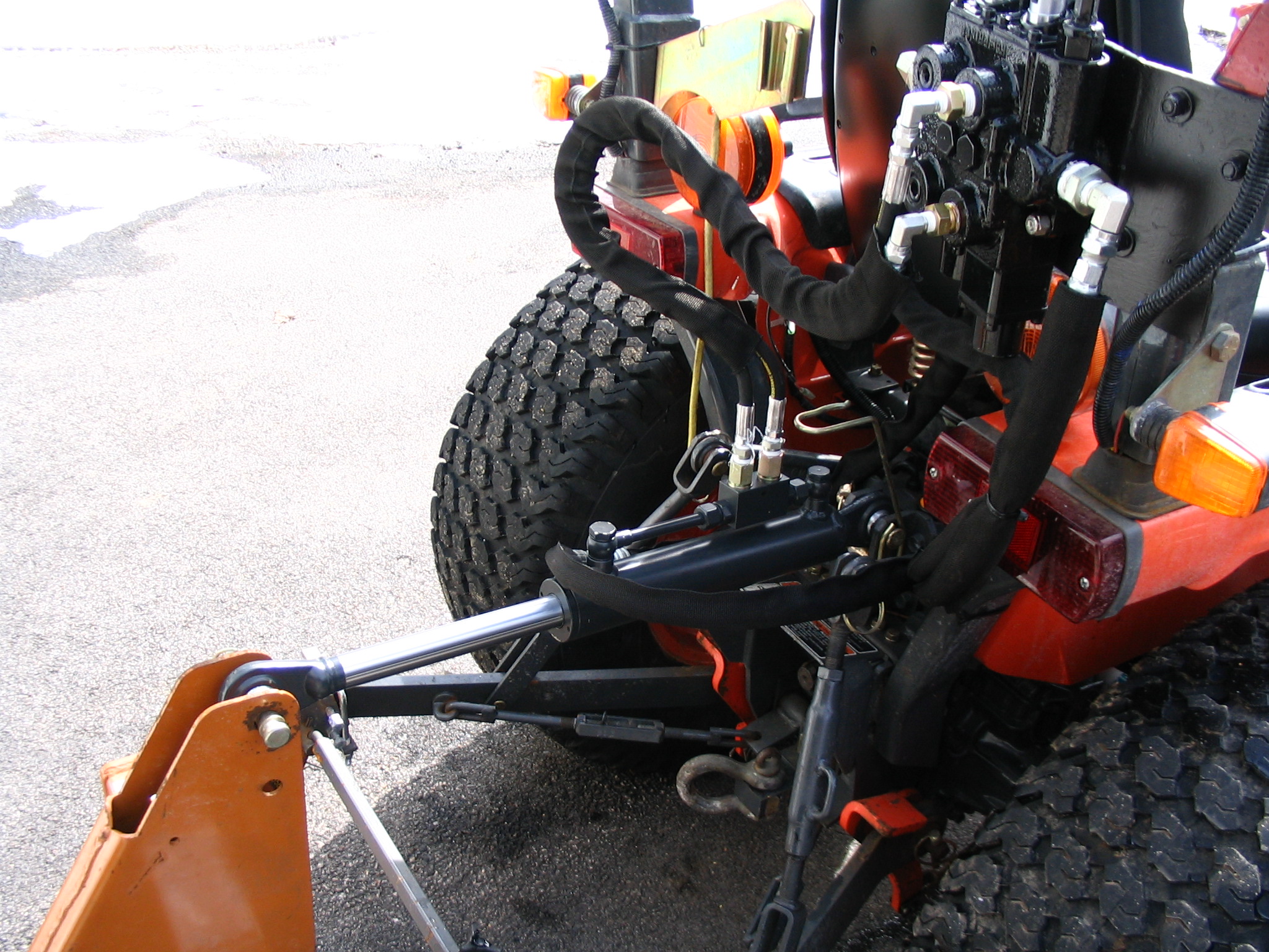

The last point (pun intended) is that hitching up the top hitch is a pain.... which is greatly reduced if you have a hydraulic top link AND can reach the hydraulic lever to adjust it while holding the top link in place. I made a PVC pipe device that fits over the hydraulic lever and reaches back out of the cab so I can shorten/lengthen top link and then fit the top pin in when it's just right.:D
   / hooking up 3PH to attachment - is this normal or wrong? #16
I second the PATS easy change system..MAKES a WORLD of difference, and the I added a hydraulic top link...now its a snap!!!:D

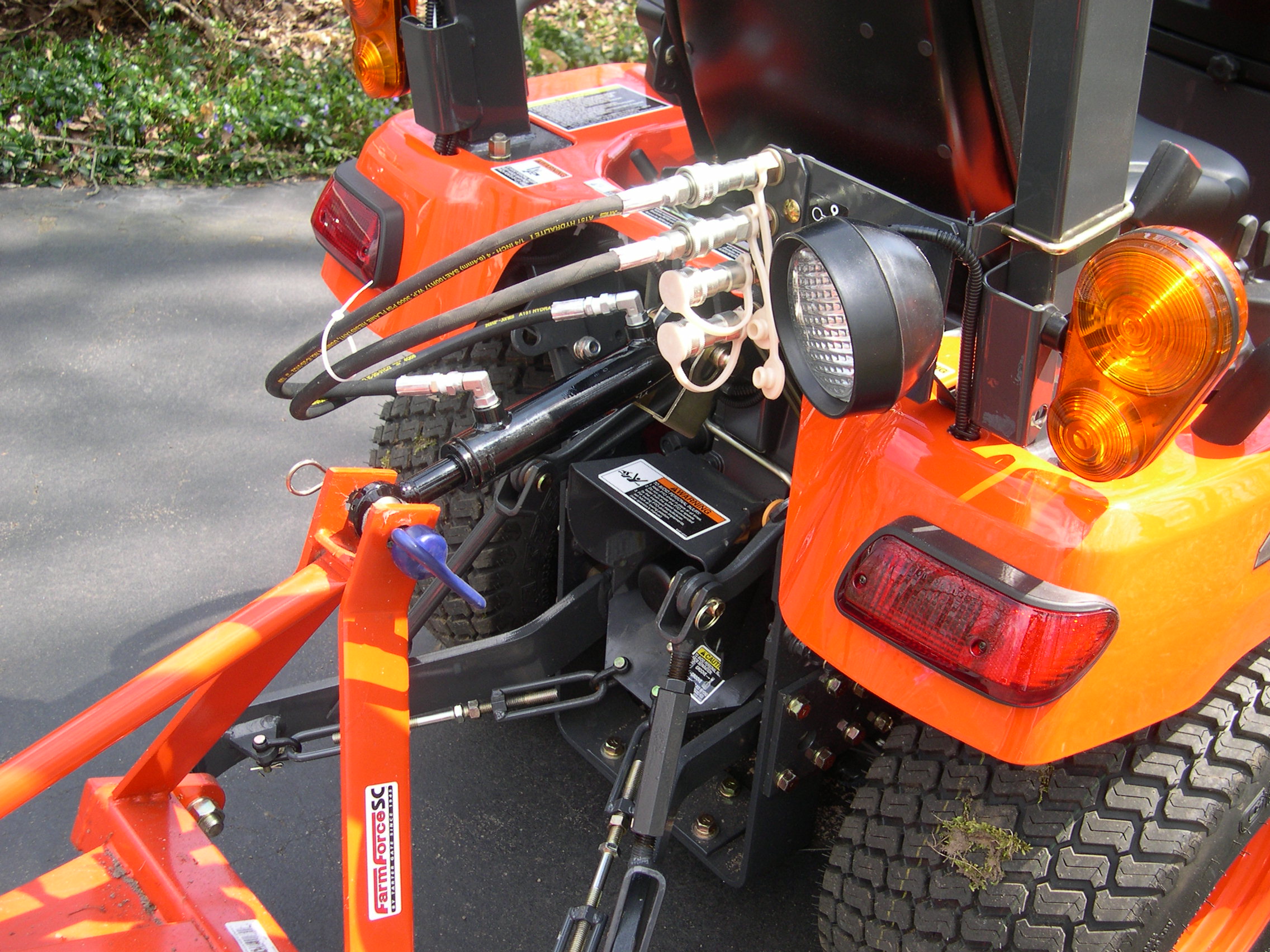

Here's a pic of my HTL
Edit: Oops I see you have a B so I'm not sure if you have the MMM control knob like the BX's
