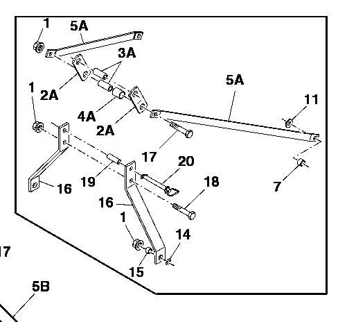

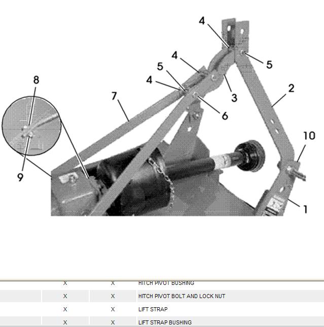

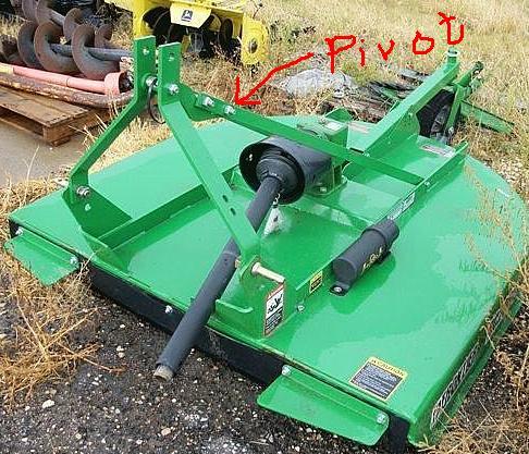

Here is a pic of the RC2060 Frontier that shows the tension straps going midway to the steel frame on the deck, and the "hinge" bracket that flexes (folds) behind where the top iMatch hook fits on the rigid A frame. Might just see to it that the bolt at the hinge is not too tight for easy flexing.
To operate, lengthen the top arm of the 3 ph out so the rear RC wheel always runs on the ground when cutting. The rear wheel then only picks up when the 3 ph is raised high for travel. Also shows the parts breakdown of the folding hinge seen in the pic.

Looks like that forward pin (not the aft pin that hinges) would really limit travel going down across a dip or backing up a slope (as Beenthere's picture in a previous post shows).
This is where that floating link (shown in the Land Pride manual I linked to) really shines. There is considerable float in both directions (cresting a hill as well as down and up a dip)...just as if the tractor's top link was hitched directly to the upper floating bracket.
However, there is a provision for the same kind of linkage (on the Deere QH) if you hook to those holes above the top hook to the corresponding holes on the cutter's A frame. I wonder if Deere has such a link (I wasn't told about and kind of link when I bought my QH. So, if Rad1956 needs more travel (float), he'll probably have to fabricate the link or do the chain thing.

I'll help you out a little more on the pivot point, which is the aft pin. See the pic below from jdparts for the RC2060. #6 is the pivot pin. ;)

With my Dad's 3720 when i hook up to his MX6 I have to get off the tractor and hold the A frame forward on the mower and operate the lift lever at the same time while off the tractor. It isn't my favorite way to do it but proper safety precautions are implemented to this procedure. It appears that your rotary cutter is similar to the MX but it looks like it can hold the A frame forward a bit more. To gain the tilt ability so you can back up to those steep inclined banks then chains are the way to go since the tilt is limited on your rotary cutter as it sits. I know that a chain for the top link would work too but I'm not sure that it would be the safest way to gain the desired tilt angle.
Item 3 is Deere's version of a floating link...but as described in my post #17, travel is limited by #4 pin. You wouldn't back up a slope or go through a dip with this geometry. (BTW, with the Land Pride cutter's floating link, I don't think you could back up a slope quite as steep as Beenthere's chains arrangement...but it'd be pretty close. There's one place in the field I mow that has an embankment I back up...I'll have to see how steep it actually is (meaning a picture to compare to Beenthere's)
