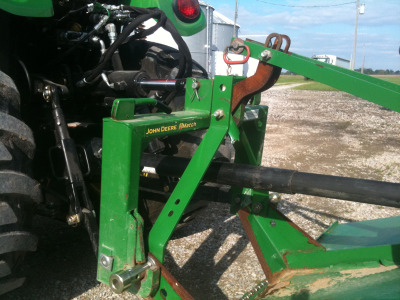

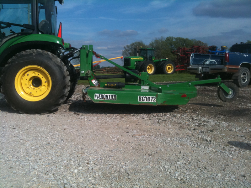

I got a few pics of this set up... Almost no drop, but looks as if it would have enough lift to get the shaft into the top of the quick coupler.

Those pics show the function of the "joint" very well. Shows where it pivots, and how it will hold the frame upright for connection to the iMatch. Then how the pivot slides in the slots to allow the front pin to ramp up and fold the joint upwards. Thanks for the pics.
I like the big boom hoist holding up the cutter with the big hook in the middle pic. :D
   / Hooking up a Rotary Mower to a JD Quick Hitch #30
Actually, I just set the tail wheel up on a drop deck semi trailer, the cherry picker is about 50' away. Funny how the pic turned out that way.
