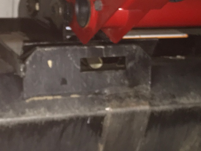

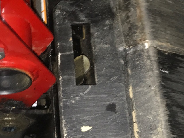

Okay I took a couple of pictures.
   / Hooking up Attachments, Quick Connect #12
You may have the same problem I had when I bought my ssqa. The large bolt that the handle rides on was loose and was turning when I moved the handle, I had to put heavy duty thread locker on that bolt and install the bolt until it was snug for it work like it should.
   / Hooking up Attachments, Quick Connect #13
That's kind of hard to see in those pictures, a bad angle, but it looks like for sure the pins aren't dropping far enough down. I don't think that your SSQA lever is fully locking down. As others have said, you have to catch the attachment on the top channels and then roll the bucket back and maybe (carefully) kind of bounce things around a bit. There are issues with different attachments fitting various loader SSQAs, so maybe this is one of those? I know that there was a service bulletin for Kioti NXs late last year. I'd check with your local Kioti dealer if any of that could apply in your case.
