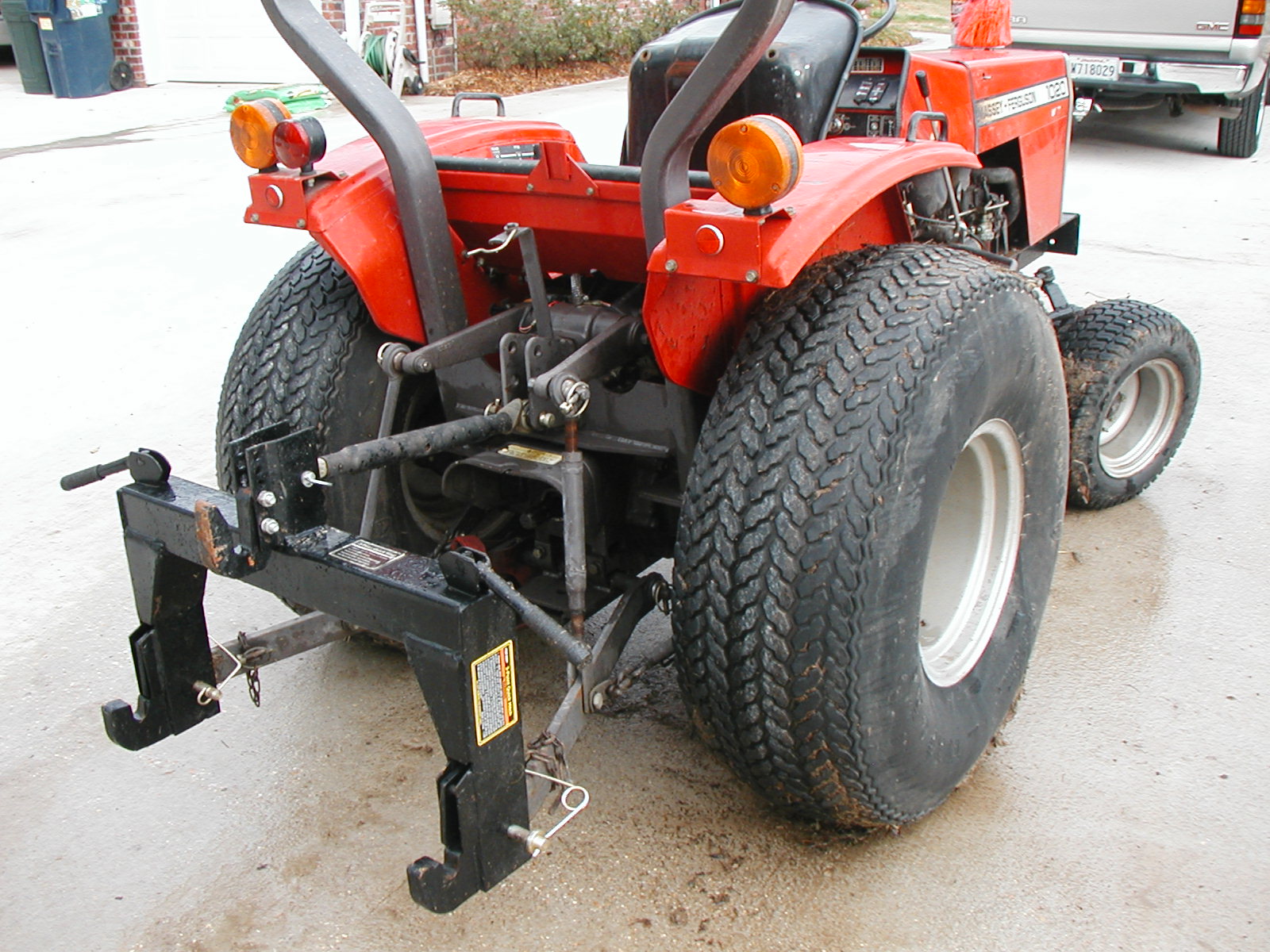

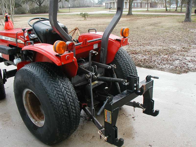

I've got the $70.00 version from HF. I had it on my 2N, and now I have it on my MF. My equip. isn't real big but I'm real old and it"s been a lifesaver.
You just back up until you can catch the top link pin with the hook on the hitch. Lift the empliment slightly, and the bottom pins slide right into the bottom latches. It takes a little adjusting the 1st time, but only once. Pic attached.

Danny....my adjustable ball ends are too short. To be able to use the pats quick hitch, I'd have to release the locks. Then they would not lock again until they ran out of adjustment/bottom out. That would put the ball ends and pats quick hitch around 8 inchs further back. My top link would not work then on most of my implements. Thats why I'd like to take the adjustable ball end off and machine a adjustable quick hitch and put it in place of the adjustable ball ends. My dealer told me to not use the ball ends all the way out using a ground engaugment implement like a plow. He said there is not enough area for support. And that they would bend. By the way, I'm about 1/2 inch short of being able to use the pats quick hitch in the lock position.

dannyb said:
LetsRoll; Unless I'm missing your point entirely, your concept is already utilized in Pat's Easy Change System.
As for Pat's System - I have it on my Massey 241... Works pretty good for standard size/built equipment (Cat I). For other equipment that's not standard, it's still can "hook-up" somewhat like a conventional ball and pin...
Only draw back I ran into was the extra length (about 4 inches), which extended my existing top link to the max... Finding an extra long top link wasn't all that easy and was relatively pricey when I did find one (Tractor Supply).. Further, I also bought/made/built a hydraulic toplink about that time... Finding a "stock" hydro top link with adequate extend length (approximately 34" needed) proved rather difficult. I finally acquired a Cat II and converted it - thus the "bought/made/built...
Still, as for the Easy Change System - - - It's still on my tractor and I plan for it to stay - works pretty well for me...
