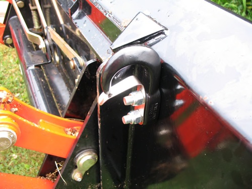

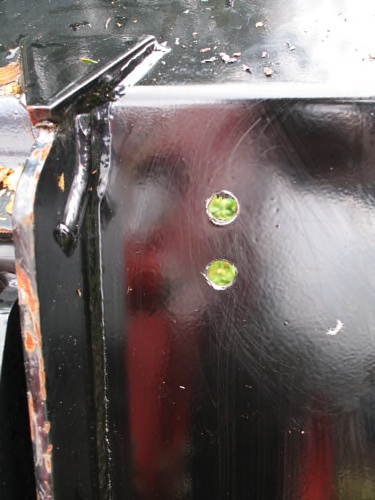

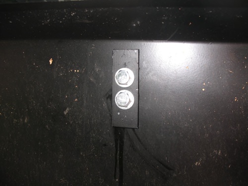

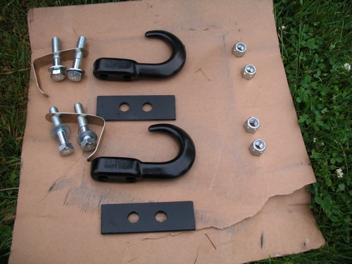

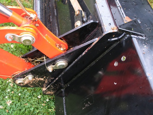

I added a set of hooks to the bucket. I tried to get them as close to loader arms as possible in terms of alignment.
I backed the bolts with a plate and reversed the bolts/nuts - nut outside. I figured this arrangement would see less rusting and marking of bolt threads.

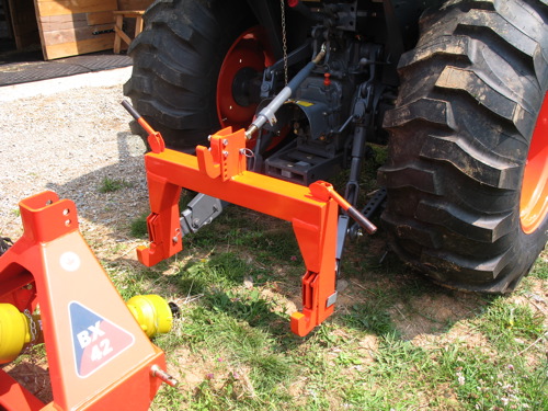

I will be adding an angle iron strip along the top of the bucket to weld some other hooks and a receiver.
The quick attach was red but I quickly changed that.
Chevy engine orange and Canadian Tire Armour Coat gray was a very close match.
Lloyd

I got it from a new jinma dealer in Nova Scotia - found it on Kijiji.
You can order the same one - 27.5" from Northern Freight I believe.
They are chinese made - JD dealer quoted me $310.00 for same product.
Princess Auto had them as well.
Lloyd
