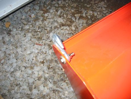

</font><font color="blue" class="small">( Mike - where did you find the bolt-on ones? I didn't see them in the AW Direct catalog.
Thanks, -Norm )</font>
They're standard CJ Jeep hooks, any offroad store will have them.

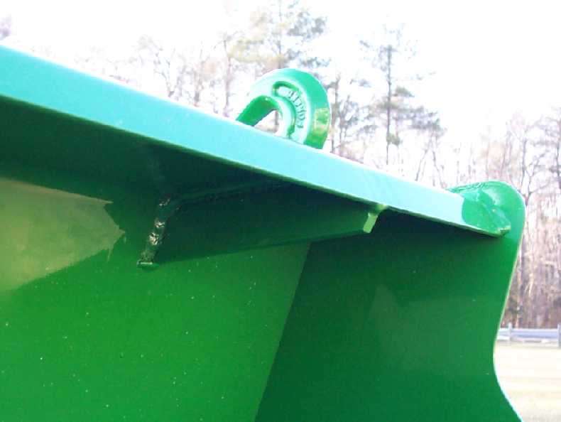

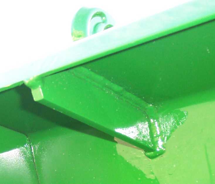

I'm getting a Kubota B7610 w/ LA352 FEL. I want to add 3 hooks. The dealer says they just weld them on with no reinforcment. This bucket, along with others iin the Kubota BX and B series, has a U shaped "lip" where the hooks would normally be weleded. To picture this, look at a bucket from the side and follow the top of the bucket to the front edge. After reaching the edge it curls up about 1" and then back about 1", I think this design probably helps keep the top edge of the FEL from buckling, while allowing for thinner plating in this part of the FEL. However, it appears to be too flimsy to attach a hook to. Has anyone added reinforcement to this type of bucket before welding on hooks. I'm thinking just a 1" wide strip along the top edge of the lip.

Second... I have hooks welded to the top of my HD bucket and LOVE them, they just grab the chain (grab hook?). What would one weld these on with? My Lincoln 135 won't do it; would a heavier mig unit? I know a stick unit would. Just wondering since I brought this question to a local welding retailer, along with hooks as an example of the type of stuff I would like to do, and they told me to step up to a bigger MIG unit, and not to bother with stick. Cost aside, would MIG weld something like this securely? I use my hooks very much, and for heavy stuff. I realize I need a hook in the center of the bucket, and have to repair some stuff beyond the little 120V mig unit's capability. Thanks.

Hey, if a bucket hook is welded on to your bucket "around the corner", the weld does not have to be real strong. It can even be bolted on. The 90 Deg. turn reduces the stress on the weld and the hook by probably 30-40%. So a flux core MIG weld is just fine for that purpose.
