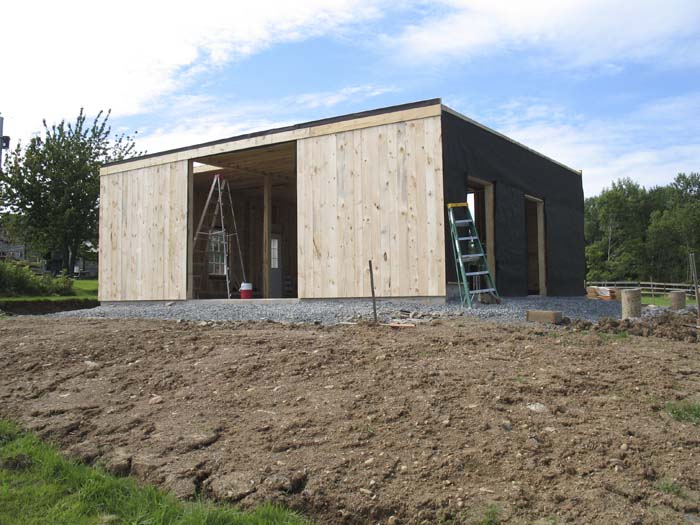

This is the start of our horse barn project. Overall size is 50'x26.5'. Main part of building is 30'x26.5'. There will be two side sheds - 10'x26.5'. One will house hay and shavings until the new tractor arrives. The other shed is actually a roof over the run-in area for the horses. They will be able to run in/out of stalls at their leisure. Barn will have metal roof with light panels and board and batten siding. We will be putting two zones for radiant heat. One will be for the tack room while the other will be for remaining area - for future use. If the horses go I will have a heated workshop.
Soundguy...you can see in the background some of the fencing i have started based on discussion last year regarding preservative. I have almost 3 acres fenced with 4x4 posts/1x6x16' boards - 3 rails plus a cap rail.
Concrete will be poured this weekend or first of week. 6" slab with perimeter curbs.
Will update as we progress. I have booked two weeks (vacation - Ha!) with carpenter. We will have 90% of the barn completed. I will do the stalls in the fall along with slidng doors etc.
Image 1 & 2 shows road and site prep.
Lloyd

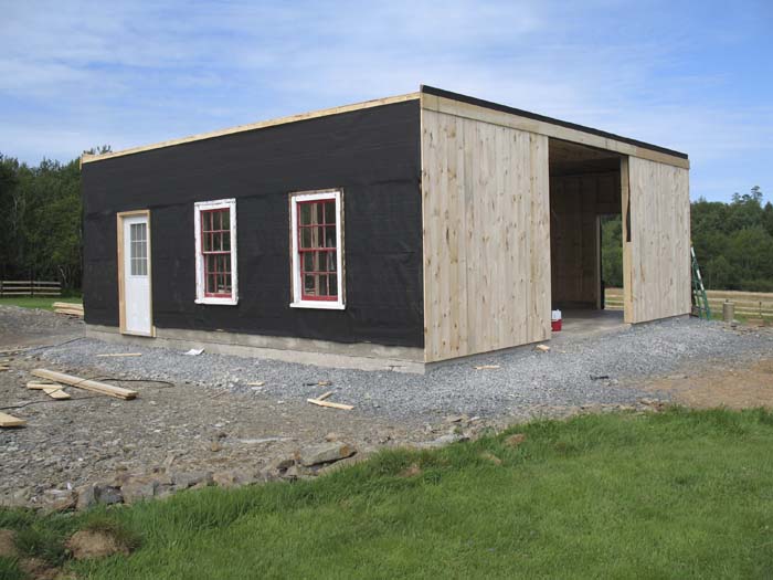

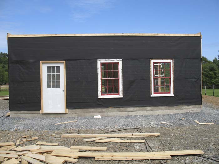

Day 1 Monday:
Day started at 8 and by 3 PM we had all the walls up.
10'x10' double doors gable ends, 1 ped door, 3 windows plus 2 stall doors framed. 2x6 contructions, double sill plates and double top plates.
Day 2 Tuesday: Completed walls and second floor. Will post pictures later.

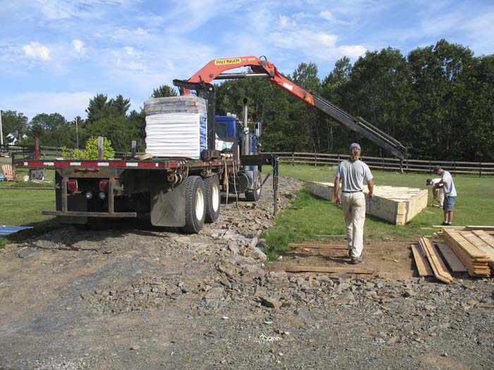

We had one of the worse thunder storms last night to date (with the exception of the one that hit an oak tree in the back pasture). The following pics do not do it justice. It lasted almost 3 hours. We would just think it finally ended and it would roll back in off the bay.
Tomorrow we do board and battens, windows and man door. Friday is a day off for crew. Trusses will arrive tomorrow. When the metal roof arrives Monday we will use the boom truck to position trusses on deck. We are still aiming for mid-week, end of week finish next week with exception of sliding doors, tack room and stalls. They will be my fall and winter projects.

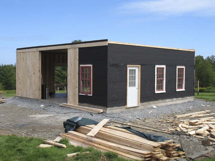

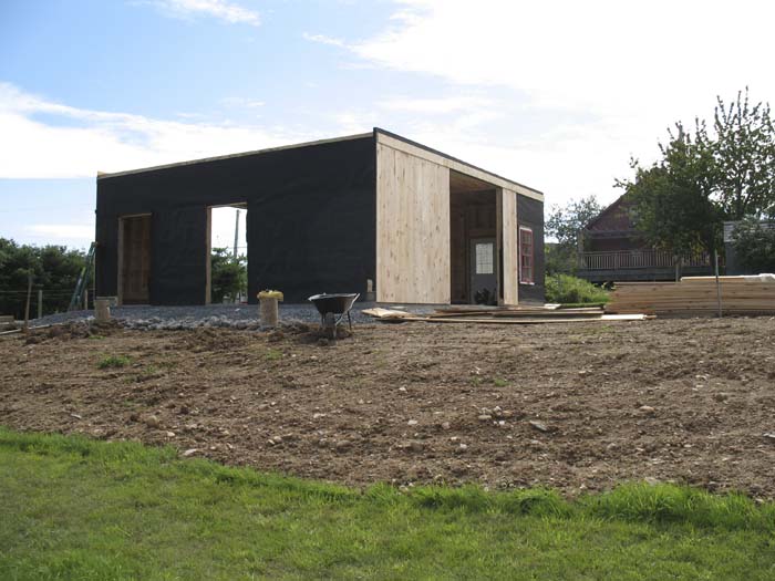

/ Horse Barn Project

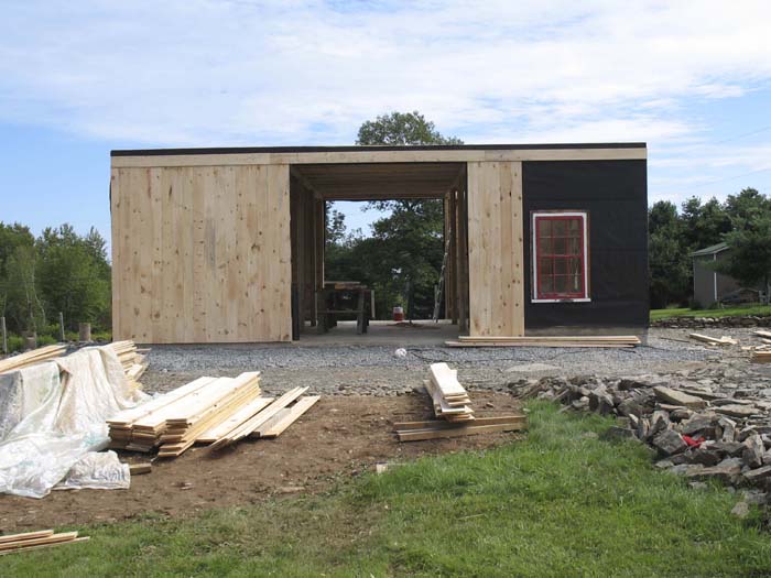

Boarding In:
Yesterday we finished boarding in and laid second story floor.
Today we are working on exterior board and batten.
We will install vertical boards and let them dry out a bit over the weekend before putting on battens.
Ped doors and windows will go in today.
Lloyd

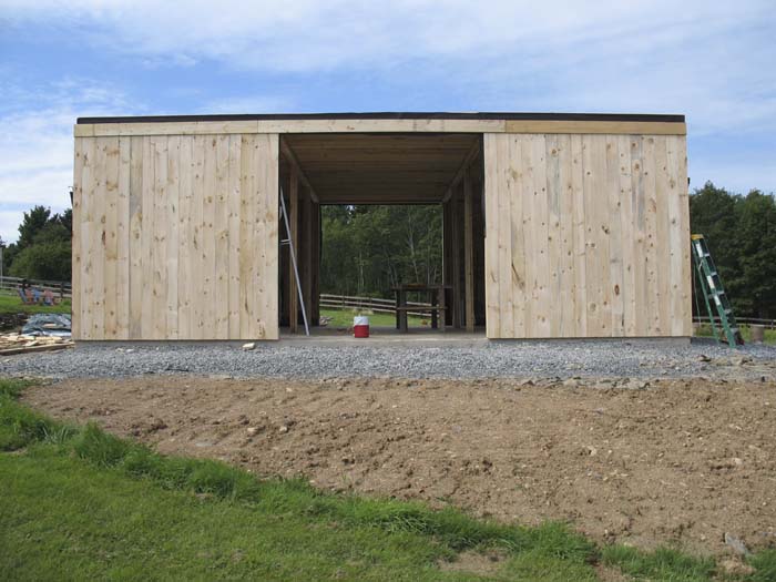

#11

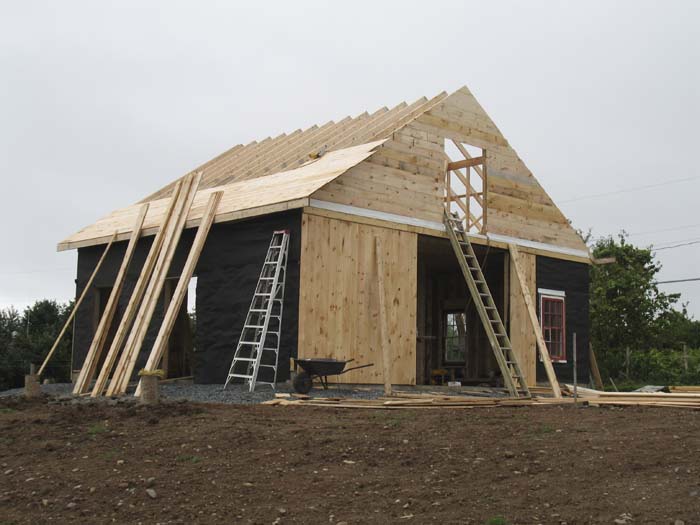

Stopped early today due to heat. Plus we have to wait for trusses to arrive, which will be tomorrow and metal roof on Monday. We are a little bit ahead of schedule.
Pics show vertical boarding plus a few windows. Windows have to be scrapped, primed and painted and a few pieces of class to be replaced. They are recycled from a 18th century house. I will be starting to build sliding double doors on the weekend. Each door is 10'2" tall x 5'6" wide with a transom window (individual lights) 1'x4' in each door.
Lloyd

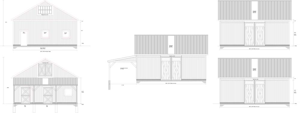

Nop to the knee wall. Scissor trusses will sit on top plate. We will have centre aisle upstairs for storage plus space between trusses. The plan is to come off side with 26.5'x10' shed. This will hold hay and shavings. I have two other buildings for storage - which are filling fast.
See attached. The side roof will cover run-in for stalls. We will mirror this on opposite side fore storage on a slab. May start slab in fall - depending on budget. We are slightly under budget now...

The last posted drawings have changed a bit. We turned the roof 90 degrees so the gable is over the sliding doors. This will allow an upstairs door for moving things off the truck/trailer. Also, there will be less rain coming off roof in the direction of the doors (which evestrough would fix). Although I prefer the look of gables on the end (short side) I think this will work out better in the long run.

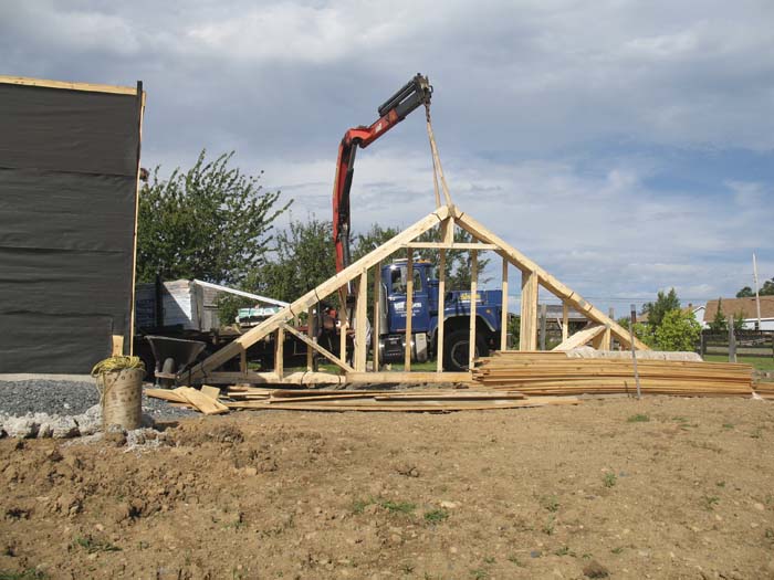

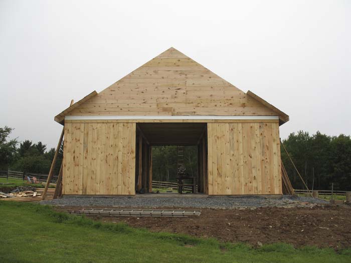

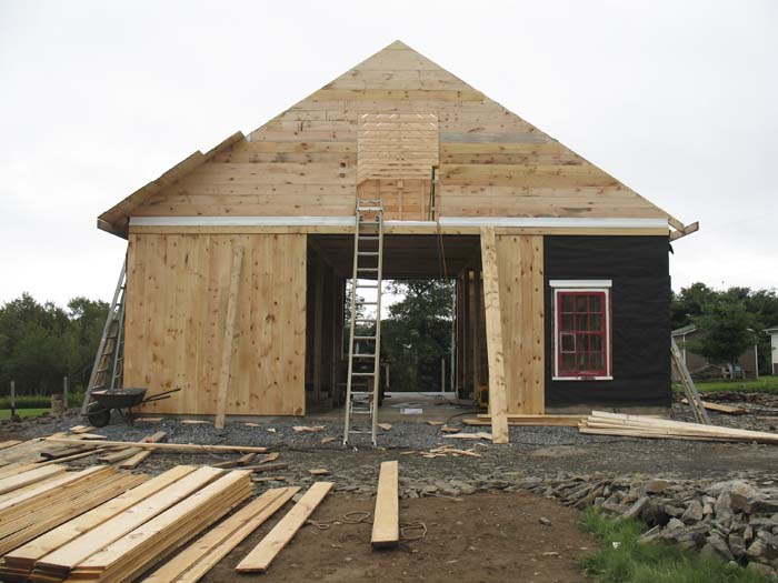

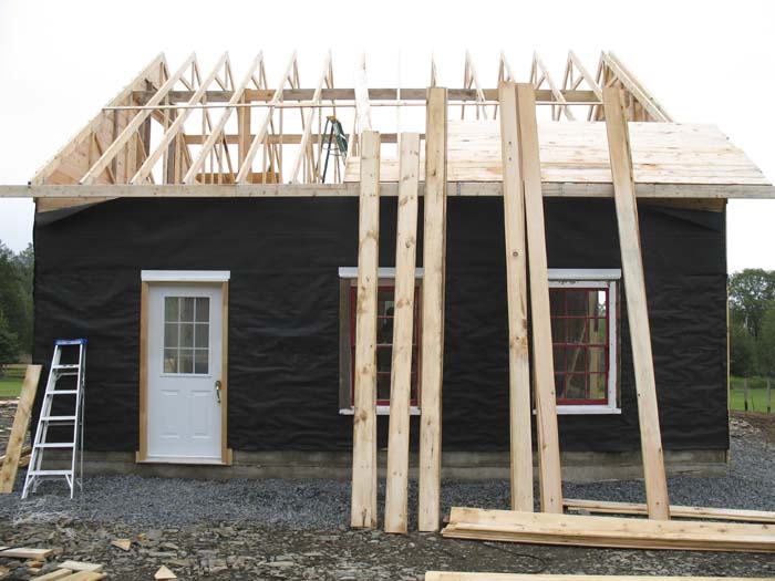

Been busy too - have not had a chance to file photos. Tomorrow is the last day for contractor. I booked him for two weeks - 100 hours. We are actually only into about 60 hours. We are 90% complete. I will be finishing inside stalls, doors etc.
Tomorrow we will finish stairs to second floor and finish gable ends with boards. I will be installing all the battens. Depending on where we land with the budget he may be back to install roof over stall run-ins.
Lloyd

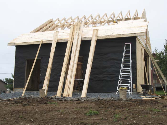

Trusses and roof boarding-in.
Over roof boards we layed tar paper and installed metal roof over top.

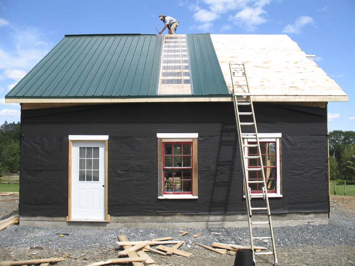

Metal Roof:
Metal roof is on. In frame #5 you see the truss on the right side of sky light. We will be installing a 2x6 to mirror truss so it looks symetrical.
