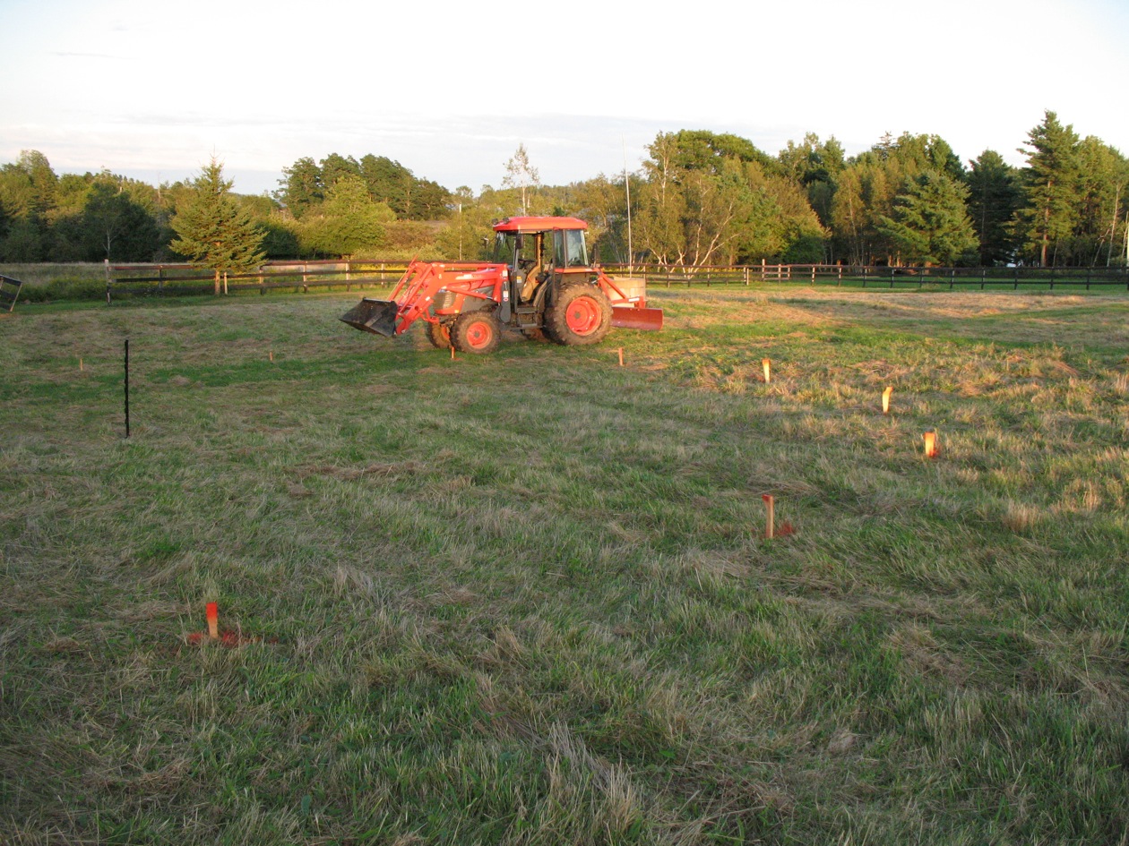

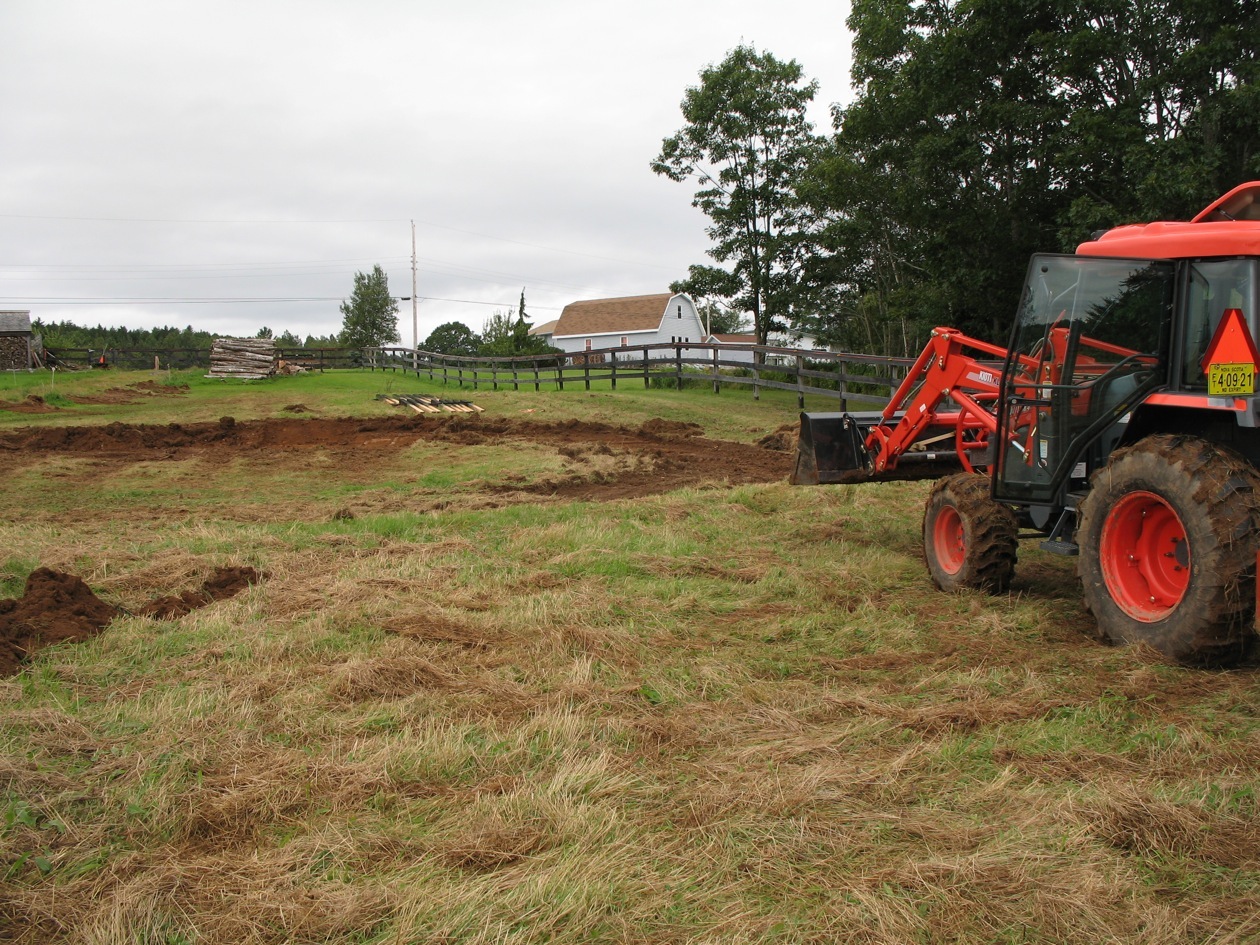

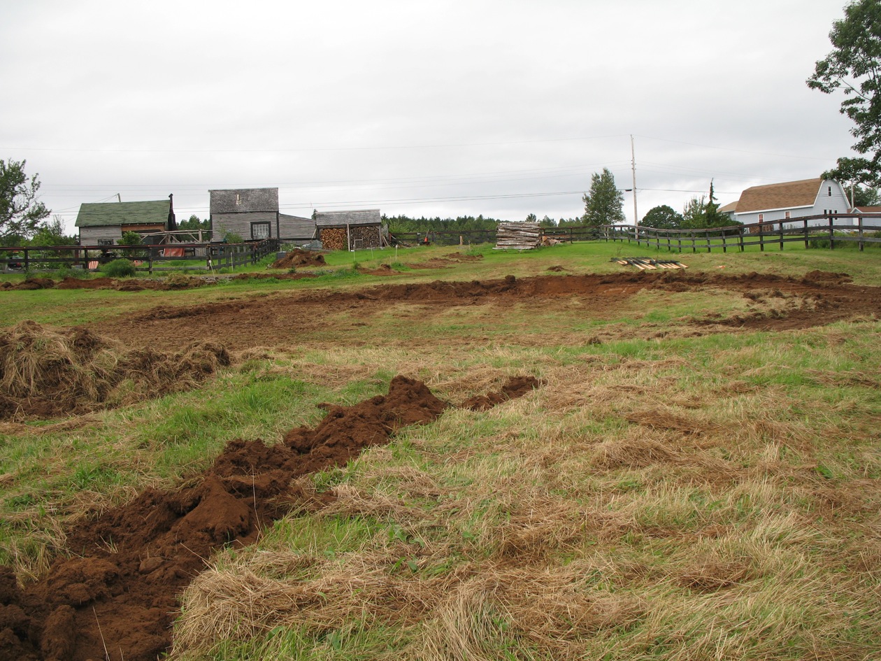

Some pics are attached:
59 - shows stakes in place
61 - show stakes in place different angle
63 - is first pass with blade - useless
05 - show many passes with box blade and the slope.
Once the sod is broken up I will remove material with loader to get to grade faster.

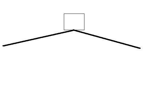

I have always used round posts in a round pen. I have wondered how well you could nail boards to a square post at that angle.
/ Horse Round Pen #9
I've used rounds, half rounds, oblongs ( landscape timbers ) and 4x4.. as long as you are using a 3" nail, it all works fine.. I'f I'm being real picky.. I cut the board ends at an angle so that they mesh at the 'V' instead of leaving a void on the back side..

Just finished 5.5 hours of seat time. Used loader to cut into bank and box blade to level. I am about 90% there and the misses will probably note the other 10%!
When it comes time to set the posts and rails I will be using an air nailer with 3" ring nails.
This should hold and hopefully the ten foot span/angle will not create too much space behind the post and rails.
24 yards of sand will arrive in the morning. I will spread and level and than do posts. Rails will arrive next week. I have a bunch of 16' rails but I don't want to cut them to ten feet.
Lloyd
