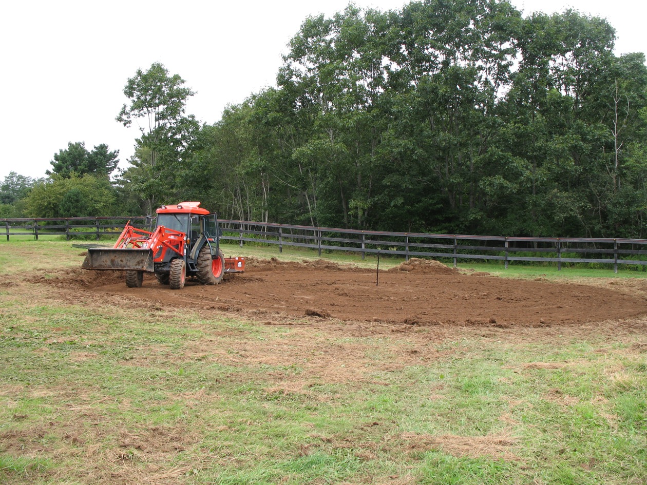

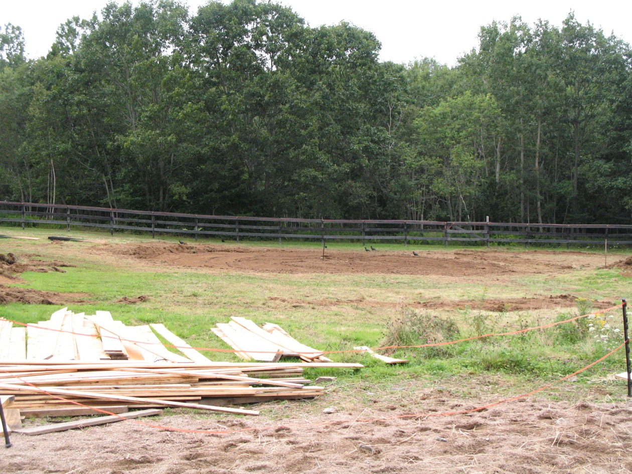

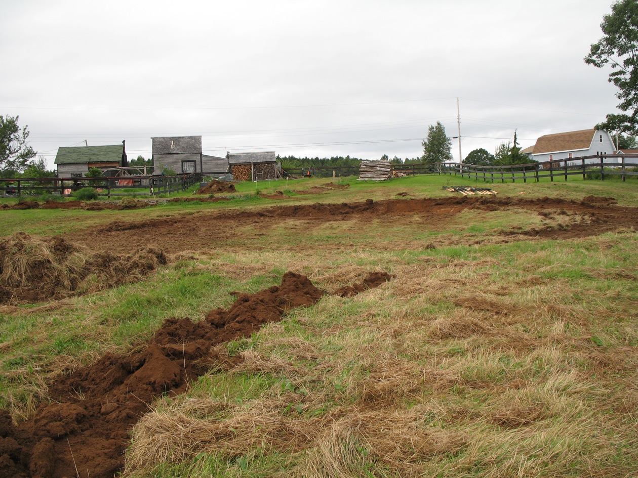

Just finished 5.5 hours of seat time. Used loader to cut into bank and box blade to level. I am about 90% there and the misses will probably note the other 10%!
When it comes time to set the posts and rails I will be using an air nailer with 3" ring nails.
This should hold and hopefully the ten foot span/angle will not create too much space behind the post and rails.
24 yards of sand will arrive in the morning. I will spread and level and than do posts. Rails will arrive next week. I have a bunch of 16' rails but I don't want to cut them to ten feet.
Lloyd

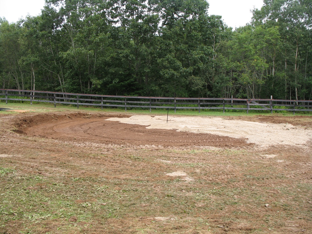

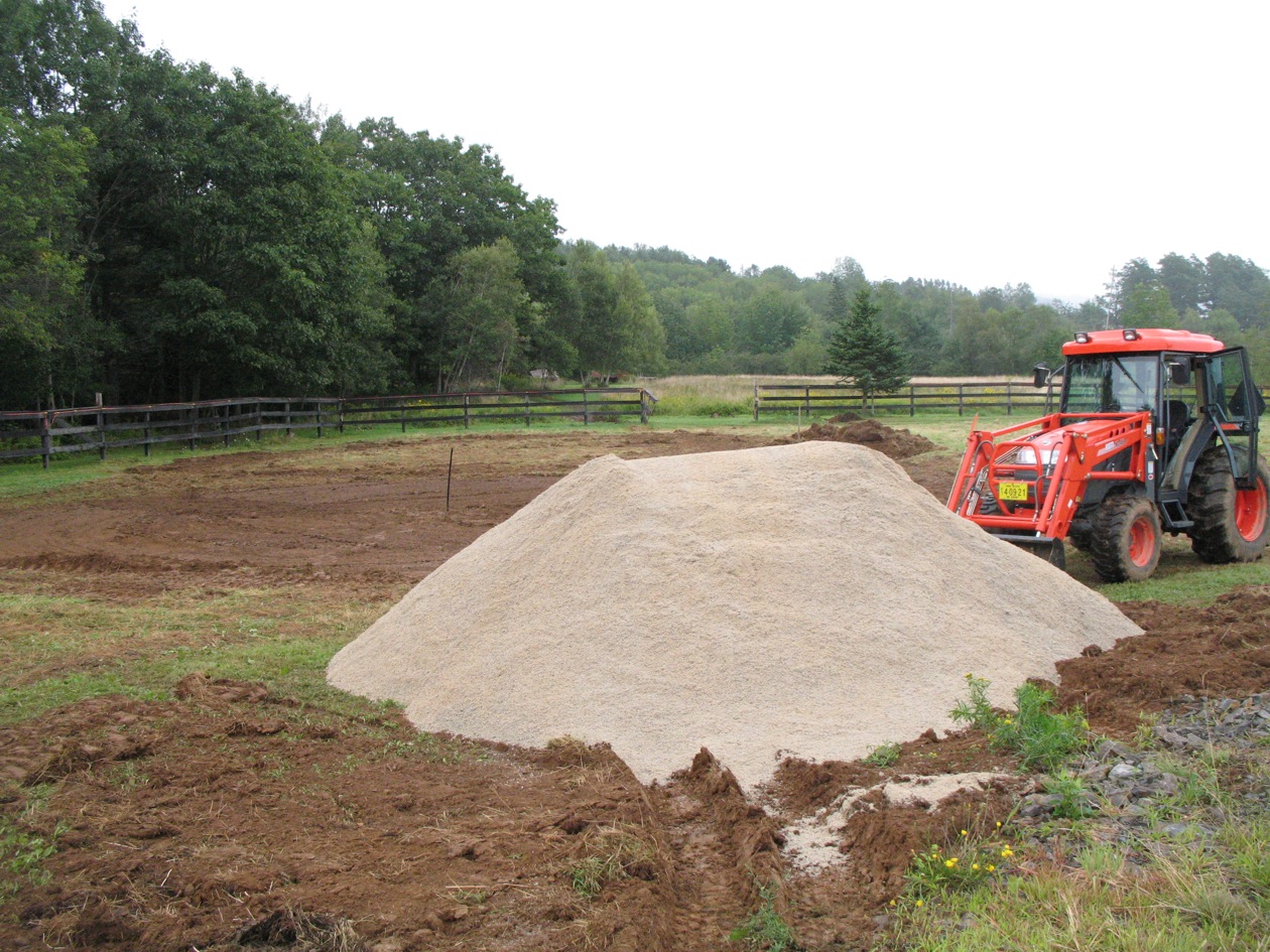

A few more pics... slow going.

Lloyd - looks good i finished my roundpen this summer (2nd one actually) and had quite a slope, i pulled alot of dirt, mostly with my box scraper to level it. in order to keep the water off of it i added a french drain on the high side and built a rock wall to keep things in place. i decided to use the corral panels that lock together so if i need to, i can move them to get my tractor in. i still haven't gotten the right footing in though - started with hogfuel which was a waste of money, so i'm going to put sand in before winter but first i must do some more leveling. overall i'm pretty happy with it and more importantly my wife is too - she's the one that uses it! here is my post, you can get an idea of the wall from the pics i posted..

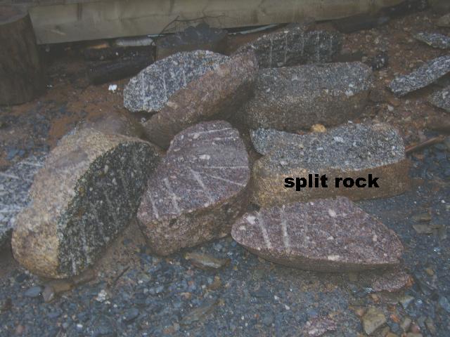

Lloyd: All you need is a drill and some feathers and wedges. Then you have life time of rocks at hand.:D:D:D

...and time. A lot of time.
Also, if you drill and fill with water and cork with wood plug - when they freeze they will split too. So I am told. I will try a couple...have to make the wedges first.
