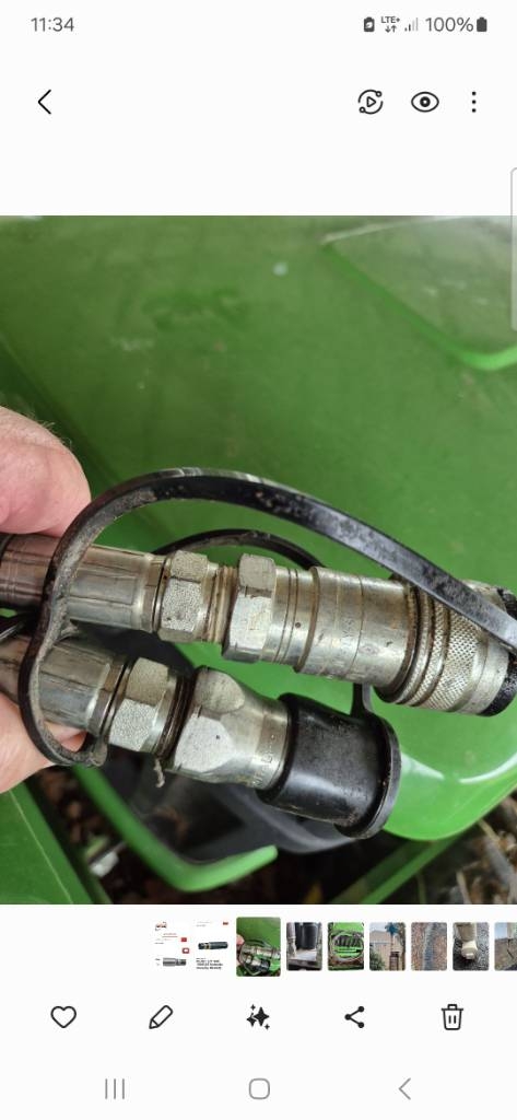

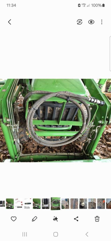

A few years ago I put front hydraulics on for a grapple that works but I want to make it better, hoses get damaged, etc.

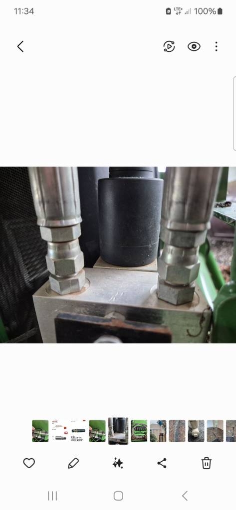

I was thinking couplers on the control block, then two new 6ft hoses coupler each end. Then attach hoses when needed.
Discount Hydraulics sent me this but how do I crimp connectors to hoses, or is there a better solution like pre-made hoses?
