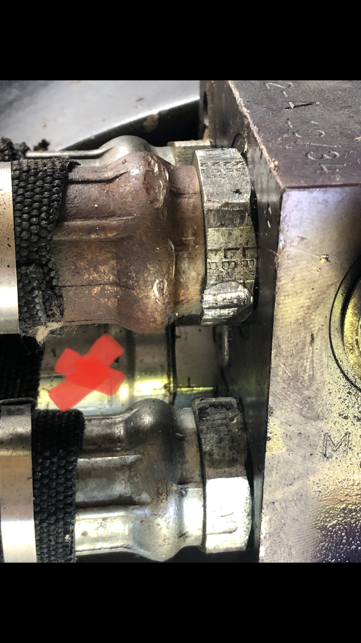

The hose that I’ve partially rounded the nut off is actually a good hose, so I don’t want to ruin it (any more) if possible. .
The hose that’s leaking is on the inside bottom, and the only way to get that hose off is to take the other three hoses off first so that I can get a wrench on it.

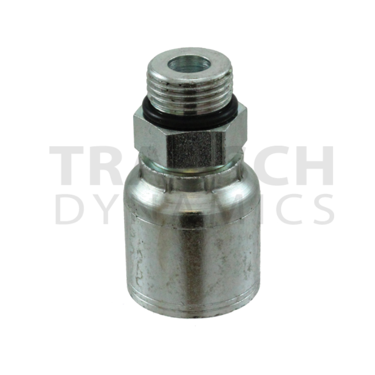

By the time you get that hose off intact, if you even can, it won't be worth reusing IMO. Spend the money on a new one instead of more tools. Cut it, as in post #10. If there is enough slack in the hose, have a new fitting pressed on. If not, use one of these:

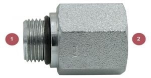

As others have said, the fitting is likely an O-ring type rather than NPT, which has a taper. The nut portion of the fitting should not be in contact with the hydraulic block as all the hoses are in your pic.

Don't those fittings have an o-ring on them? If that is the case, they don't have to be super tight.
That sure looks like an ORB/SAE fitting, so there should be an o-ring. If there isn't, and you tightened it enough to stop it from leaking, that is the real issue here.
That is the type of fitting I thought it had when I first looked at it. If it is leaking, it is an o-ring issue and shouldn't be over tightened.

That darkness you see around the nut is not a squeezed o-ring. It’s just darkness. I can’t get a clear close up picture, but the nut is actually flared back slightly where each flat side meets, thus creating that dark spot.
That hose that I’ve been trying to get off first is not leaking. The hose that has the leak is the one in the picture below with the red x. That is a new hose that I put on two years ago. The problem is that I have to remove the other three hoses first in order to get at the hise that is leaking.

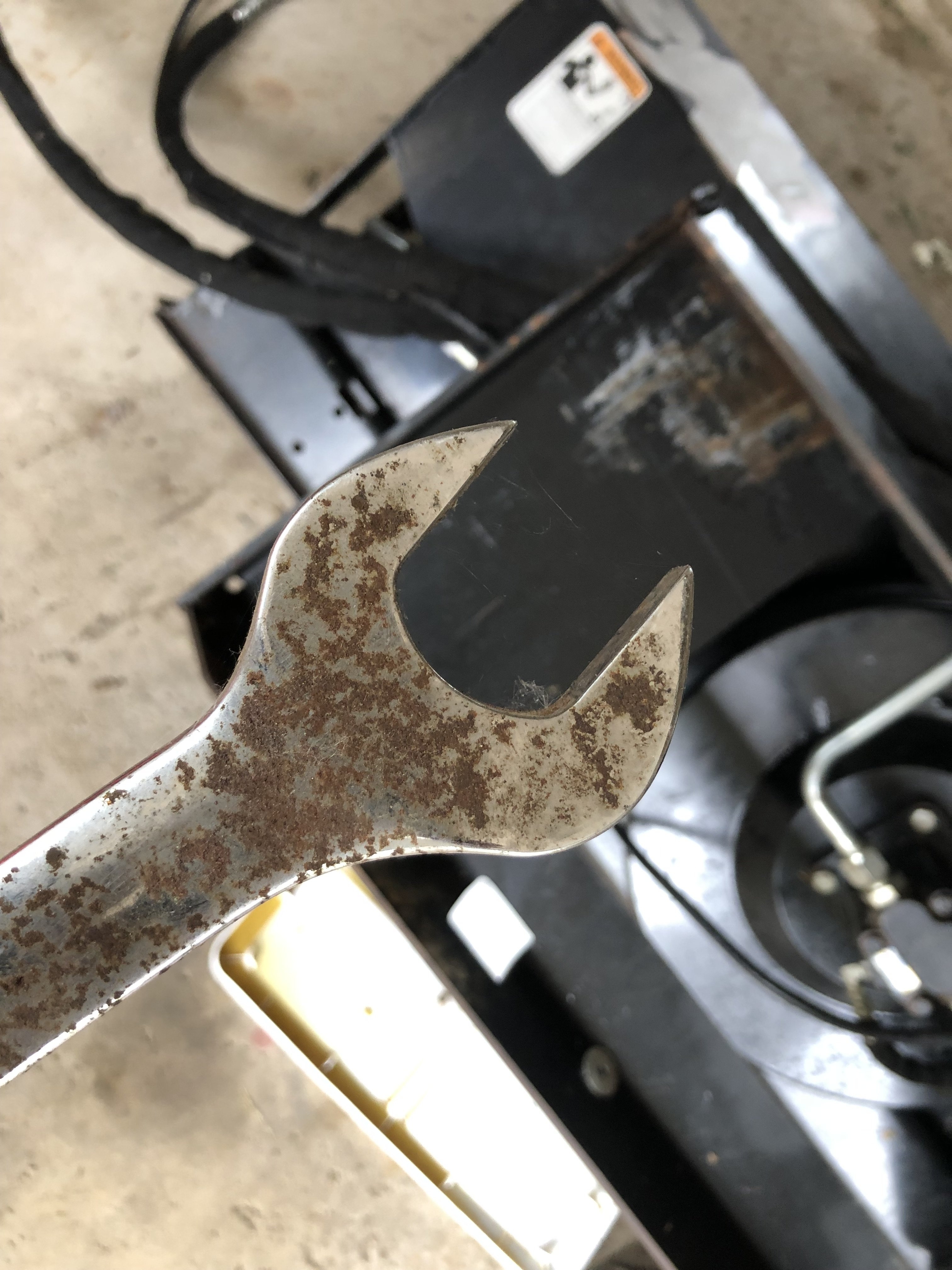

The wrench that I have used successfully two times before is this open ended basic crescent wrench

I believe that your photo above is the Open End of a Combination Wrench. Usually the other end is ring shaped and closed and is called the Box End - usually both ends will fit the same size fastening....though not always. As you have found, there is no way that the box end of a combination wrench can get into position to fit onto that nut..... for all the same reasons that a socket wrench won't either.
A crescent wrench is a general term for an adjustable wrench - so called because the Crescent Company popularized them by making a lot of that style adjustable wrench. Don't use a crescent wrench for this. They are for being handy, but not for applying a lot of force. It will slip and ruin the nut.
You are doing the right thing by using the open end of a combination wrench. If you look a few, you will see that the open ends do come in a variety of open end thicknesses. You want one that is as thick as the nut or even a bit more so. Then you can try hitting the end of the combination wrench with a "dead blow" hammer. Don't overdo it. If that doesn't work, the next step is to use a long pipe slipped over the entire free length of the combnation wrench as a torque increasing "cheater". That will loosen it if the wrench doesn't break.

Reading your post gave me an idea. Open ended wrenches at extremis on a hex tend to spread enough to start rounding the nut corners and that small "slippage" quickly worsens the situation as more torque is applied. I think that a small pre mod to the wrench end will allow adding impact torque without adding critical stress to the wrench throat. A small shelf needs to be ground into the outside of one jaw tip - right about where the hex point meets the inside of that jaw. At that point there should still be enough meat in the jaw to accommodate a 1/16" shelf and still be strong. This shelf would be tailored the give secure purchase to a blunted chisel tip.
Now you need a helper to apply significant CCW torque with the wrench while you deliver a sharp tangential blow. It should move.
