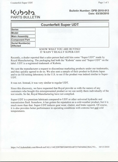

A few years later we found out why in this letter from Corporate Kubota. Warning: it's does not show Corporate Kubota as being very ethical. Quite the opposite. So if your orange hat fits well you might wantto give it a pass.
A few years later, Kubota changed the name from "Super UDT" to "Super UDT2" & swept it all under a rug hoping nobody would notice. If they had simply refunded for the counterfeit Super UDT they sold they could have gotten away with it.
rScotty
Thanks for the information.
However, I don't see that letter as showing Kubota to be unethical at all. Maybe I missed something. It was a 3rd party apparently not associated with Kubota, that did the unethical thing.
Kubota attempted to get a list of customers to contact them and apparently was unsuccessful. No idea how hard they actually tried though.
Maybe there is more to the story?

I think you have the story right. You and I differ on interpretation and maybe that is just a bit of generational or regional bias.
Where I come from, What Kubota did is called "passing the buck". I guess holding that opinion shows that I am both old and old-fashioned - which are all true enough. But it used to be considered unethical for a company to let their customers shoulder an entire problem because of something that manufacturers and suppliers both knew was defective. Obviously both the Kubota Corp and Royal Oil knew what they were doing.
The customer is the only one that is blameless here - which is a claim that neither Kubota nor Royal Oil can make - although both are trying.
Kubota could have contacted the customers themselves - that's what I would have expected an ethical company to do when they knew they were selling a defective product. Regardless of whether they did it deliberately or not. They have the largest investment and the most to lose or gain. Might as well sieze the moral high ground....
At least they could have offered to refund money for the unopened containers of counterfeit oil they sold.
They refused to do either. Instead preferring profit as being more important than ethics and morals.
My conclusion on Kubota is: Nice tractors; despicable corporate ethics.
Or maybe I'm just out of date with my pre-21st century corporate ethics. I'll leave that for readers to decide.
rScotty

Got ya. Yeah, I guess it could be seen as "passing the buck". I the Corporate world of today, it seems a mild faux pas. I'm 76, raised in the NE and do remember when some Corporations would show some "stand up ness" when something was iffy.
I tend to get a bit "lawyer-ly, seeing this as Kubota being informed that "a sales person" (presumably NOT a Kubota sales person, but that is uncertain) had sold "him" (presumably the reporting dealer) oil purporting to be Kubota oil.
It is unclear how hard Kubota tried to find the dealers and end customers that might have been affected and what they would have done about it. Since you mentioned this in the context you did, I presume that letter was pretty much the end of it.
I'll have to search for the B21 oil cooler threads. Thanks for the lead.
