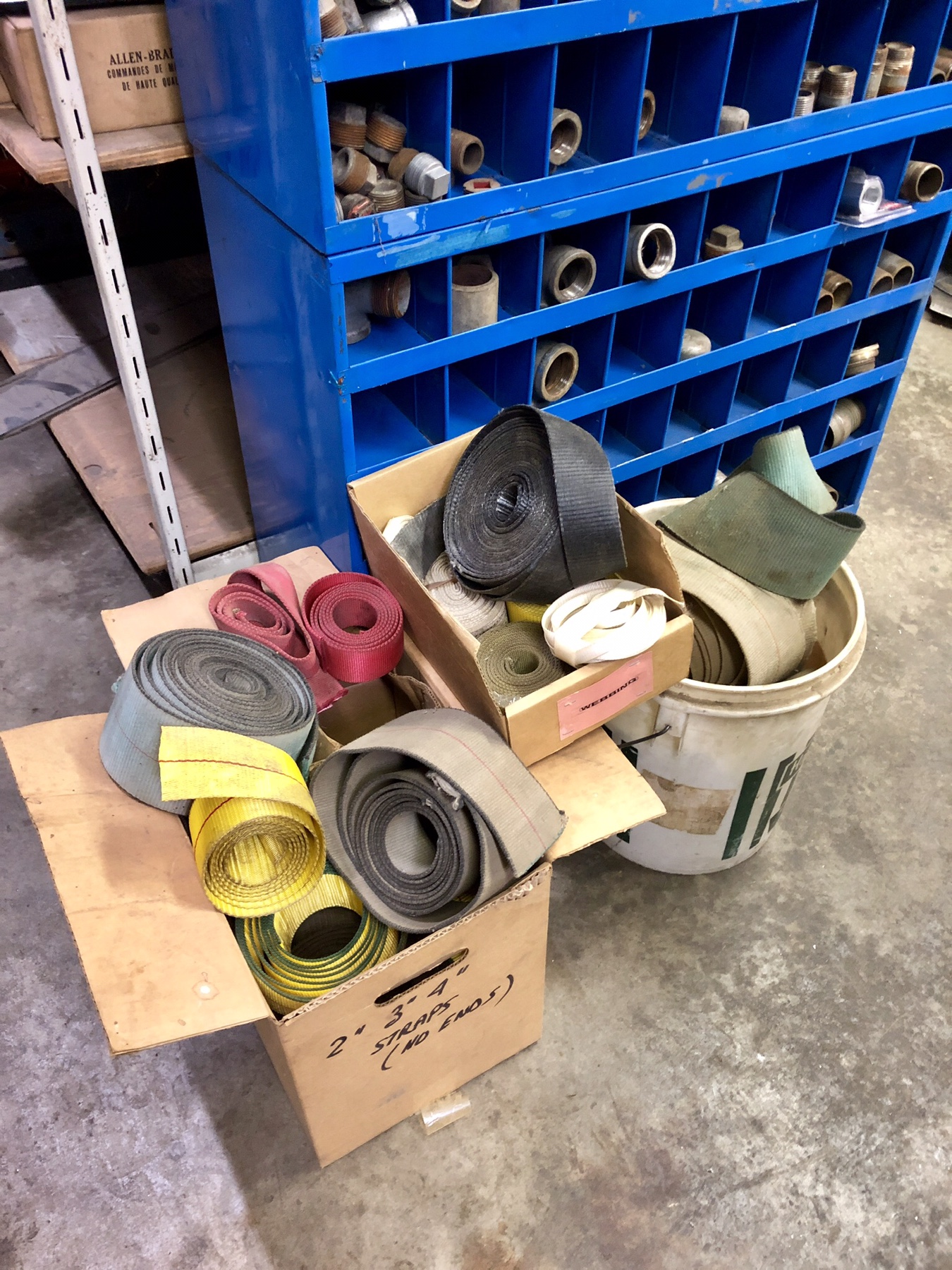

No loss, Sodo. Chop off the heat damaged part and take advantage of the “shorty” for all those occasions you don’t need all that extra length for securing. This may be your ‘go to’ strap!

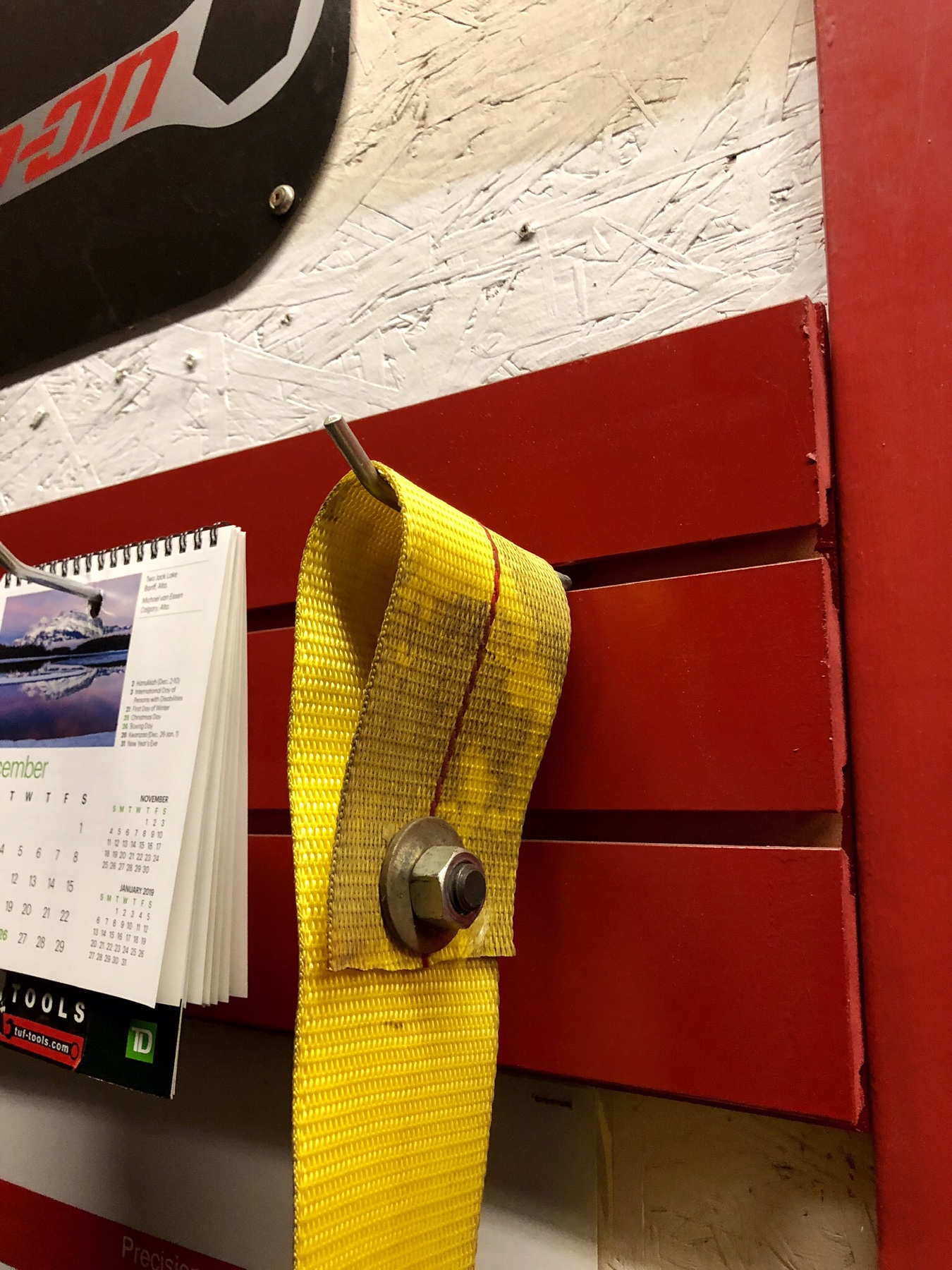

I’ve got boxes of webbing straps I’ve shortened that I keep around for making hinges, hangers etc.
View attachment 584932View attachment 584933
I did a quickie for the second photo with a single bolt as an example for creating the “eye”. Normally for a 3-4” wide strap I would have used two bolts with a full width backing strip on each side. Holes in webbing should be punched as opposed to drilled.
