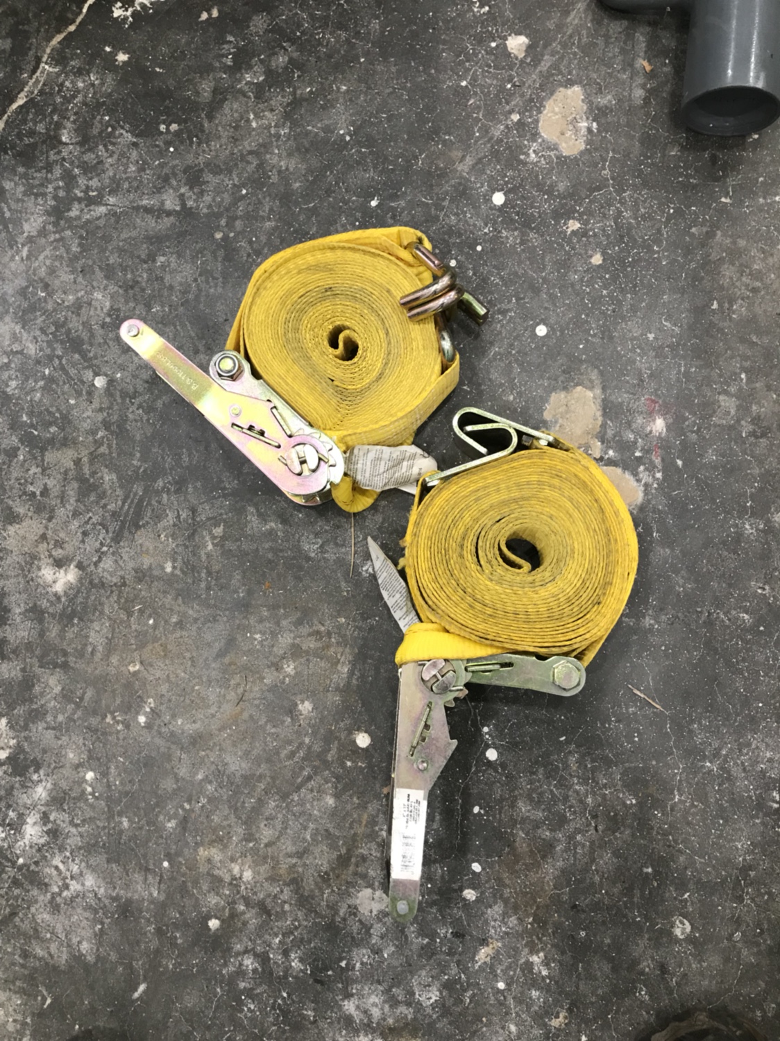

I just buy the ratchet straps with clips instead. They work a lot better on a stake pocket. IMG_0723.JPG
   / Hot-rodding your 2" ratchet straps (beginner weld project) #13
Re: Hot-rodding your 2" ratchet straps (beginner weld project)
Sodo that is a great idea. I've always been frustrated that the hooks wouldn't fit through the 2x4 stake pockets. In the past I've smashed a few of them a little flatter, but it wasn't an easy process.

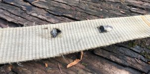

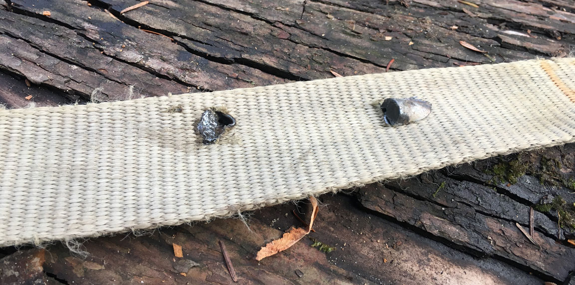

Pay attentiion when you cut the corners off the hooks.
584636d1545881774-hot-rodding-your-2-ratchet-ratchet-strap_hotrod_oops-jpg
Ooops straps just piled on the floor below the vise.....
Red hot steel (the cut-off corner) dropped onto the nylon strap
and melted itself to the strap.

Well, you just trashed that strap.

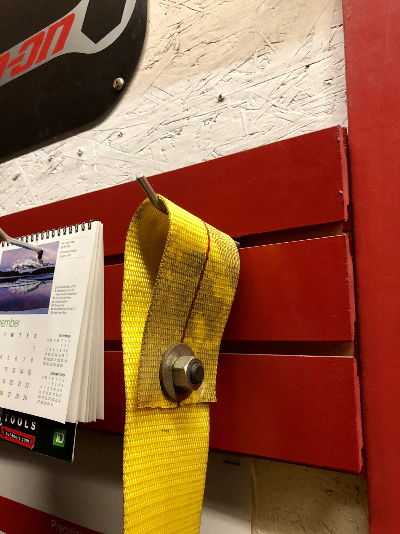

No loss, Sodo. Chop off the heat damaged part and take advantage of the “shorty” for all those occasions you don’t need all that extra length for securing. This may be your ‘go to’ strap!
I’ve got boxes of webbing straps I’ve shortened that I keep around for making hinges, hangers etc.
I did a quickie for the second photo with a single bolt as an example for creating the “eye”. Normally for a 3-4” wide strap I would have used two bolts with a full width backing strip on each side. Holes in webbing should be punched as opposed to drilled.
