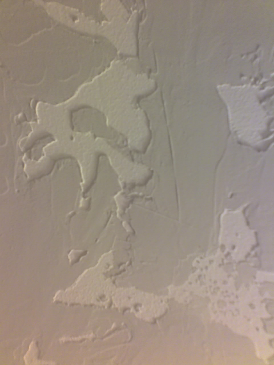

Not sure what it might be called in CA but look at ceiling texture called "stomp and drag" with ceiling painted first and then texture applied. See photo. The white is painted sheetrock and gray is texture on painted ceiling. Good news is if you don't like it paint over. If interested I can give you better description of how it's done. Did it on our house and have yet to hear anyone say they didn't really like it. Picture is with cell phone about one foot from ceiling. Hopefully you can get the idea.

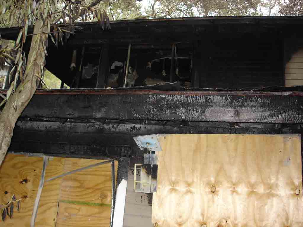

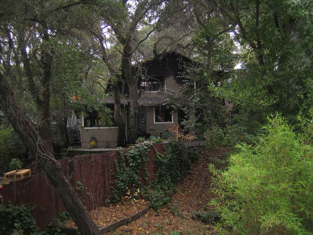

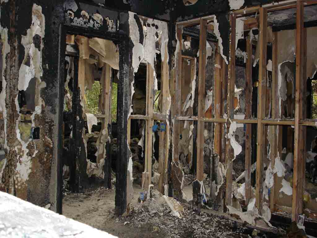

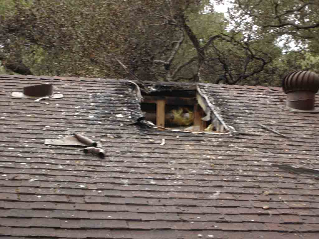

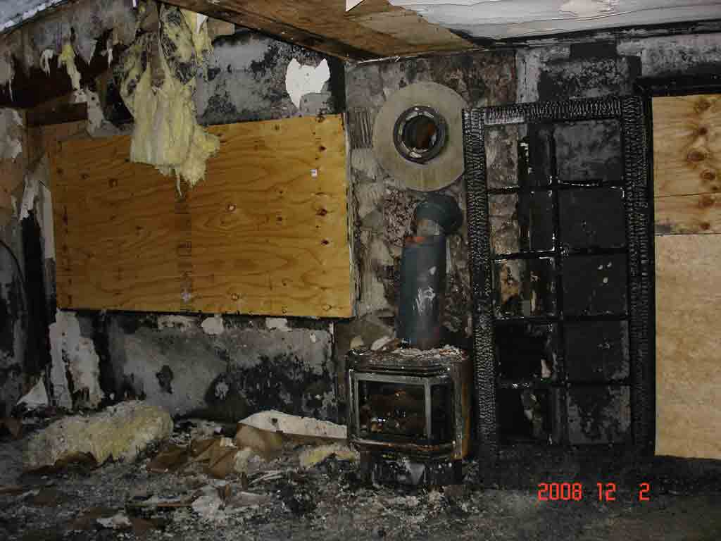

OK, by popular demand here are some photos.
The West Side looks pretty good from a distance, but if you come a little closer and look at the rear skylight you can see how the roof is beyond salvage. The rear with balcony shows how some of the siding has been completely burned away, all the rest, even what looks OK from the outside is damaged on the inside.
The front fascia board is close enough to see what the fire inspector called "alligator char" on it, and 100% of the rafter tails have the same alligator char somewhere on them. Essentially, if there is alligator char the wood is not salvageable.
The gas fireplace shows the massive interior damage downstairs. It doesn't show in the picture, but the panes of glass in the french door next to the fireplace first broke out, and then the fragments left in the door melted. The interior upstairs shows the sheet rock is just plain gone almost everywhere, and even though the wood looks like it might be salvageable, the walls shown are non load bearing partition walls. All the load bearing walls are damaged to some extent, some pretty dramatically.
