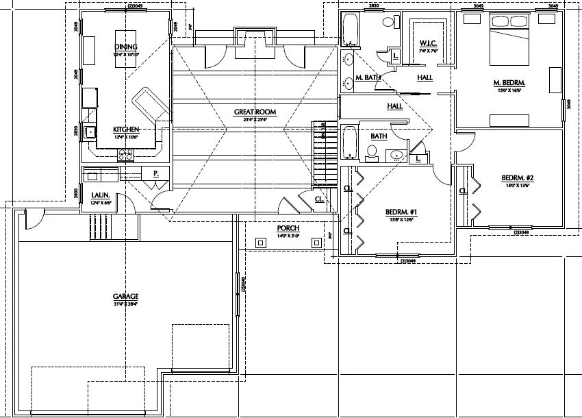

I wonder if anyone who designed a nice floor plan would care to share a simple draft here in the forum? We've been wrestling with designing a new home for our 110 acres and it's been somewhat of a puzzle. I'm looking for a single floor layout, under 3000 sq ft, with a gameroom and attached garage. It seems most of the plans one can pull up online are cookie-cutter and just don't get me too excited.
Here is what w just finished. 1800 sq feet. 2 bath, 3 bedrooms, full 1800 sq ft basement, 3 car garage/shop. We downsized as we are now past kids, etc.
In hindsight, I would have made a few changes:
1) Made the kitchen about 2' wider and longer.
2) Shifted entire bedroom areas (everything off the bedroom side of the great room) 2', creating a dead space where mechanicals could have been run. I ended up having to use some of one bedroom's closet for return air because of the location of beams in the basement. Having that 2' space and running all mechanicals up would have been so much nicer.
3) Basement bilco doors.

tkap - like your plan - thanks much. Care to share a pic of the exterior?
Anyone else with some nice floor plans?
