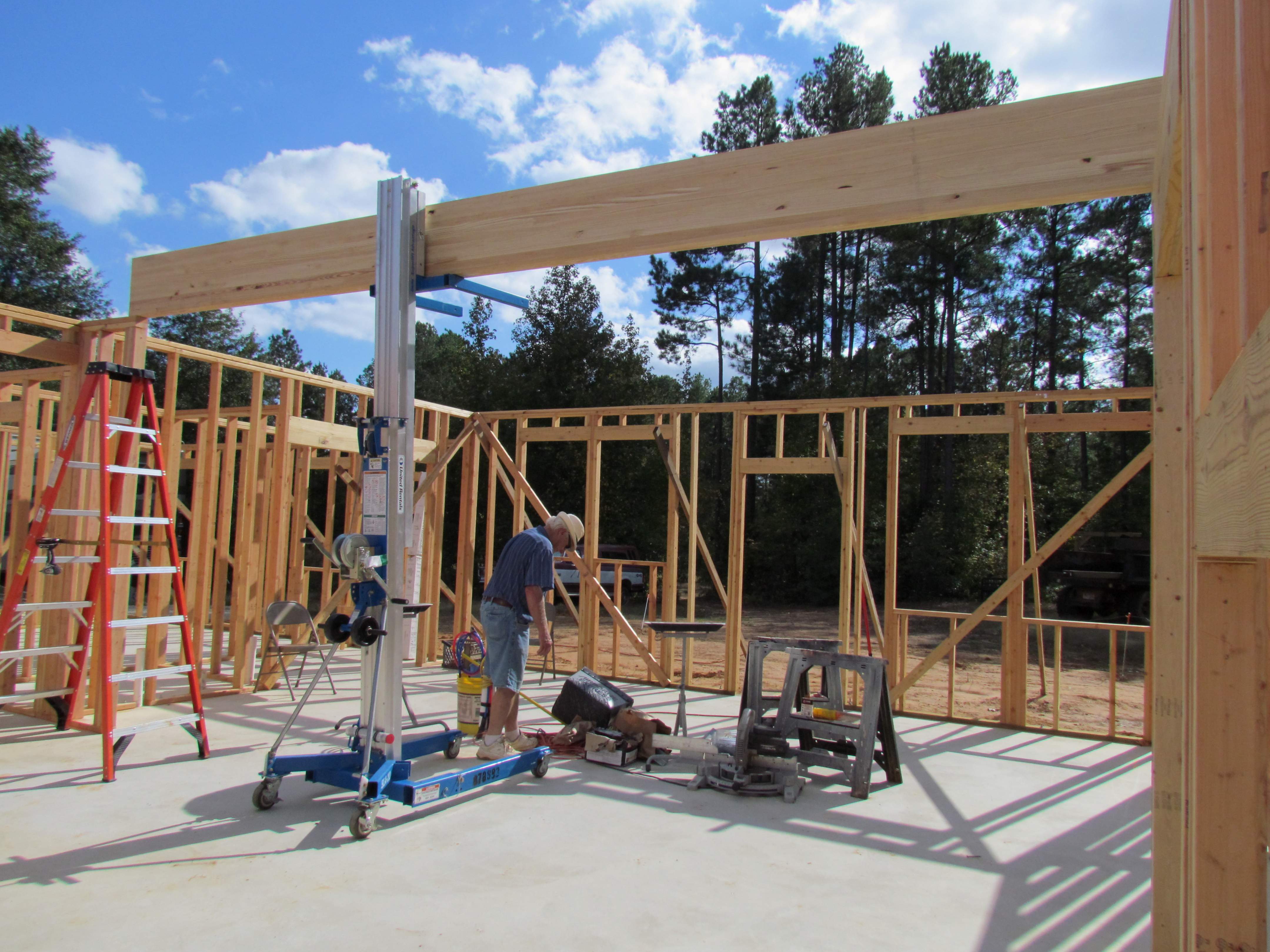

The lumber for the roof was delivered yesterday, so I rented a ten foot lift to get the glulam beam into position. Half day rental was $30 plus tax. It took half an hour with the lift to get it into position, so that was money well spent on the tool rental!!!

   / House for my Parents #128
Nice beam, what are the dimensions and weight of it? Also price , if you would tell. Will it be finished and exposed?
thanks Dave
#129
I'm not sure what the beam costs. They had several in the front of the store when I pulled up for sale that they had taken off of inventory. With those deals, you get what they have and pay what they ask. I was told $100 for it. 3 1/4 x 16 x 20 feet long. That's a fantastic deal, so I paid for it right then and there!!!!
It will be hidden inside the attic. Once the sheetrock goes up and the insulation is sprayed, nobody will ever see it again. Not to worry, I have a couple things going on with the ceilings that should be pretty interesting!!!!!

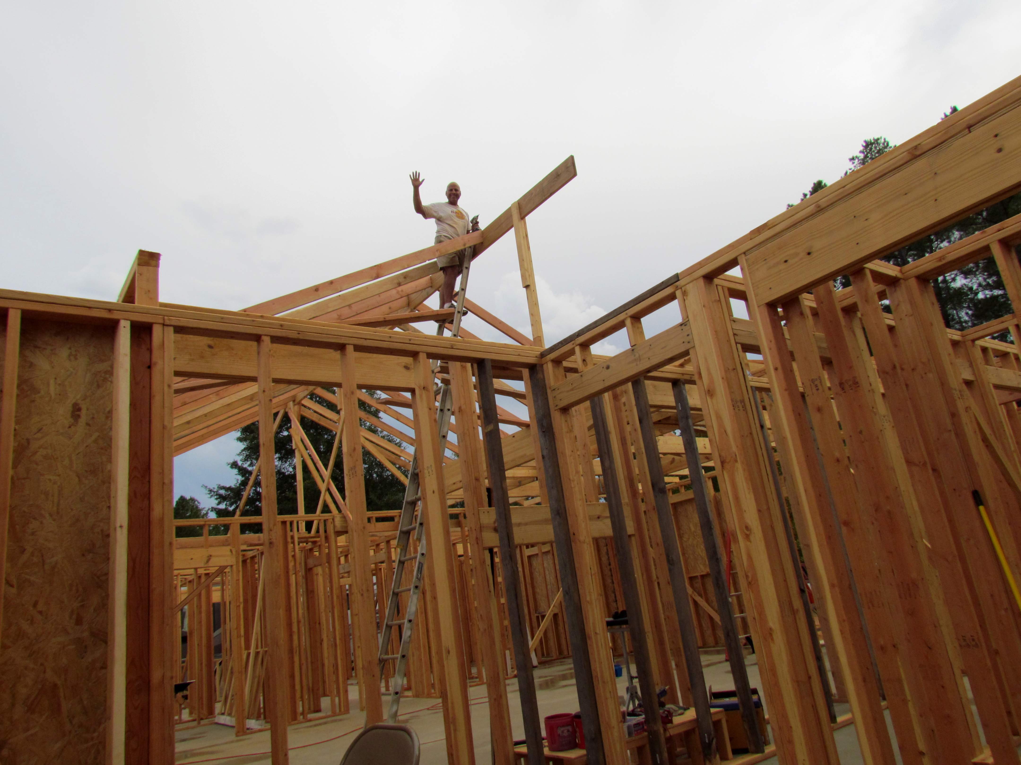

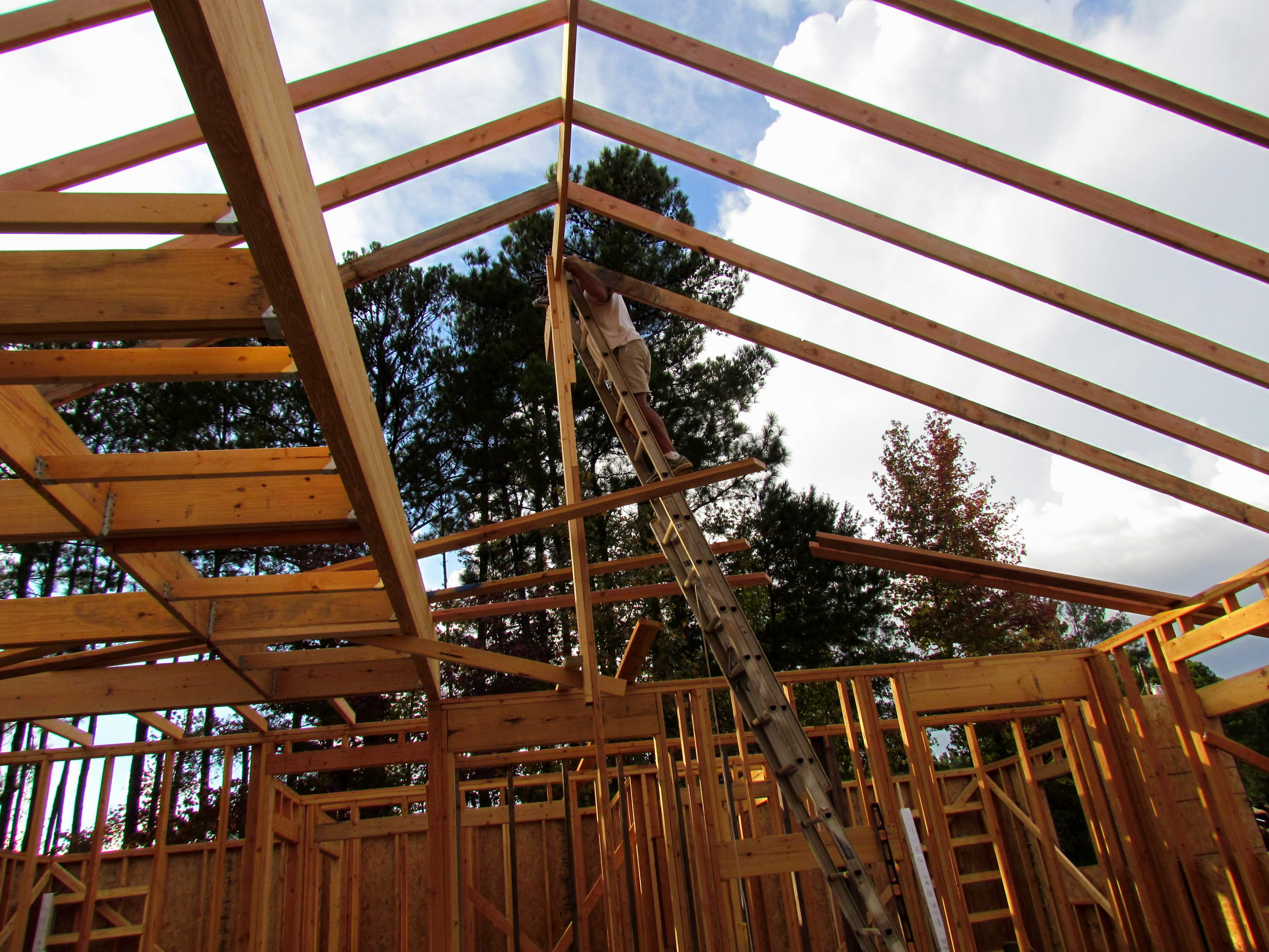

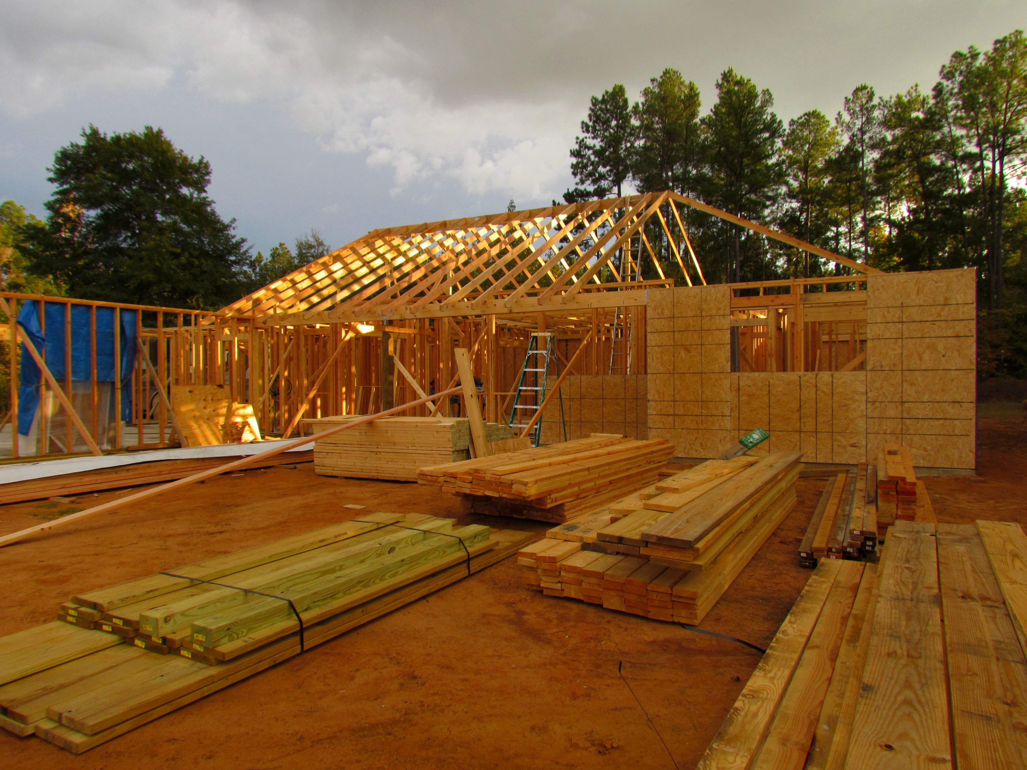

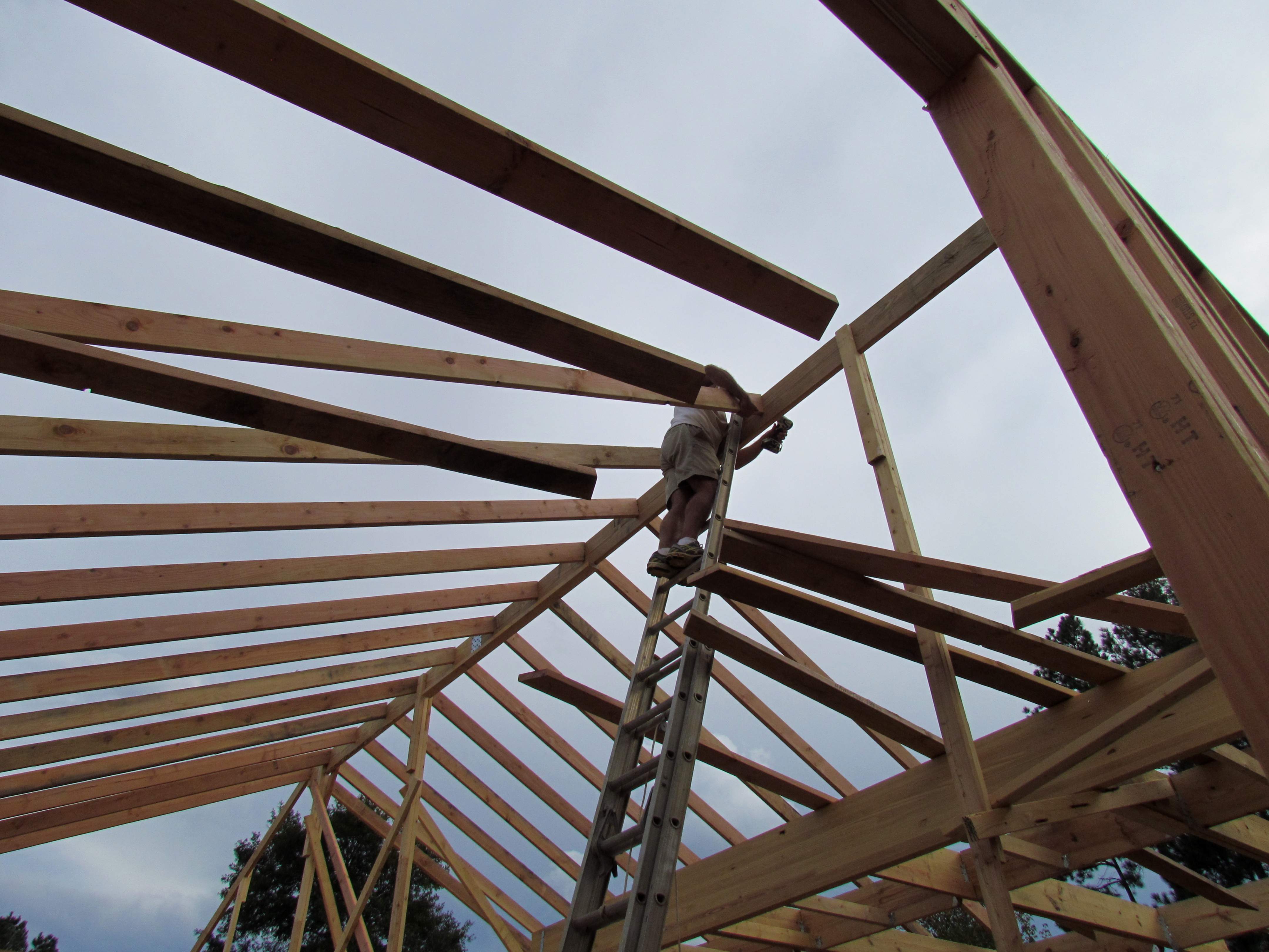

#130
Rafters and more rafters!!!! They never end, and they take forever to cut and install them. While I'm doing that, my parents are installing the OSB on the walls. They work pretty good together as a team, so I try to stay out of their way.
