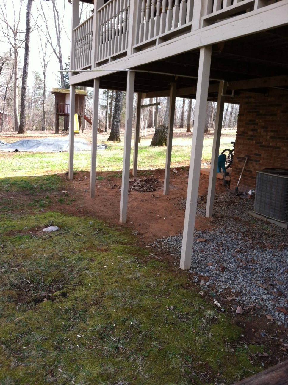

Somewhere in your basement walls, there has to be a drain line coming down from the upstairs plumbing that connects to the waste line to the septic.
Logically--again :D--it should line-up with an upstairs toilet.
The upstairs bathroom is above the bottom but the upstairs toilet is on the wall facing away from the photos and likely drains down that wall as the floor joists run parallel to the leach field. That's an interesting point too. Would there, could there be more than one line to the septic tank or might the upstairs toilet drain connect under the basement floor with the basement toilet.
Man, where are those x-ray glasses when you need them? :D

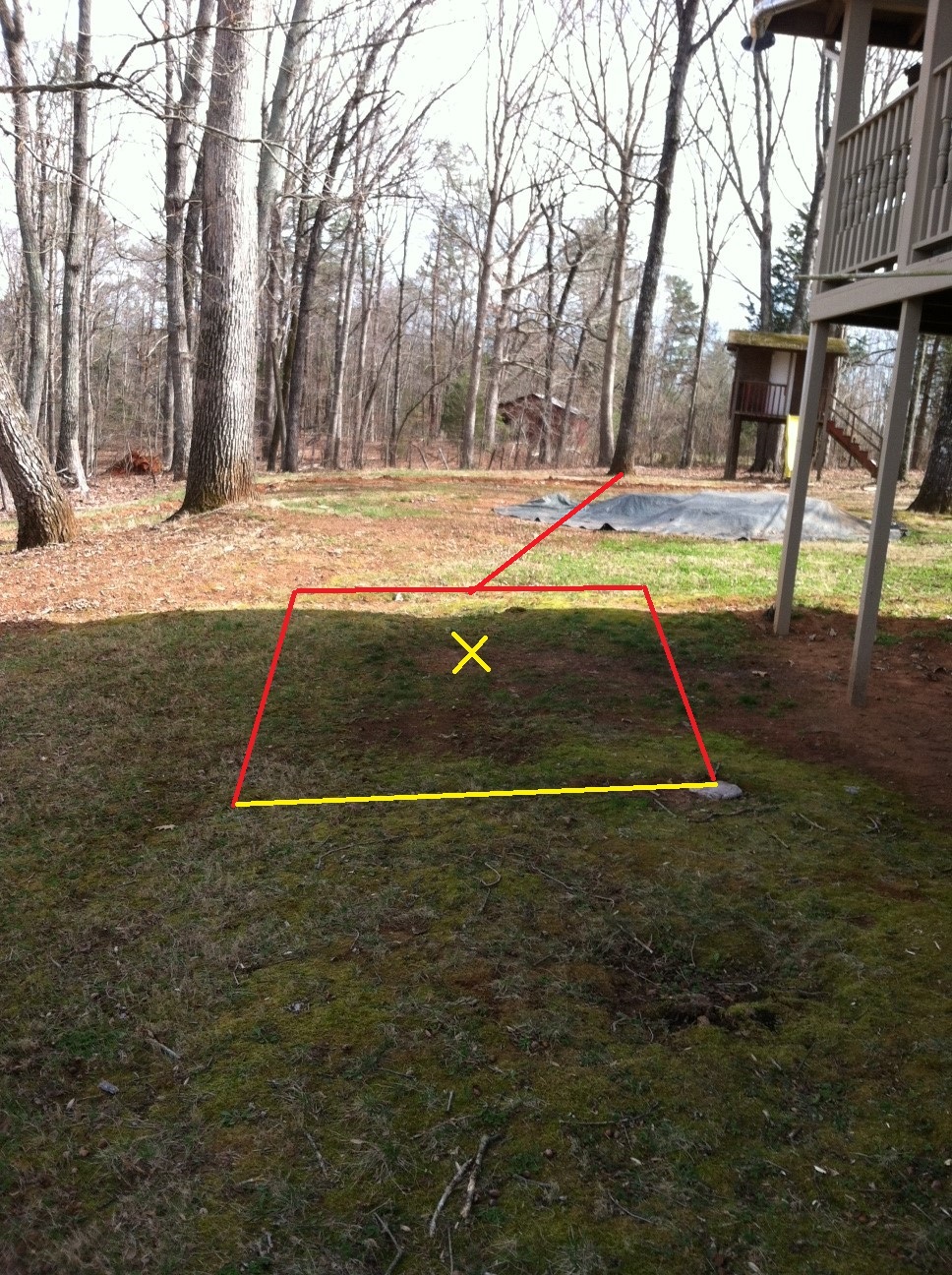

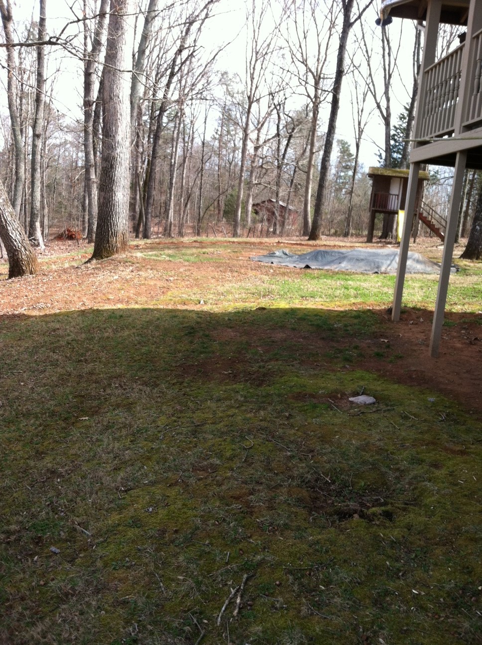

OP here. Two photos of my suspected tank location. In photo1 you can see the basement wall and heat pump. Coming directly perpendicular from that wall and about 4 feet from the corner of the house you see a flat rock in the lawn. That flat rock marks 15 feet which is what the health department sketch says the tank is from the house.
In photo2 you will see the flat rock still, in the right. Now looking parallel to the house you will be looking across the tank and into the drain field. The flat rock marks the right side of the tank so it will be extending into the lawn however wide it is from that rock. The drain field extends straight back in the photo to the tree that appears to be above the tarp on the ground. It's all very flat and probably not more than six inches difference from the rock to the end of the field. Honestly, I can't see much of any kind of witness marks. At the flat rock I poked a probe 18" deep every 12 inches in a 10' square there. The ground is hard clay and I gave up after my arms turned to rubber.
View attachment 417526View attachment 417527
That's interesting. In the second photo, is there a known reason why there is no growth 'away from' the rock marker? Could it be residual clay/soil from the initial hole dug for the tank? I say this because I have a similar patch of soil where little to nothing grows beside my tank (to the left in this photo):
Can't get any kind of grass to grow there. Not real good grass anywhere here due to all the trees but this area has always been more problematic.
There might be a good place to probe. Didn't occur to me that maybe it was installed further into the direction of the leach field. If there was a tree (the old stump this side of the flat rock) in their way they might have moved the location of the tank after the sketch was made??? I'll probe up in that direction and see what happens... stay tuned....
From your description, it would make sense if the tank is here.
Get a probe or post hole digger and dig down at the yellow X at least 4' to be sure.
/ Household Septic System #95
Good eyes Moss. That looks to be a likely spot. Also, toward the forground, from the yellow x, in the bare spot, could be another lid.

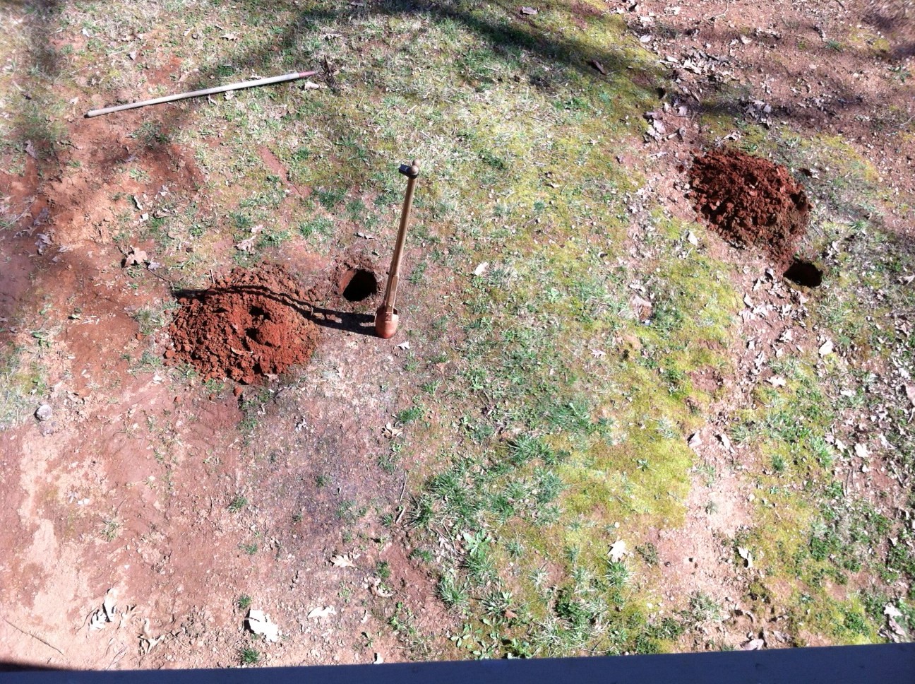

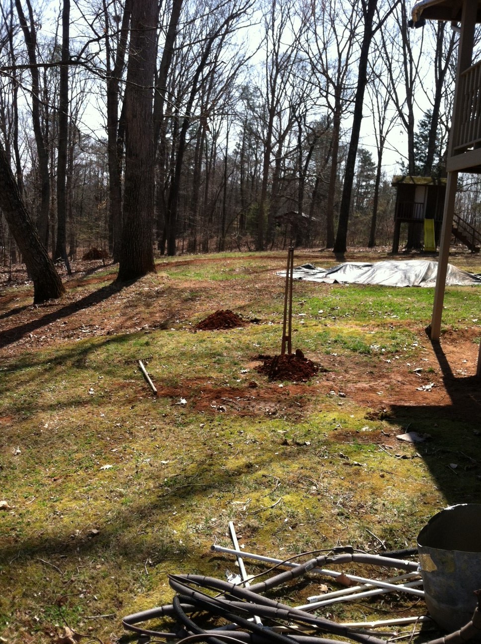

I didn't get to 48" but at 42" in each of these two holes there is just dirt. Not even a hint of a tank or leach field in either hole. :-( The second hole went in the wrong direction. Will dig in the "other" foreground this afternoon. The new junk in the picture is my other priority for three days while the HVAC contractors are here.

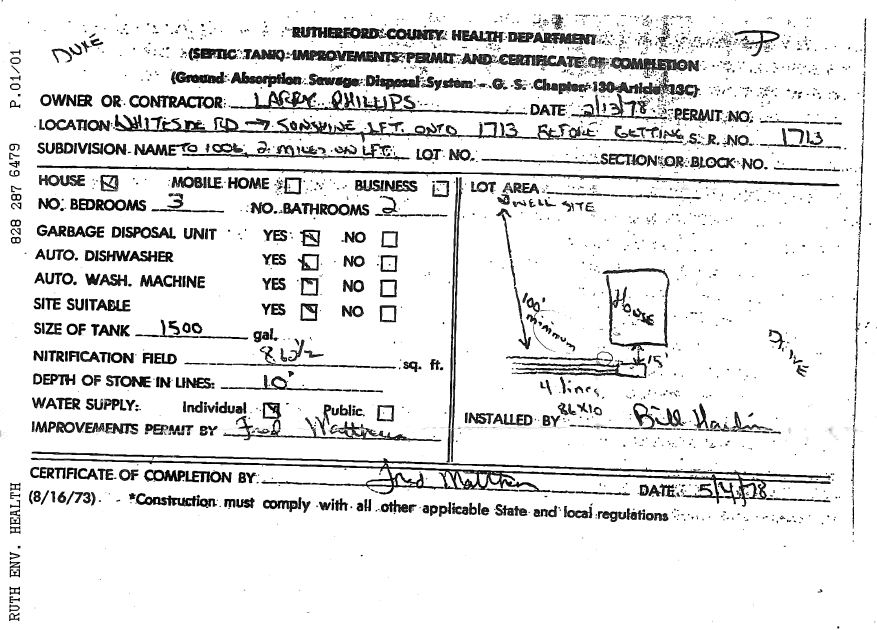

Found the sketch from the health department...

Until the snow gets fairly deep, I can see the outline of my septic tank because the heat melts the snow above it. My tank about 18" deep.
If you never see something like that, your tank may be quite deep or in continual shade maybe? The mossy ground cover looks like shaded ground.
What is the approx. height from grade level outside and the surface of your basement floor? If you add 10-12 inches to that, plus another foot maybe for slope to the tank + tank wall thickness, it might get you close to the tank depth.

My wife's iPad will take thermal images, maybe not real accurate though. I'll give it a try after the sun goes down tonight since there was enough sun on it today that it all was warm and you could only see the shadows as cooler places.
The ground in my pictures is the same height as the basement floor so I am guessing that the tank lid shouldn't be more than a foot or two at the most below the surface.
