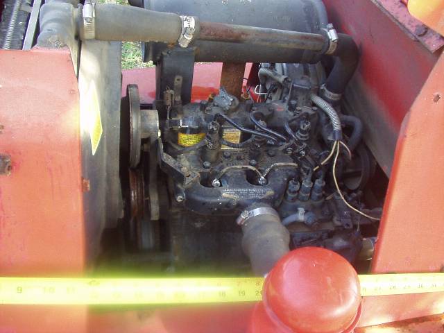

<font color="red"> Do you have any photos or specs of the engine? </font>
Pic 1
Sooner than expected.
Sorry the rule is mostly unreadable, but it gives an idea. If you get far enough to need exact measurements, I'll provide.

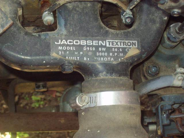

   / How about a diesel PT425? #12
Pic 2

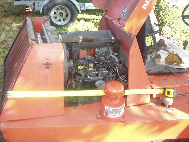

   / How about a diesel PT425? #13
Pic 3

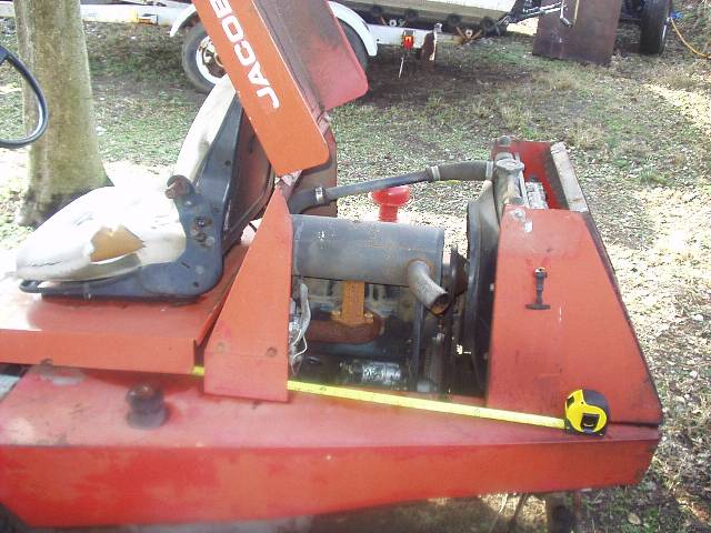

   / How about a diesel PT425? #14
Pic 4

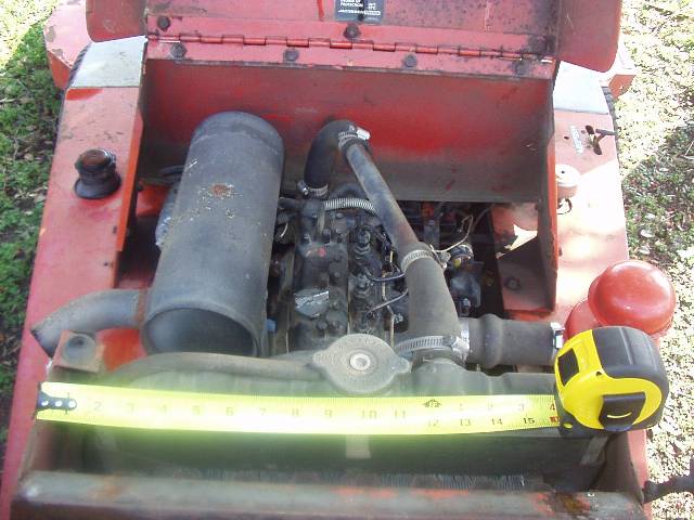

   / How about a diesel PT425? #15
Pic 5

Charlie,
How many HP is the Kubota diesel? Just curious! If it'll drive a 72" finish mower, it should be sufficient, regardless...
Any idea what RPM it runs at? Since the pumps on a 425 are set up for 3600 RPM, that might be an additional complication...

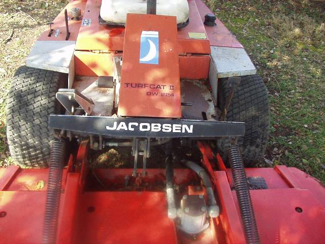

   / How about a diesel PT425? #17
Pic 6

   / How about a diesel PT425? #20
21.5 hp @ 3000
