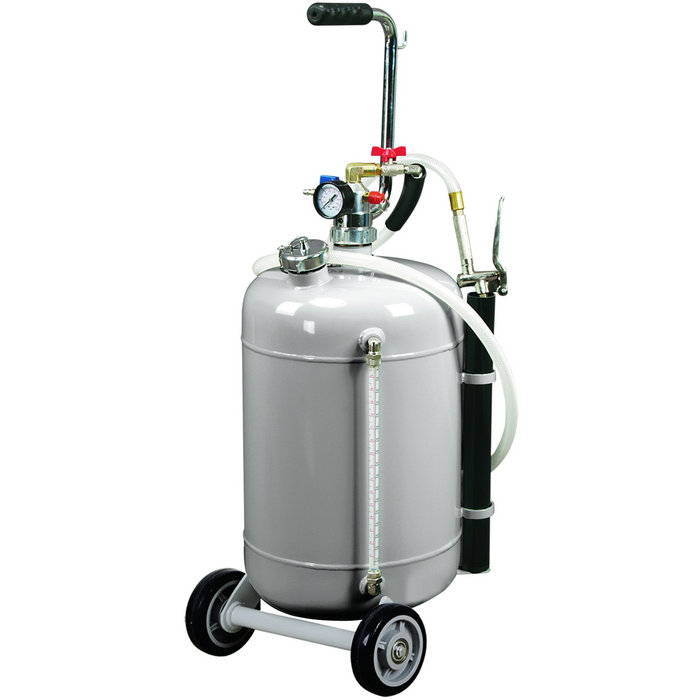

I like this which is a race version of Scooby074's idea, propane tank about right size, just something about welding on propane tank..... leaning towards empty Freon tanks.
Issue is need three so price, ugh. the above is going to eat up floor space, where could put bucket pump under bench, be it tall shelf. Still undecided, going to need to make mind up soon, late spring going to be here soon and I have some equipment if it isn't leaking I am worried.
[snip]
Your pic got me to thinking. For a pressurized dispensing tank, wonder what it would take to adapt one of the HF sandblasting rigs. :scratchchin:110 lb. Pressurized Abrasive Blaster Seems like it would be easy enough, and cheap (around $100 on sale with a coupon).
   / How are you dispensing gear oil? #13
Thats basically what I built, minus the wheels, gauges and fancy valves.
#14
You can buy the Race one in post 12 for $150. I would like to be able to dump a five gal bucket in then forget about it. I have looked at using the 5 gal air tanks, but at 5 gal that is questionable as you need some space for the air. I like the discarded propane tank idea, have to get over the fear of welding on it. Once a guy figures it out he could crank out 3-4 with out issue, which is where I am at. I have something like the above for sucking oil out and it is huge time saver. Also, have the oil drain/sucker and then pressurize to get waste oil out. like that too. Issue is we need an 8 to 10 gal tank in the $20-$30 range. Then can you build it for what they are selling it for?
