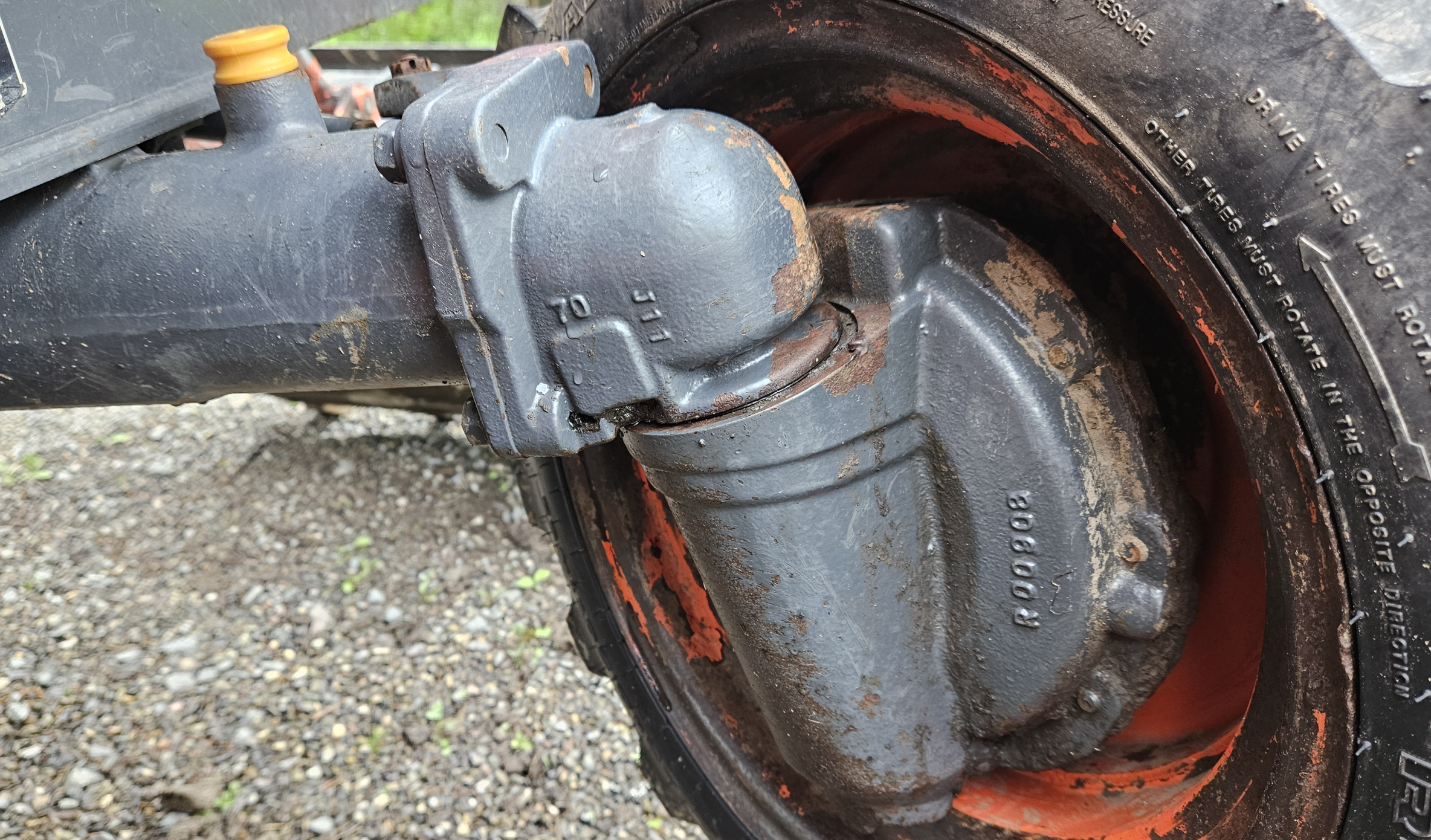

Made it down approx 13 posts; and didn't see it mentioned; and not 100% sure on the B3200; But many machines spec either hydralic or Gear oil in the front axle. Seems to be a pretty common recommendation to swap from Hydro to gear oil. Don't how fast the leak is; but it looks like it could be 1 pint per 100 hours or so; gear oil could slow that down to a few tablespoons per 100 hours.

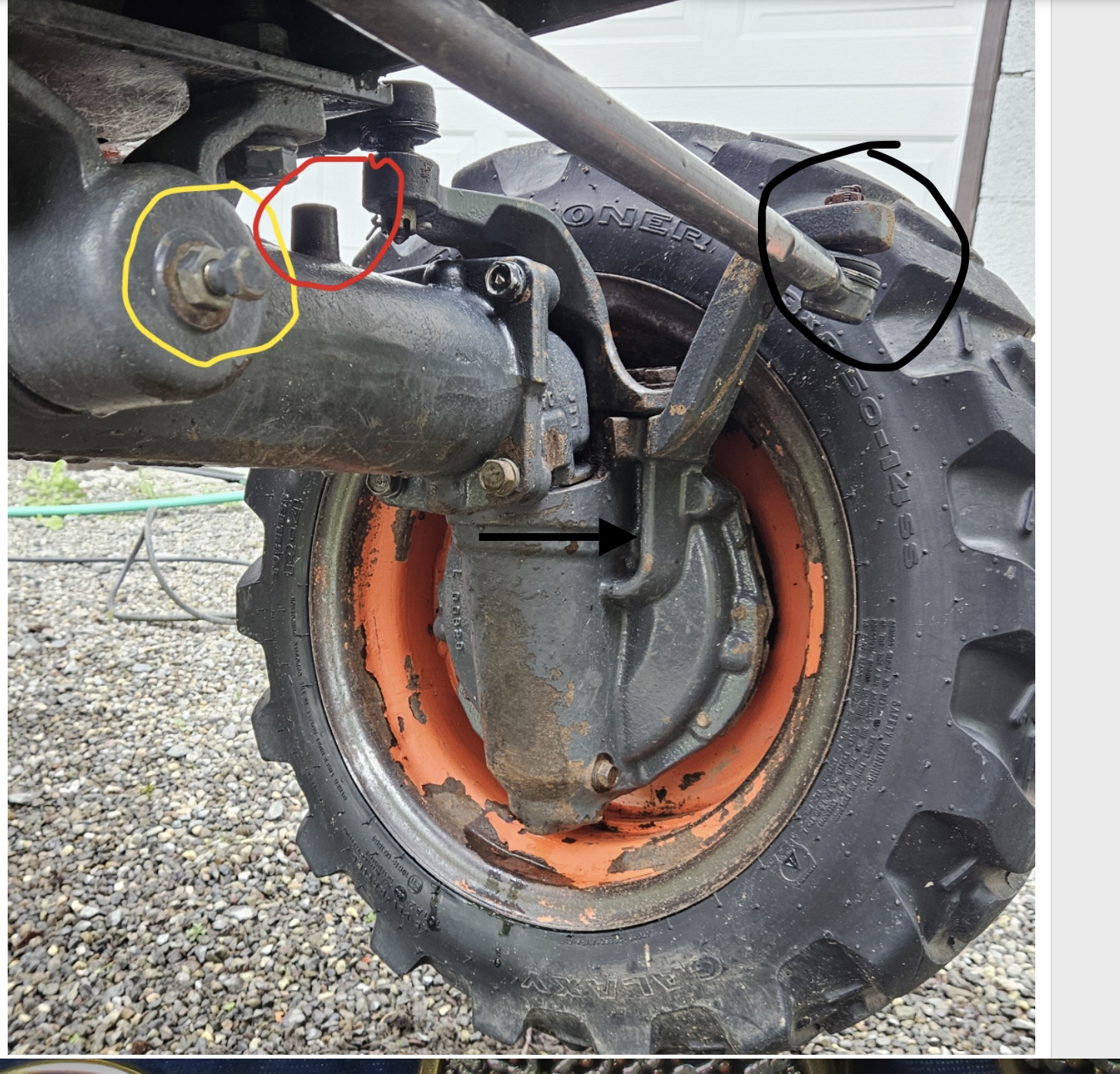

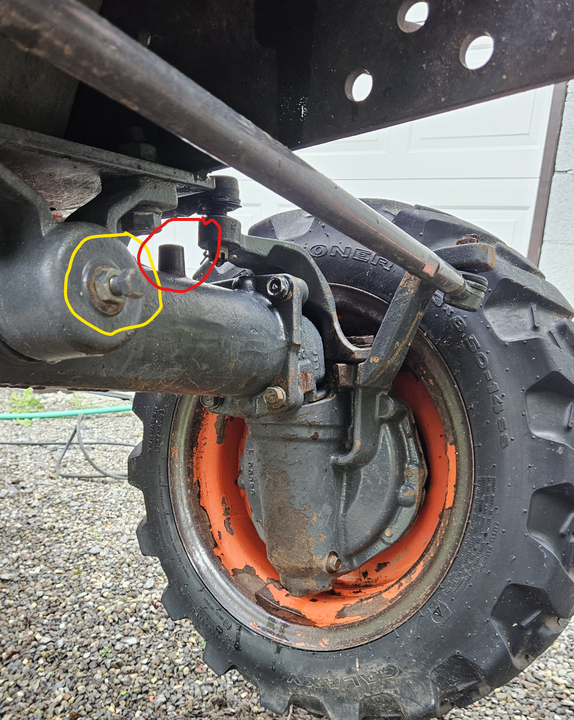

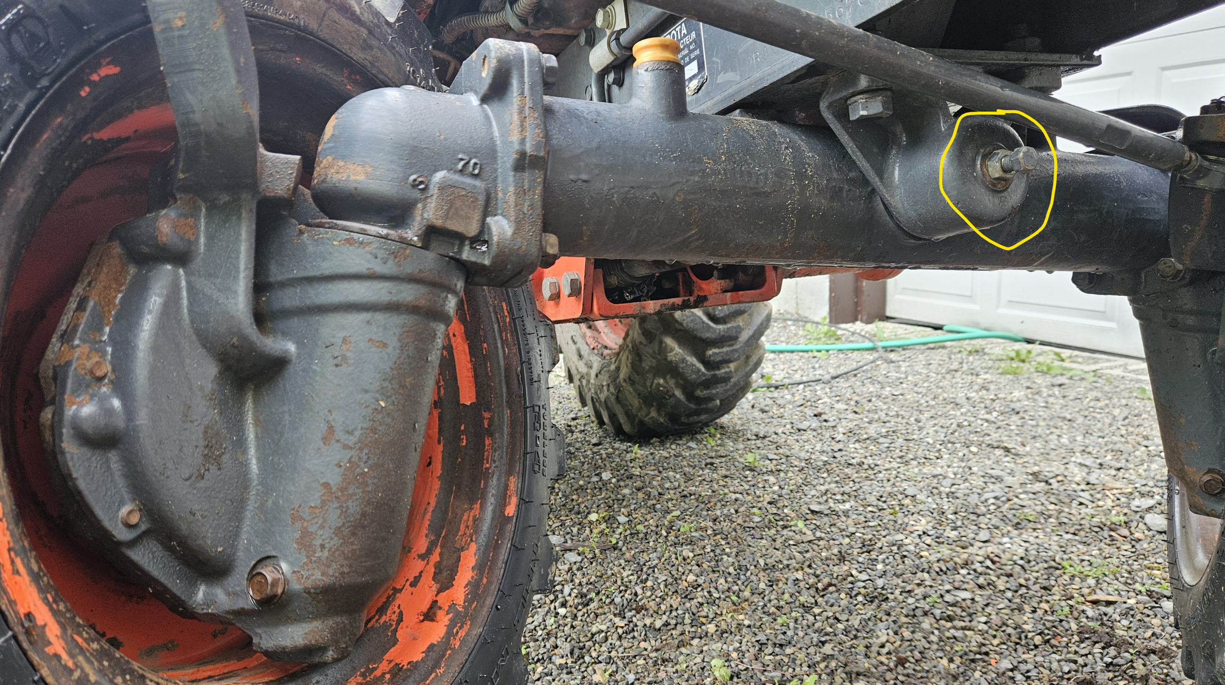

I believe the yellow circle is the adjustment to take up any wear or slop in the front axle pivot.
My Kubota is siimilar.
There should be a grease zerk associated with that pivot somewhere. If not, you can probably figure out how to get some grease in there. Maybe the zerk is on the back of the axle.
If it needs adjustment because the axle pivot seems sloppy, raise the front of the tractor so that both front tires are off the ground, loosen the jam nut a few turns, screw in the bolt until you feel it make light finger contact against something inside, hold the bolt in that position while tightening the jam nut, check that the axle still pivots freely, and you are done.

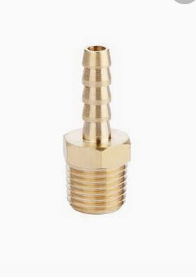

I don't know what the red circle is. Might be a pivot stop? I don't see a vent. If you can't find an obvious vent, go to the hardware store and buy the smallest brass hose barb to male NPT you can find and some clear poly tubing to fit. probably will be 3/16" barb x 1/8" male NPT. Drill an hole in that front axle fill cap, thread in the brass fitting, and run the tubing up somewhere so rain and water - AND MUD! - cannot get in.

The red circle is a vent I believe.

BTW, see that rubber boot there on the steering rod where I've drawn a black circle?
Some owners lubricate that ball joint using a "grease needle". A hypodermic and 90 weight gear lube - or just about any oil - works too.
Do both ends.
