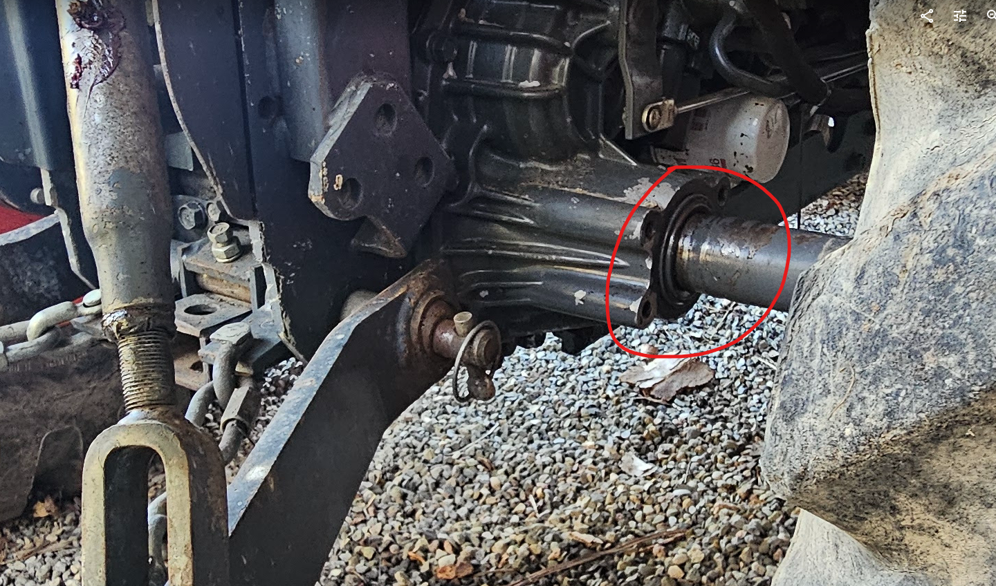

I can't tell from the photos, and not knowing the B series line much at all, I don't know how long it should take to get that axle housing off, replace the $30 seal and put it all back. An $800 (plus fluid) quote indicates to me the shop is guessing at seven to eight hours involved. Without looking at it from all sides I can't say it should take that long.

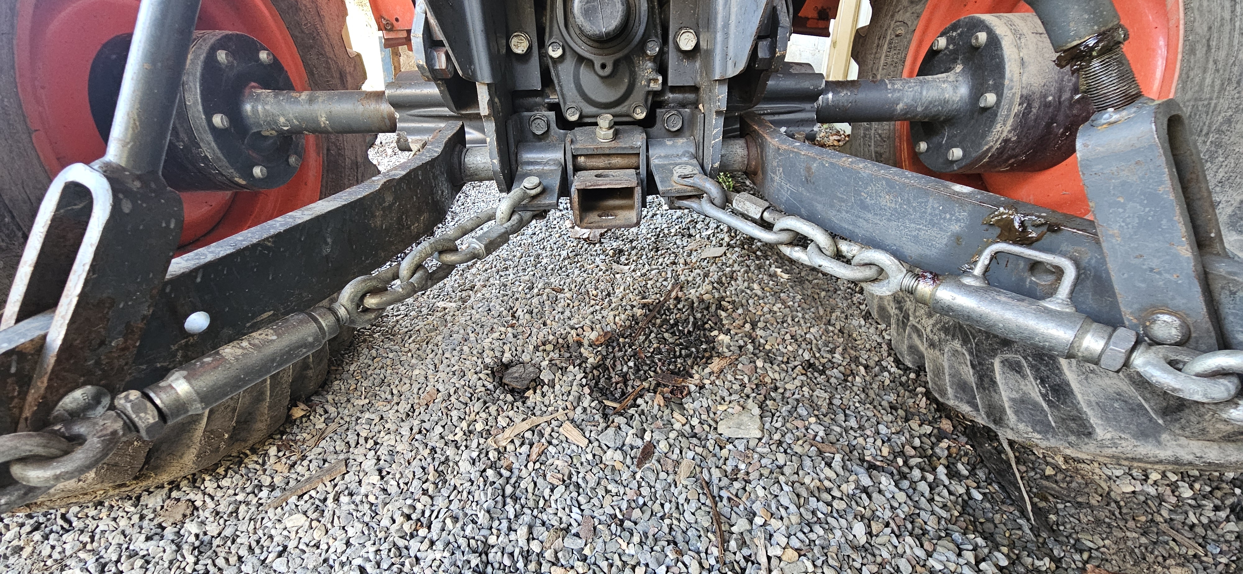

Spray everything down with degreaser then add some UV dye to see where the leak is…….. This can pin point the source of the leak with a UV light.
Fluid leaks on the ground are hard to see where they are coming from so that is why I suggest using UV dye.

Just to confirm, you think this could be leaking, correct:
And would a leak from this area run down to the center of the tractor and fall on the ground? I am trying to confirm this could be happening here.
If that is a slow leak, it could seep down and it would cling to the frame and drip off the part pointing down just to the left of your axle seal in the picture (near where your oil leak shows on the ground)

Like others said, clean and let sit for 1/2 hour then examine the area. Use a light if needed. If you don’t see anything then drive it a bit. Check again. If you use it too much it may spread and make the source difficult to find.

If so, why would the leak be in the center of the tractor and not right below the rear seals?
Well, gravity, maybe. but that would likely result in a trail from a 'high point' to a lower one.

Why high to low? The oil is sitting in the lowest place when it’s not operating. If want to trust the dealer diagnosis just ask for a written qoute.

I have the same tractor w/the same leak that I had fixed. I think the deal leaked & ran down the bottom of the axle housing to the lowest point and then dropped. Anyway, in order to replace it the axle housing needs to be removed because the seal is on the inside of the housing cover. In my case I recently had a hydraulic oil change so my guy recycled the oil.
