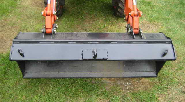

Highbeam, you are correct about the grinder and the middle hook. It may have taken more than a couple of minutes though as I had it mounted on a supporting plate. 5 minutes minimum. But, that was just an excuse. I've always lusted after a real grapple just like CT Tree Guy has. /forums/images/graemlins/grin.gif/forums/images/graemlins/cool.gif

<font color="blue"> You say this thing is light duty but if it is made for SS loaders then I would think it is pretty stout. </font>
We'll see. It was fairly advertized as a "light duty root grapple" which was pretty much exactly what I was looking for. It weighs only half of what some of the other grapples weigh so it must have less steel somewhere. I wasn't too concerned because I'm not using it to clean up after Katrina or dig rocks out of my yard or move 30 inch trees around. It will really be a brush grapple. If it seems strong enough I'll use it to bust up roots and push over small trees too but I'll be happy if it just makes the brush/toppings clean up easier.

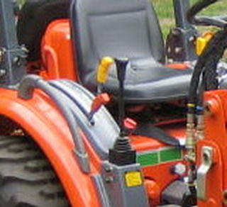

#16
Yes, that clarifies it. I was confused by the yellow valve thing and thought you were referring to something accessed near the 3PT itself. I see now you were referring to the position control lever which controls the 3PT.
I do nothing under the fender when attaching my BH. I have to move the lever (Yellow!!) inboard of the position control lever on the right fender. It has position A forward, off in the middle and position B rearward. I've only used the A and off positions but my dealer informed me that if I accidently put it in the B position that the BH controls would work but be reversed. That sounds to me like the double acting valve. I've always referred to it as the power beyond valve but I guess that is not technically correct. Thanks for the info.

#18
I'm going to give it a try. Looking at the valve and FEL control arrangement, I might be able to operate the FEL with my left hand (coming across my body) while controling the grapple with my right hand on the "yellow whatever it's called valve". If I can get reasonably good at it I'll save a day's work and the $500 for the diverter. /forums/images/graemlins/cool.gif
