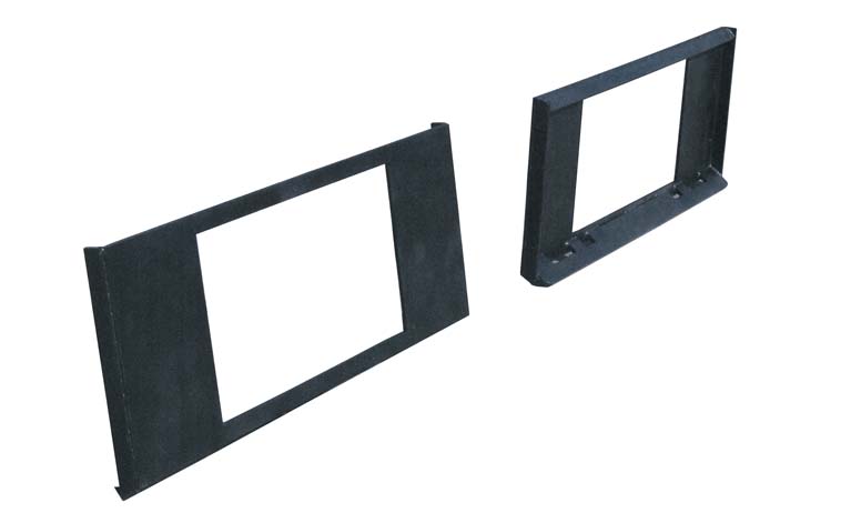

The cost of the adapter plate is $300, not $100. Still, that is about half the cost of some of the others I've seen as you pointed out. I asked the manufacturer for an idea of what they would do to make it. It is not a nifty ATI Tachall type device but rather a standard adapter plate originally intended to be welded onto an implement to make it QA compatable. They will modify that plate by welding on the appropriate ears so it will accept the KL120 pin mount on one side and the grapple QA on the other. I know they are going to get a Kioti bucket to match up but I cannot say that I know exactly what it will look like. They sent me the attached photo to show the piece they will start with. It is not the tube steel type structure ATI uses so that explains the difference in cost. I don't know what the pros and cons are compared to the TachAll style but this will be the fastest way to get me up and running.
