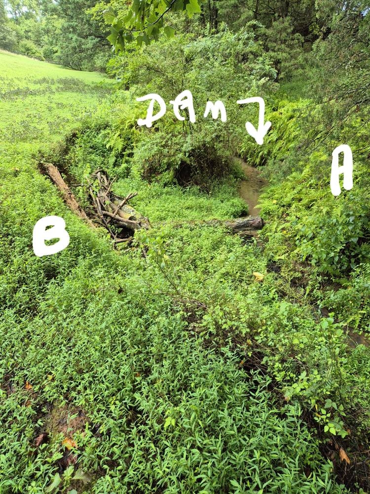

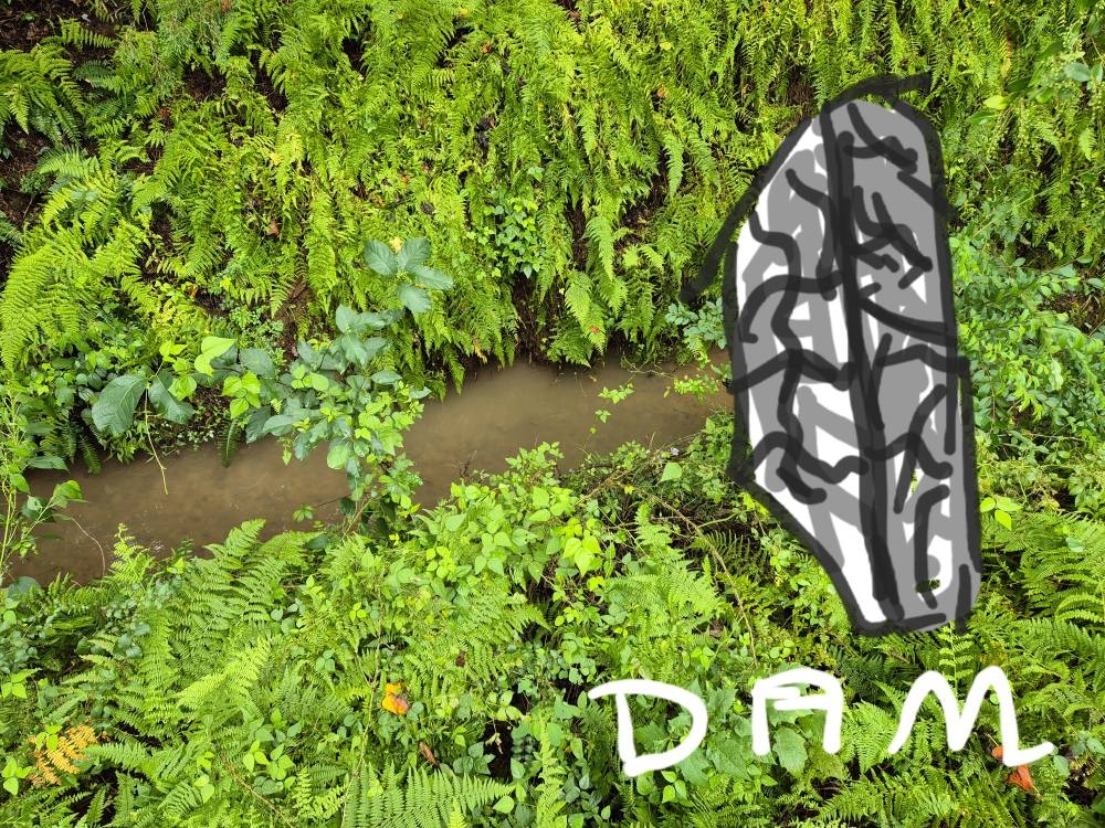

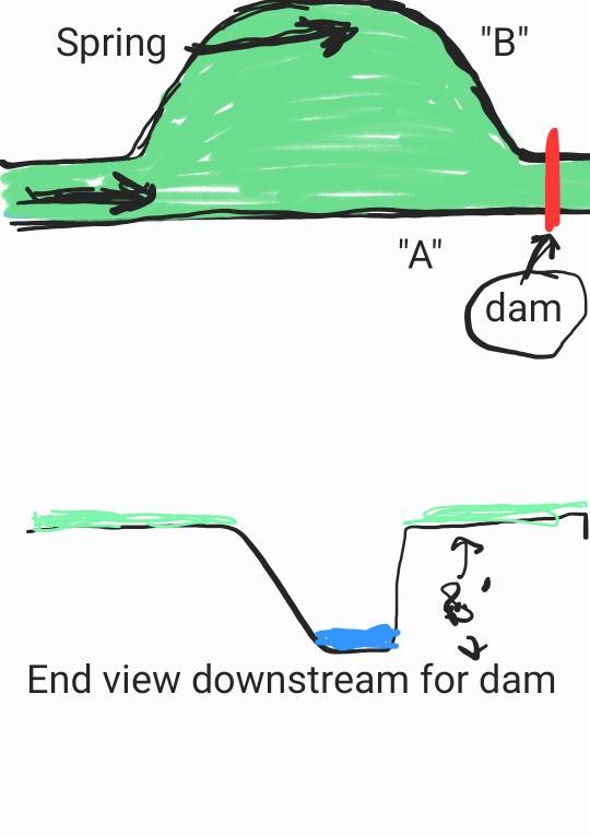

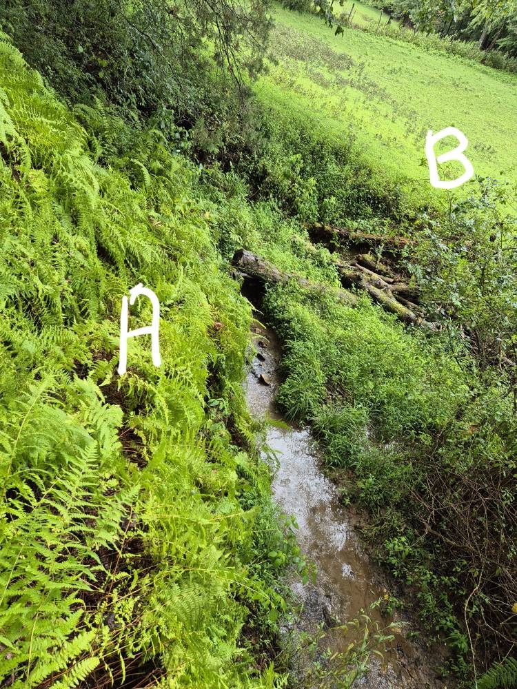

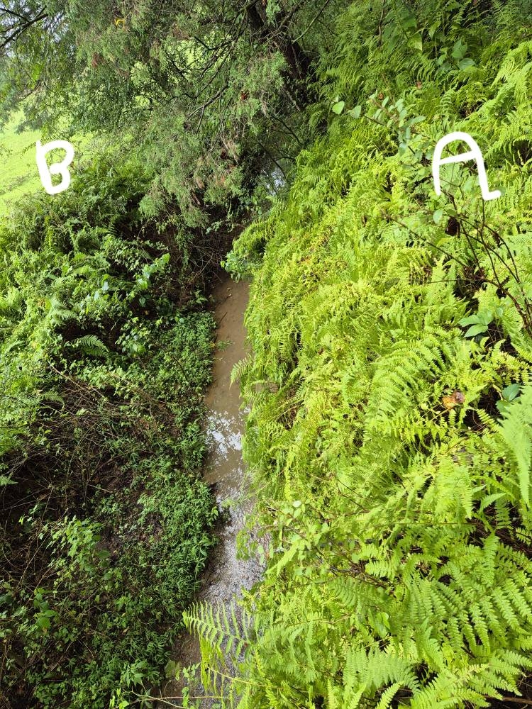

On our place is a nice long spring fed creek that flows even during a drought and there are three springs along it here. One is eroding the pasture making a bowl shaped area. Creek is about 8-9 ft. down below ground level, bowl area is about 40 ft. across. I was showing it to a neighbor a few days ago who said why not dam it below bowl and what a great swimming hole. The creek bed is rock. Downstream aways I put in a 5ft culvert, compacted dirt then gravel for a drive across, below that aways is a ford, railroad ballast either side.
First I'd have to winch out some trees I tossed over into it (easy job), then I'm trying to figure out how to dam it. I can easily get my 4x4 truck to it, but not a tandem dump truck.
Any ideas best way to dam it are appreciated.
Writing this I'm thinking I do have pvc pipe sections maybe in first for water flow, install dam then cap pipes? If I just dump in a lot of rip-rap it wouldn't be water tight.
Thanks.View attachment 882673View attachment 882674View attachment 882675View attachment 882676View attachment 882677
If this was my land, I think that I would use concrete sacks to build the dam. I would stack them on top of each other and run rebar through the sacks to hold them all together. This is very common for building retaining walls. Since running water is the biggest issue, I would slope both sides of the dam with concrete sacks too. If every sack overlaps another sack, I think it will plug itself up with silt over time, as the sacks cure. I wouldn't care if it leaked a little. That might even be good to keep the water flowing in the creek, and clean out silt from building up over time. The main thing is that water needs to be able to run over it during heavy rains.

You will need a permit from the US Army Corps of Engineers and possibly also your county. Your overflow will depend on maximum storm flow rate, but from the looks you will need at least a 4' diameter pipe or reinforce the top of the dam with concrete.

Any downstream "users" of this water? Flow would only be interrupted until the "swimming hole" is filled in. Once it is, downstream flow will resume, assuming the incoming flow overcomes the pond leakage. Prepare your overflow spillway well. If there are no downstream complaints, odds are you'd be okay.
There is a saying that comes to mind: "It's easier to ask for forgiveness, than permission".
