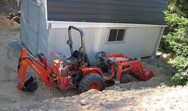

Hi. Need to know the total length of a B7610 TLB before I buy so that I can design a shed to house it. Does anyone use one of those prefab metal carports? Pardon the barrage of questions lately.

My shop is 20x24. I wish it was 32x48. However my shop is also my wood shop, storage area and houses my B7500 and a JD riding mower with a trailer. I have to pull the tractors out to get into the shop. If I am reading your question correctly, I think you are asking about minimum square feet and in what configuration. My advice for a tractor shed would be to go for length instead of width. For example. My shop is 480 square feet. In the 20x24 configuration, it is not very effective for tractor and BH storage. It would be much better if it were 16x30, or even 12x40. This way you could pull your tractor in completely and drop the backhoe inside the shed. The other thing to remember is VERY high door heights. I have read about "other people" /forums/images/graemlins/blush.gif having problems with door height and ROPS........

I have a L5030 with FEL and BH, and 6"tooth bar. I swing the BH to the side (cuts about 3' off total length) to close the door in the 20'X20' shed. I have to step in the bucket to get in front so an extra 2' would be nice. Make sure you get the door height right. I had to re-cut the door's height to get the BH in.

A Kubota B7610 TLB is almost exactly 16' long--front of loader bucket to rear of BH bucket pin. It is 4' 10" wide across the flipped over Backhoe out riggers.
I have a 10' x 20' prefab shed that may eventually be modified with a bigger door to accomodate the tractor when I eventually need the space in the new shop. See attached pix of tractor alongside the shed. The Backhoe is not folded up as tight as possible in this pix. Also the outrigger pads are in their normal position, flipped over the width decreases almost 6".

I forgot to say, the width across the BH outriggers is with the outriggers up. I don't have the measurement across the outriggers at their widest, which you'd need if taking the BH off in a shed.
Also, you need space to store other attachments/implements and the space to back up/ drive up to them. In my case I keep the backhoe on all the time. I'll take the BH off out in the open when I hook up the box scraper and switch back when done with the box. Always have a counter weight on the back of the tractor when using the loader, I use the backhoe. But, I don't mow with the tractor either.
