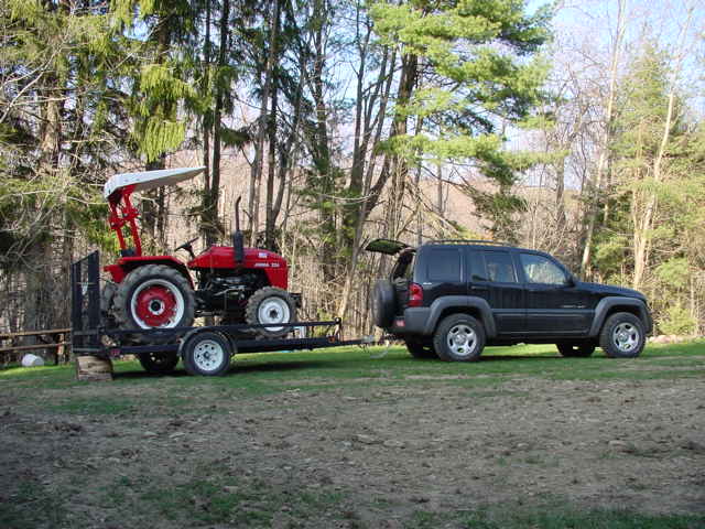

Here's a pic when I was young and foolish with my first tractor trying to haul almost 4000 pounds on a 3500 trailer w/ single axle. When I went down the first big hill I WAS IN 1ST GEAR trying to get some braking action. I figured after my brakes were smoking my life and other peoples lives were more important than a few extra dollars. I since got a bigger tractor and a Tandem with Dual axles and Brakes on both. Sure makes for nice hauling. Don't skimp on the safety margin and also like others have said.... Make sure its big Enough so you don't have to go and buy another..

Before you purchase any trailer, first check the vehicles ability to handle such a trailer. No sense in purchasing a larger tailer that when it is combined with the weight of the tractor, your vehicle doesn't have the towing capacity to handle. If you get into an accident, even if the trailer is capable of handling the load, and the vehicle isn't, you will be cited and held responsible. Also, any mechanical damage that you might do to your tow vehicle by using a trailer that is too heavy for the tow vehicle will not be covered by the vehicle manufacturers warranty. Whenever a vehicle has a mechanical failure and that vehicle also has a tow hitch installed, it isn't hard for them to deny the claim saying that it was abuse. When towing, every aspect of the tow vehicle and the trailer needs to be considered if you want to be safe. Dusty
