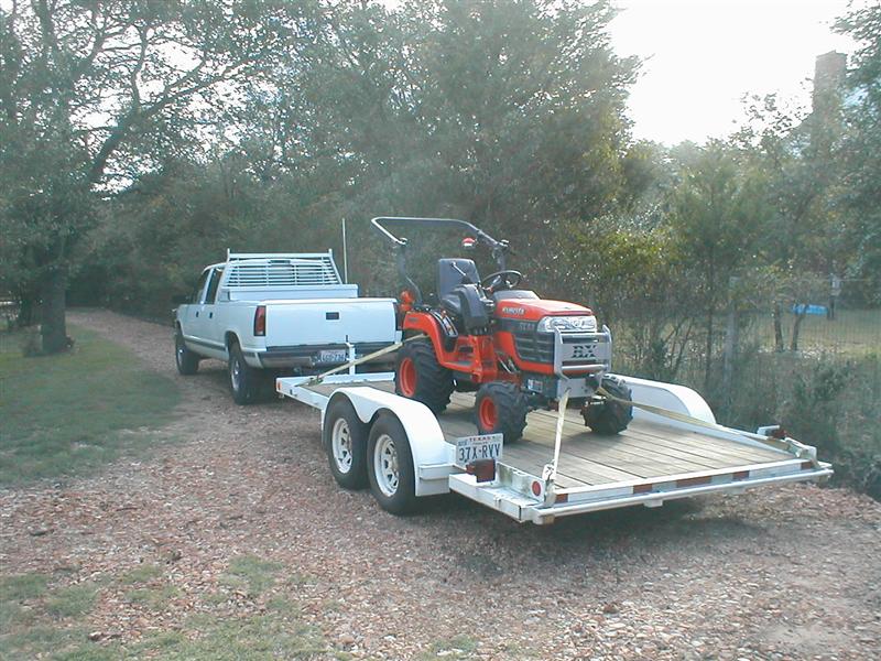

I can't imagine hauling on a single axle. Attached photo shows my trailer. Tandem axles with electric brakes on both. Deck is 18' x 7' and it will hardly fit my BX with implements, although I have carried Suburbans and pickups on it with no problems. Truck tow rating is 8000# with frame hitch.
Hauling any tractor on a single axle sounds sketchy, and hauling w/o brakes sounds positively suicidal. Any moisture on the road and you'll jackknife EASY. :eek:
Oil bath axles would be very cool. Barring that, just pack the hubs yourself, as most trailer "mechanics" tend to be real slobs, at least around here.
Russell in Texas
