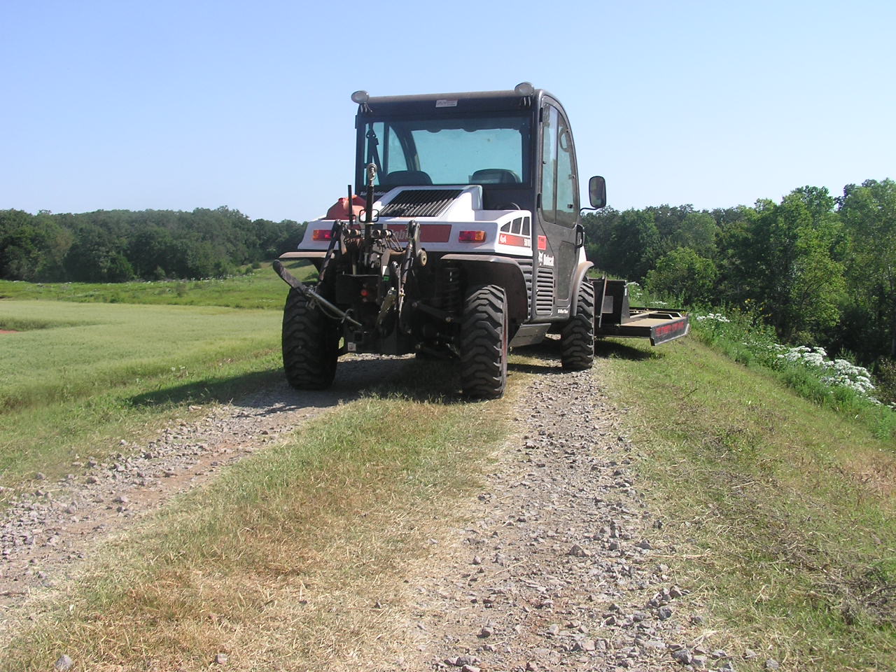

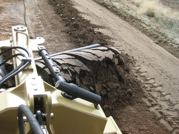

Xfaxman, I think when most people think of angling, we are thinking of angling a rear blade as seen in the picture, and to the best of my knowledge, you will not be doing that with anything that you have shown so far. You are talking about tilting the box and tilting side to side, nothing any different than a 3pt hitch can do other than more extreme.

He's talking about angling his axles rather actually angling the box blade. Box blade stays the same orientation to the tractor, but the tractor is now driving at an angle... He's cheating.
   / how big of a box blade should I get? #23

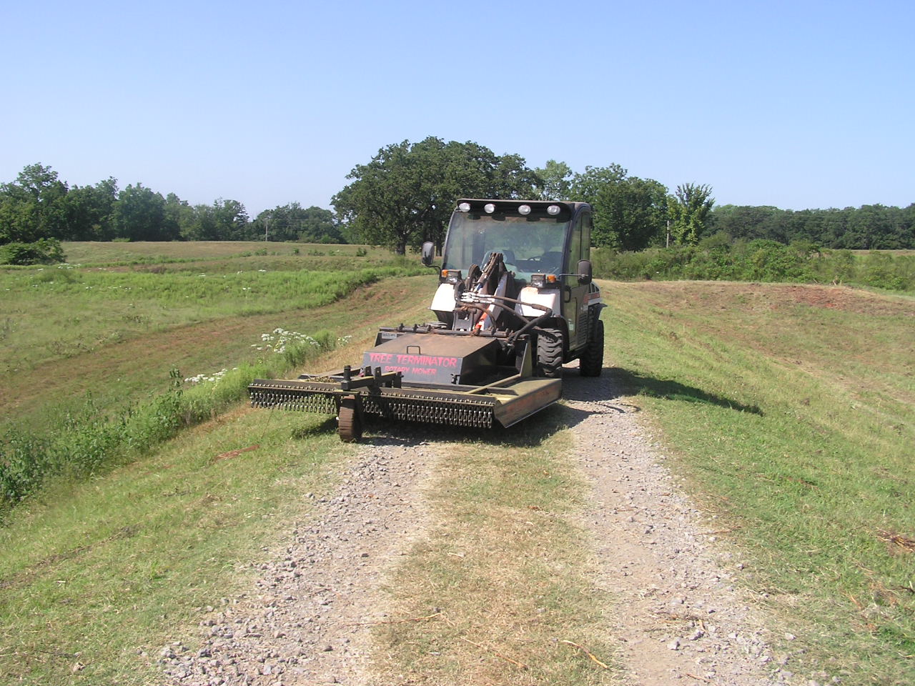

Yes I know a box blade can't be angled on a tractor 3pt hitch.
I guess you have never operated a machine with crab steer. Look again at the picture. the box blade is moving straight, but at an angle to the ground.
Right! :D
I also use crab steer offset with the 7' brush hog to get close to the tree line and keep the cab away from the tree limbs.
Note that when I drive forward the front tires will stay in the gravel, while the cutter is offset to the right.

Actually I have driven crab steer machines, just not in an Ag usage. Now try to get that angle over to 30* or more when you have limited width.
You obviously make good use of your machine, they are not for everyone or all situations, as no machine is. ;)
